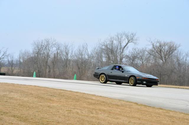

If it helps Im on the tein super streets and they are 16k front and 9k rear. and I have st sways and some other stuff. I feel like its a lil soft in the turns some times. Iv been taking weight out tho. It was 3520 with me in a full of fuel.

You've helped me make my decision not to go with 16kg/mm, rather 18kg/mm and 12kg/mm (front/rear).

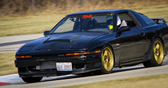

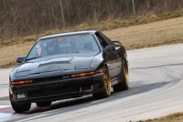

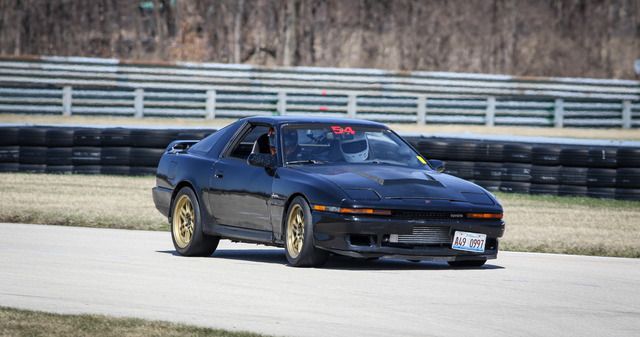

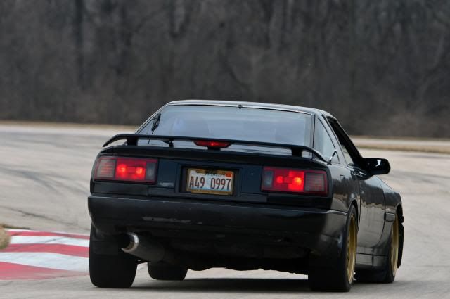

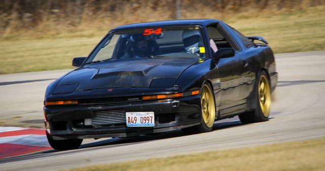

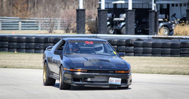

1-2clutch-u;2047269 said:
lotta pics n vid too.
This is on Ebacih springs and tok hp blues and st sways
This is with tein super streets with st sways and battle ver arms.
