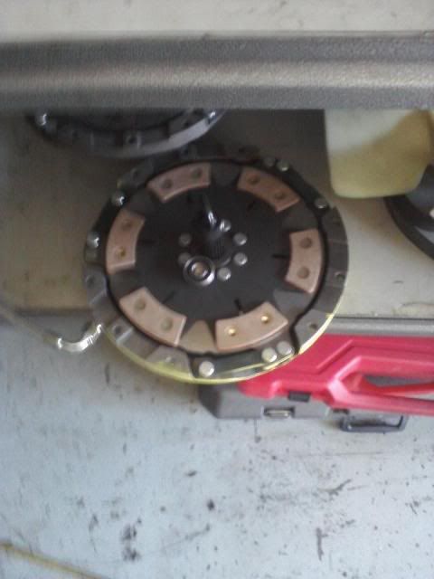

Got a eclutchmaster stage 4 clutch..

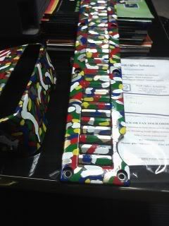

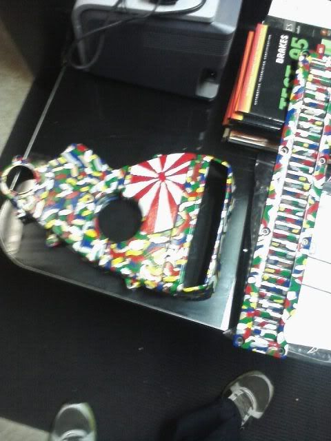

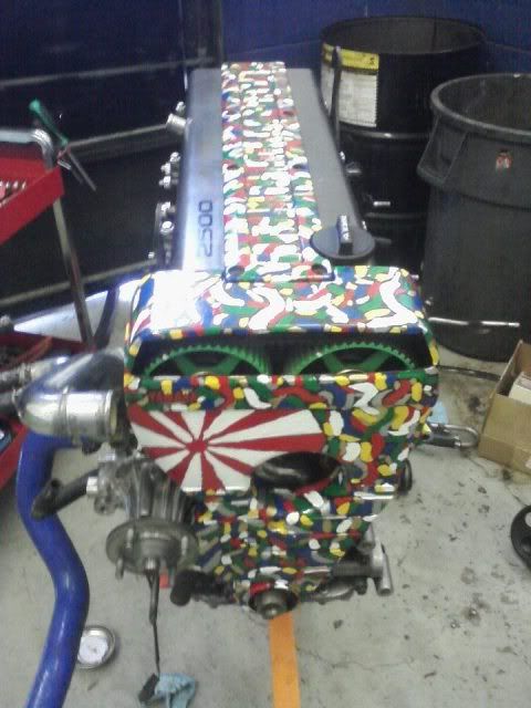

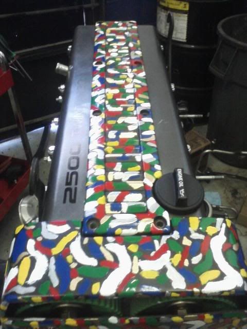

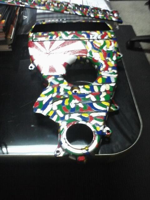

Did some customization to my timing and plug covers.. japan rising sun with some color flavor..
Notice the green timing gears..

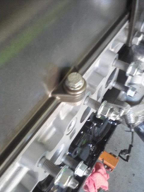

Second that on the hex bolts :) best Idea yet! I even put a small bead of silicone on the bottom of the gasket and tightened it down, not a single leak now
IBoughtASupra
Mar 10, 2009
4,455
Queens, NY
Just be careful, I have seen people crack on them and break off the ear.
What works best is to actually pull them hand tight, say about 15ft/lbs, and then after you have then heat cycled a few times, then go back and tighten them down some more.
I tighten those things down pretty tight and thought it was good and I checked then after about 200 miles, the darn thing was loose, not bad enough to leak though.

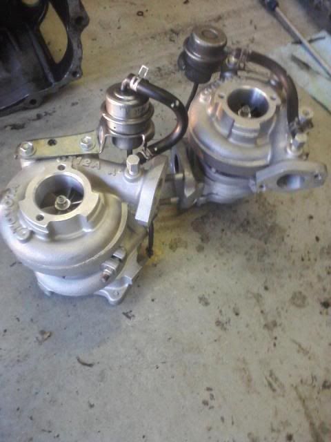

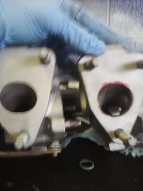

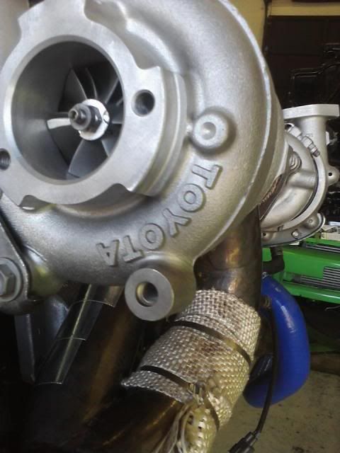

The twins all back from albert and lookin beautiful!
7mm enlargement on turbine housing to match ported exhuast manifold!

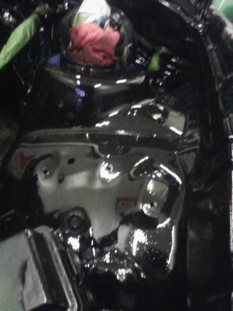

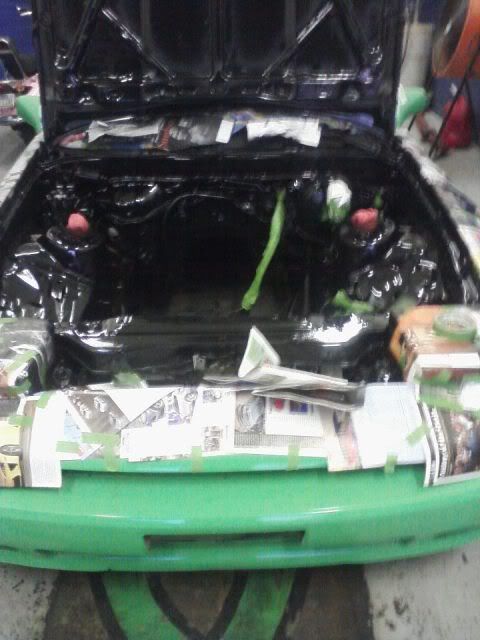

Re rattle canned the engine bay so you don't see any of the red coming thru.. Will get sprayed with a real gun after stitch welding down the road..
Me chillin in my supra bay..

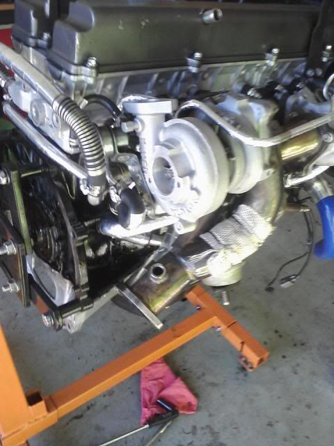

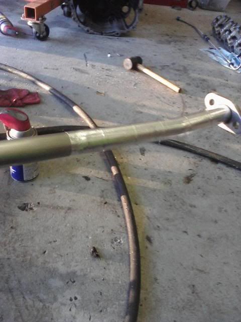

Used aeronautical grade heat reflective tape on all oil and coolant lines on the turbo side of engine.. Reflects up to 1500 degrees direct contact..
Finished up the turbo oil and coolant lines..
Got low pressure stainless steel braided vacuum lines and fuel return line...
