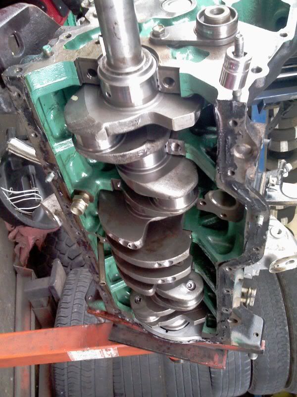

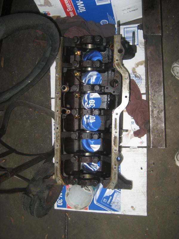

Slow update: After pulling it apart, I was pleased and displeased.
The good: I found some nice Cunningham rods and JE pistons inside.
The bad: The JE's were 0.060 over! too much for me.
I've ordered a set of 0.020 over Probe pistons, and the block and head are at the machine shop. The block was decked 0.003 and the head 0.001. I will be pulling the crank out tomorrow and sending it down to be polished and knife edged as well as ordering my ARP head studs, misc. new toyota gaskets, bearings, seals, etc.

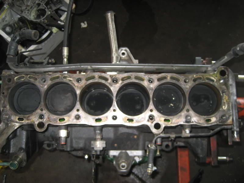

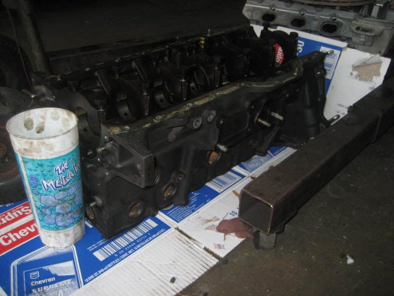

The big fucking heart-breaker:
Broken block:
New block (thanks Matt):

Kinda confused...
You got .020 over pistons, but the old pistons where .060, you can't go smaller, only larger...
Looks like it might be thermal coating on the inside of the block as well.

Poodles;1052901 said:
Kinda confused...
I got a new block, and I have the 0.060 JE's I would reuse but I don't want 0.060 over, so I ordered a set of Probe 0.020 over.
As for the coating inside, where do I get that kind of thing done, and is it expensive?
