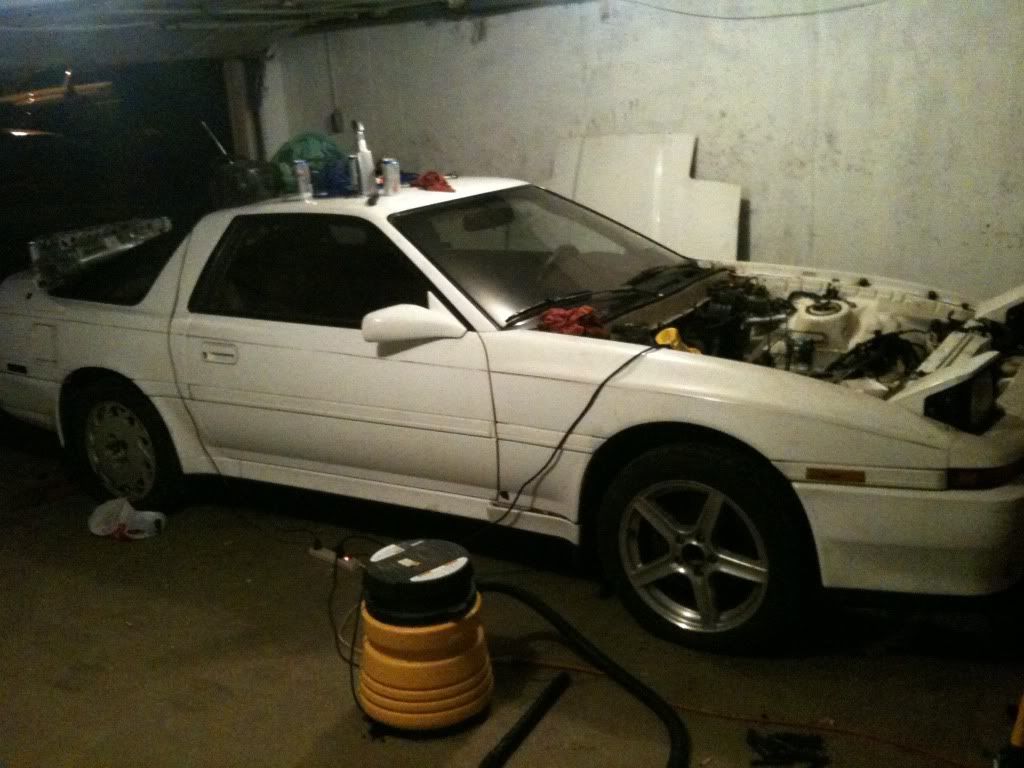

I orederd a cxracing 3" dp and test cat, turboxs boost controller, blitz bov(not installed) since I work most of the time, all my work is done late at night in my appartments parking lot so pics are scarce. her are some more up to date pics. lots of TLC to get her to this point.
can you tell I dont have a garage lol
Right now I have a major boost leak causing the car to hit fuel cut at like 2200 rpm its crazy. so as soon as i can scrounge up the money Im buying a cxracing intercooler kit, and upgrading all the engine bay bolts to stainless allen heads. I will post some up to date engine pics soon.

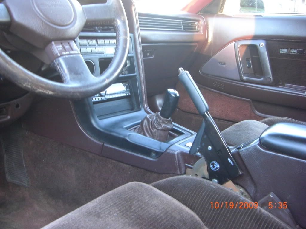

anyways today I finished building my short throw shifter, Im going to install and post pics this evening. Hopefully I can trouble shoot why im getting no spark too.

Ok so the spark issue was finger lickin puppy kickin easy. lol when I was replacing all my bolts with allen heads, a wire in my ignitor plug backed out. Duh no spark....
my diy short shifter turned out just right, I had so much fun I made an extra from my parts car.

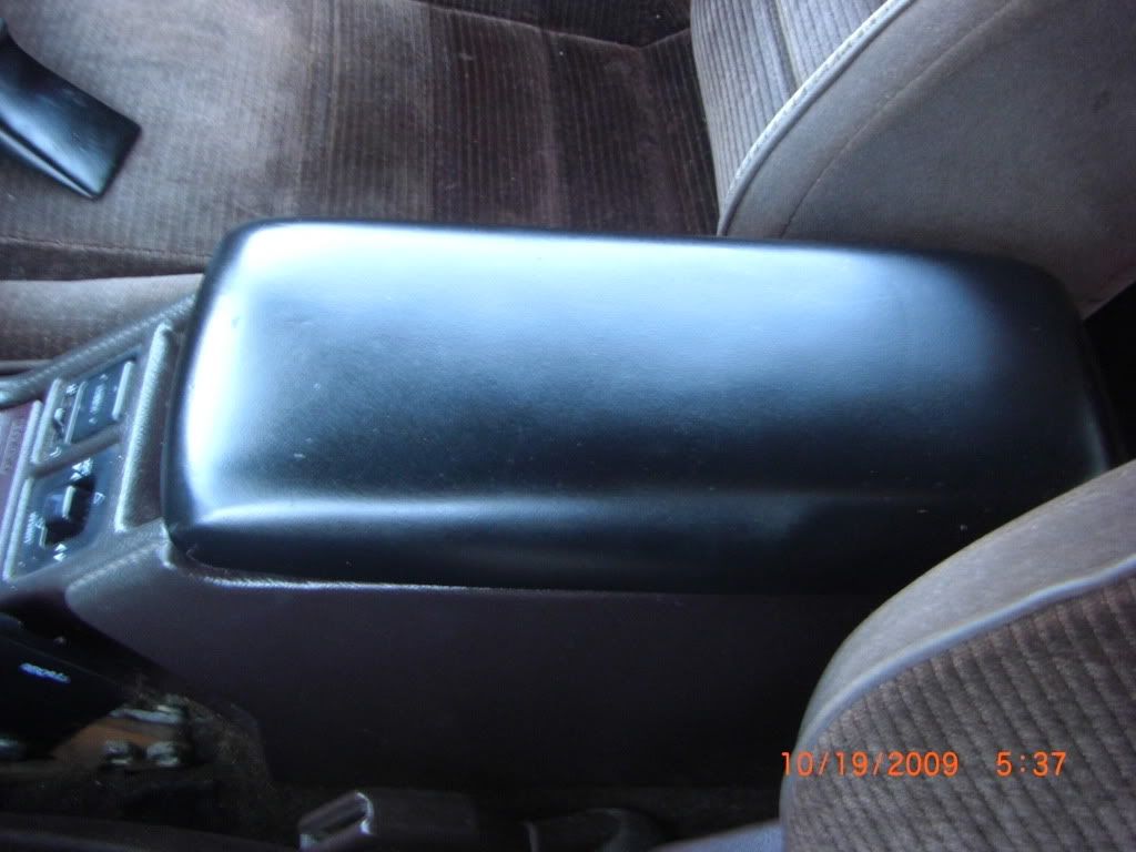

Like all other center console lids mine was trashed, so I made one from fiberglass

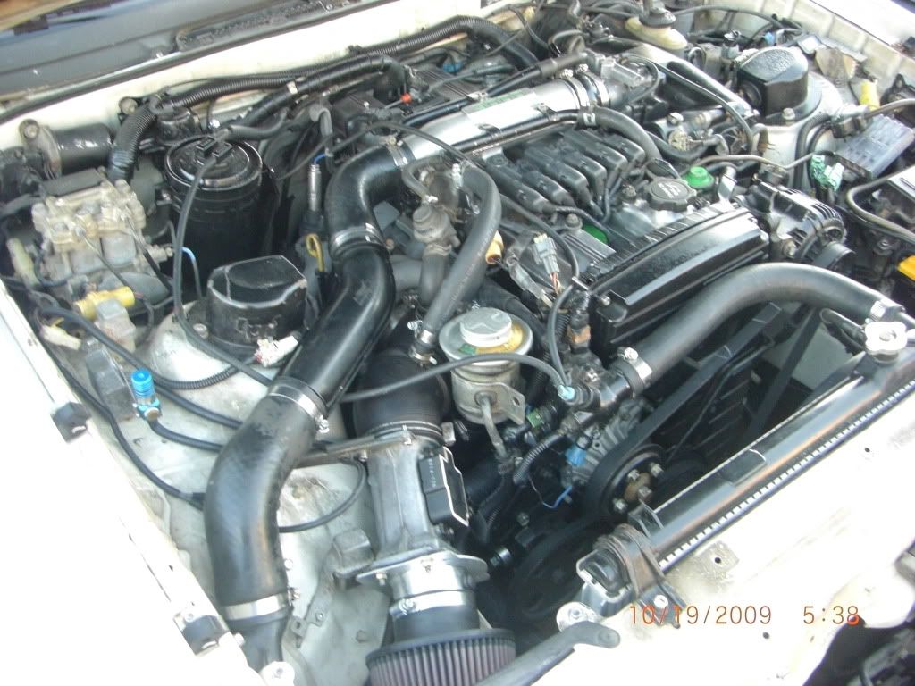

heres an up to date engine shot, it still looks like a dirty cluster f*#k imo but Im workin on it, intercooler kits next.
I thought I fixed my valve cover leak but sadly I was wrong, Im going to buy new gaskets and clean out my spark plug vally. its got some oil in it again! And for some reason my power steering pump wines even though the resivour is full(only when turning)

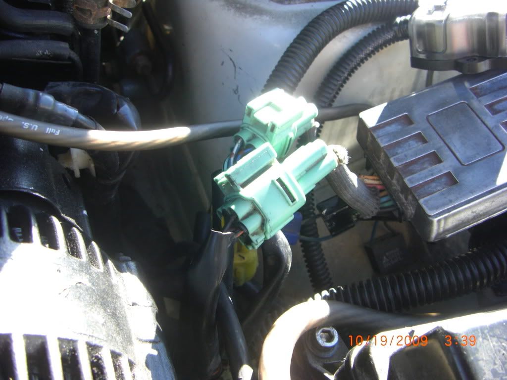

today I was testing the tps,and checking the vta wire for continuity, buttoned everything up and boom problem solved no more stalling, took a easy trip around the complex, ran like a dream( didnt really push it).
opened the hood and was checking some things, my tps was unplugged!!!!
I guess it was a bad TPS sensor the whole time. As soon as I get some extra money Ill buy a new one and this should fix my biggest issue...
