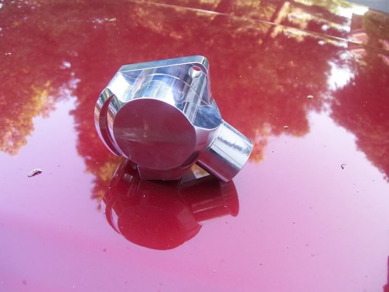

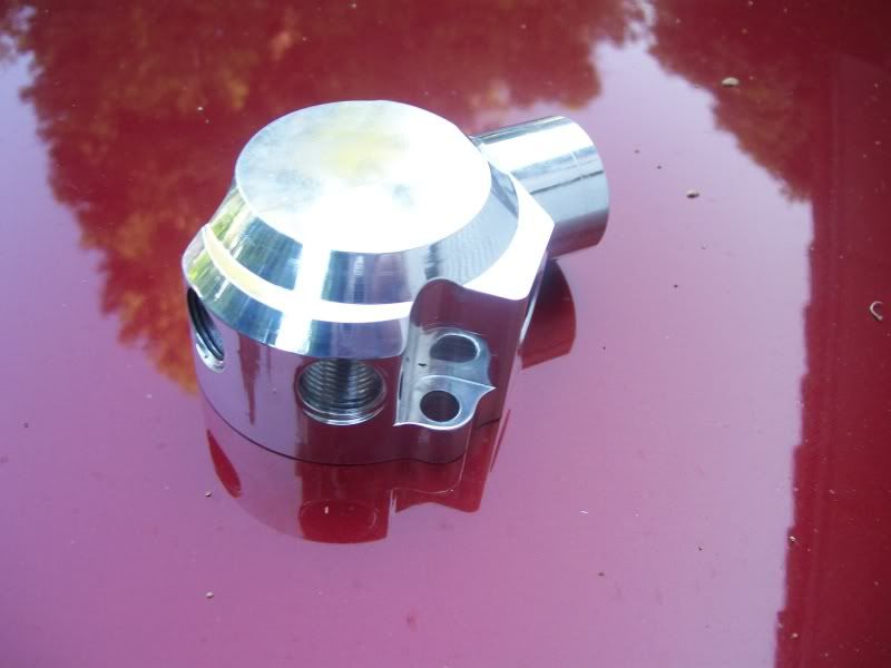

Another thing you could do is just make a 1/2" spacer for the stock one.

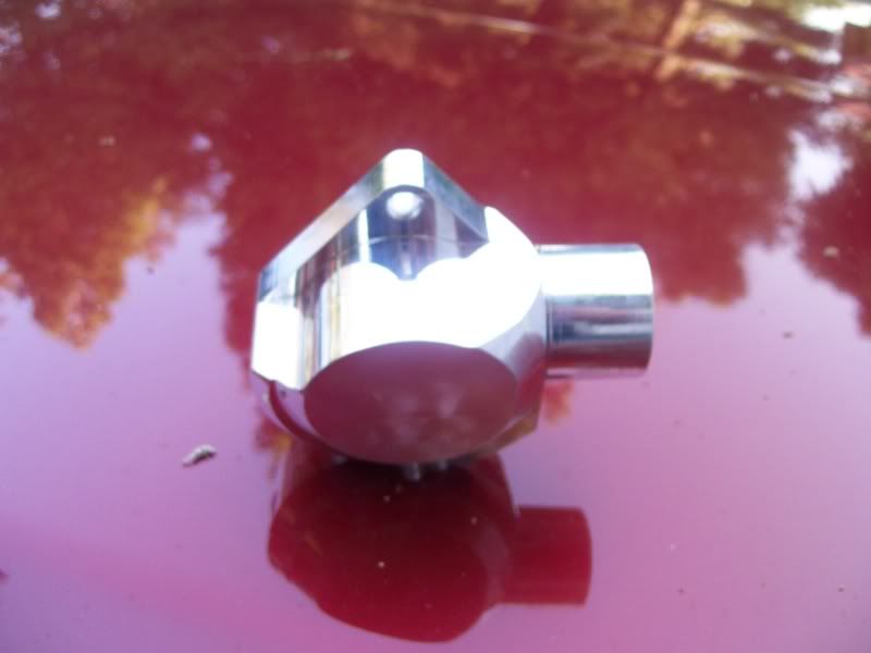

i test fit it today, and it just barely dosen't clear. About another 1/4" for a total of .5" spacing, and it should clear.Doward;1305491 said:You're really going to want to make certain the timing cover can come off without removing the hose or clamp, first
That would be my biggest reason to buy one of these.
Can we have 7M engraved?![]()

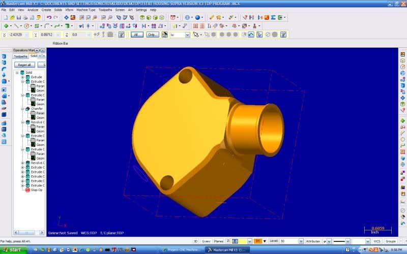

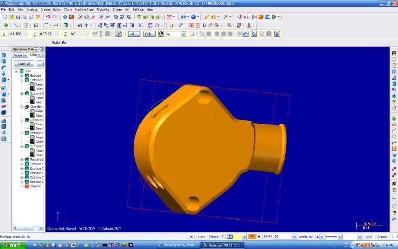

Doward;1306196 said:So get back to the drawing board, move the outlet out another 3/8" (since you said about 1/4", I like to have a little extra wiggle room) and see about getting 7M engraved on it
upgradedsupra;1305915 said:Why does it not have a counter bore? That would make it look much cleaner.
