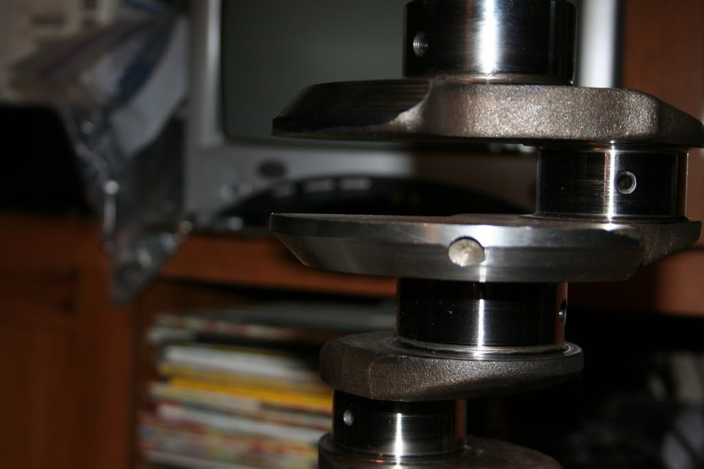

IJ. said:
Get as much weight out of the crank as you can!
I LOVE mine :D
:biglaugh: i couldn't agree more..
now that i think about it , i should have had him double edge my crank.

Beautiful pic, man!
IJ, I'm going to have Bryan lighten the crank as much as possible.
