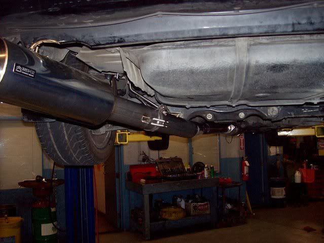

Wraith said:actually the 7m-ge has about an inch longer cat than the 7m-gte as well, i compared the two side by side. the n/a cat pushes my rs*r exhaust out the back farther than my turbo cat did for sure.
