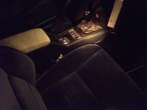

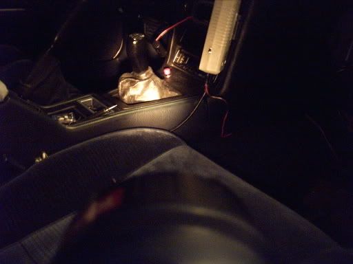

Funny this thread was bumped... I just made this:
Sorry my camera sucks, I'll take more pics in the day-light.
I got tired of the set screws, so I welded on some threads from a 12M bolt at homedepot. :)

The sogi mod makes the remaining metal part thinner than the top part that the stock shifter threads onto. You can't thread something smaller to make it bigger unless you did like him and weld metal in there. But commonly instead of buying a bolt like him i've heard of people making just a chunk of metal and tapping either end and using it as sort of an adapter.
