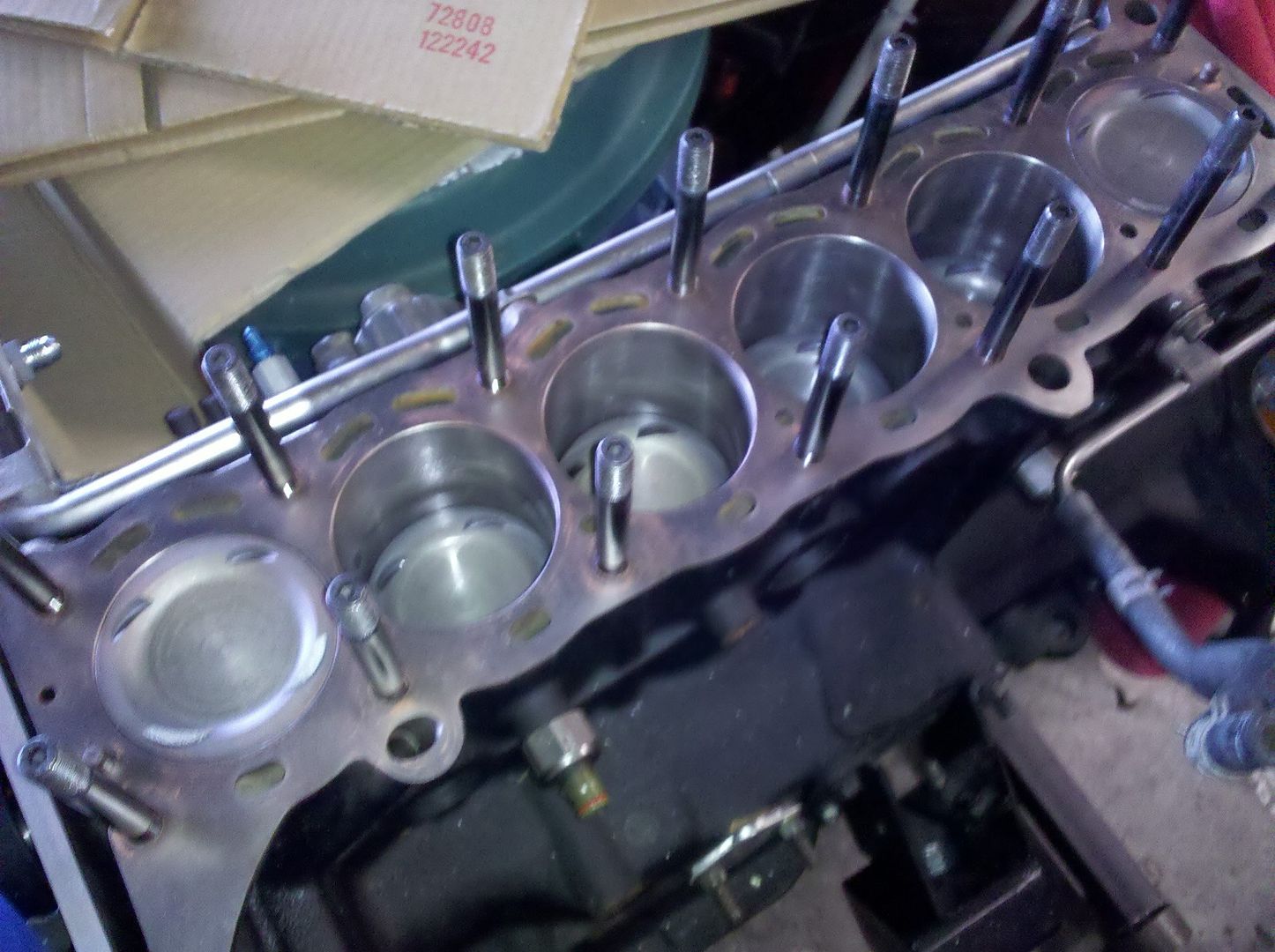

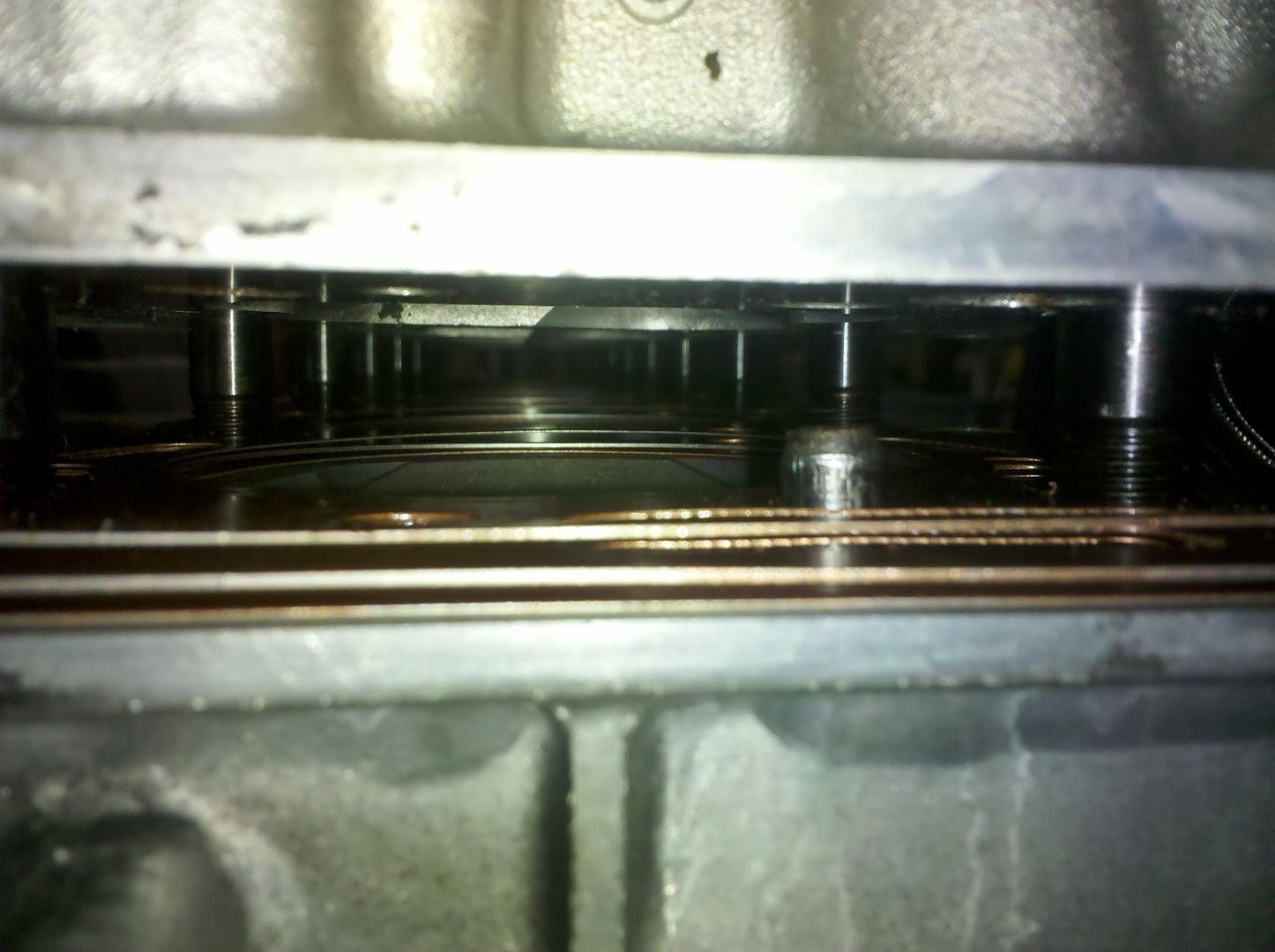

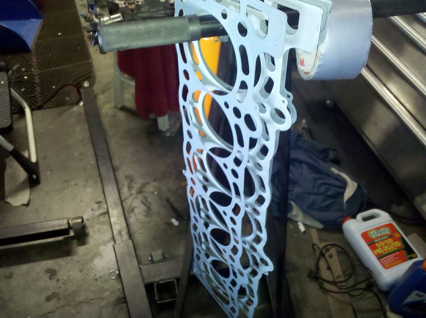

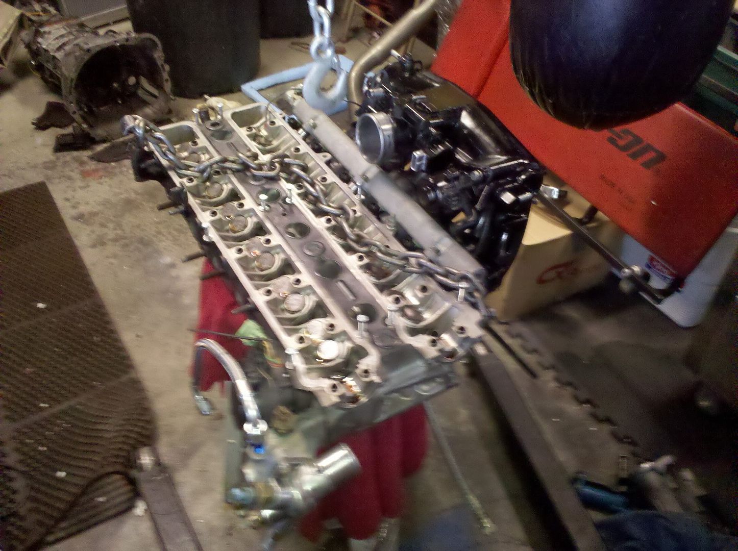

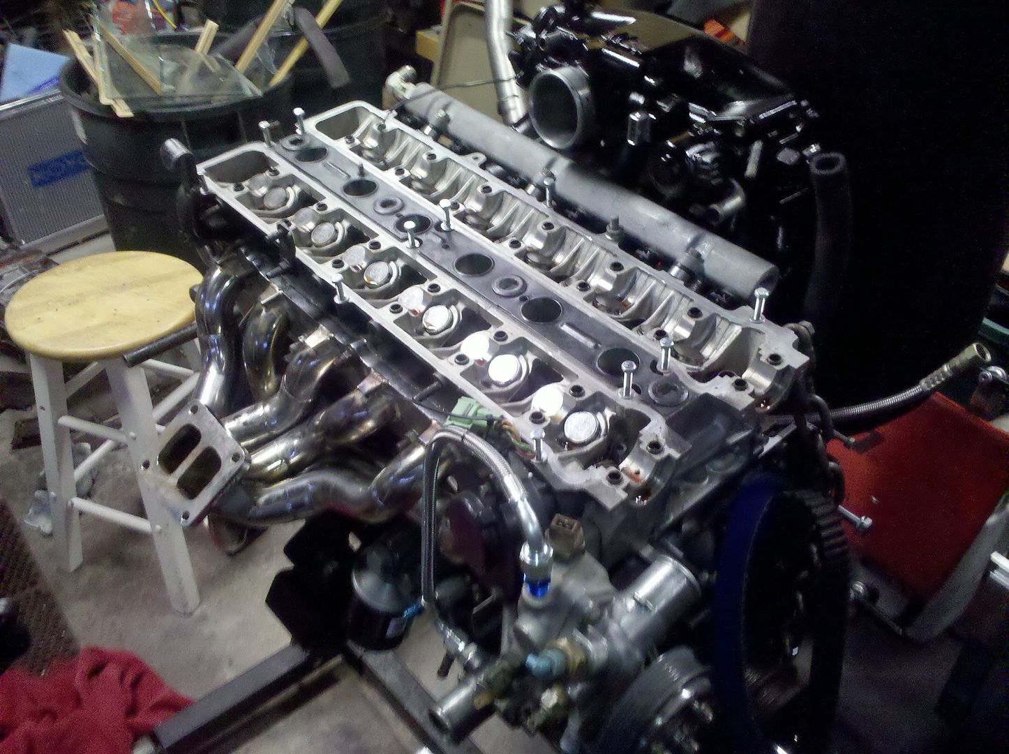

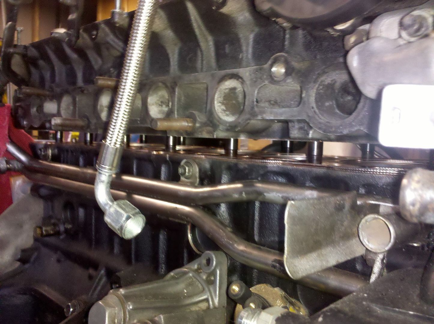

cleaned all the viton off all 3 layers of the hks gasket then sprayed it all down with copper spray.
installed head and torqued to 90 ft.lbs "i have arp studs"

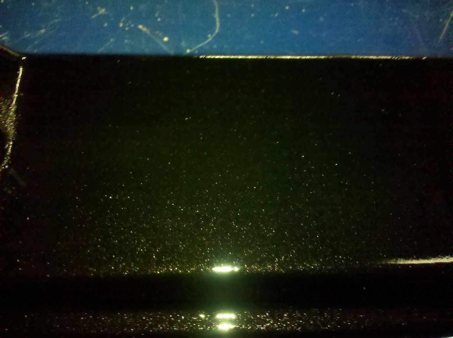

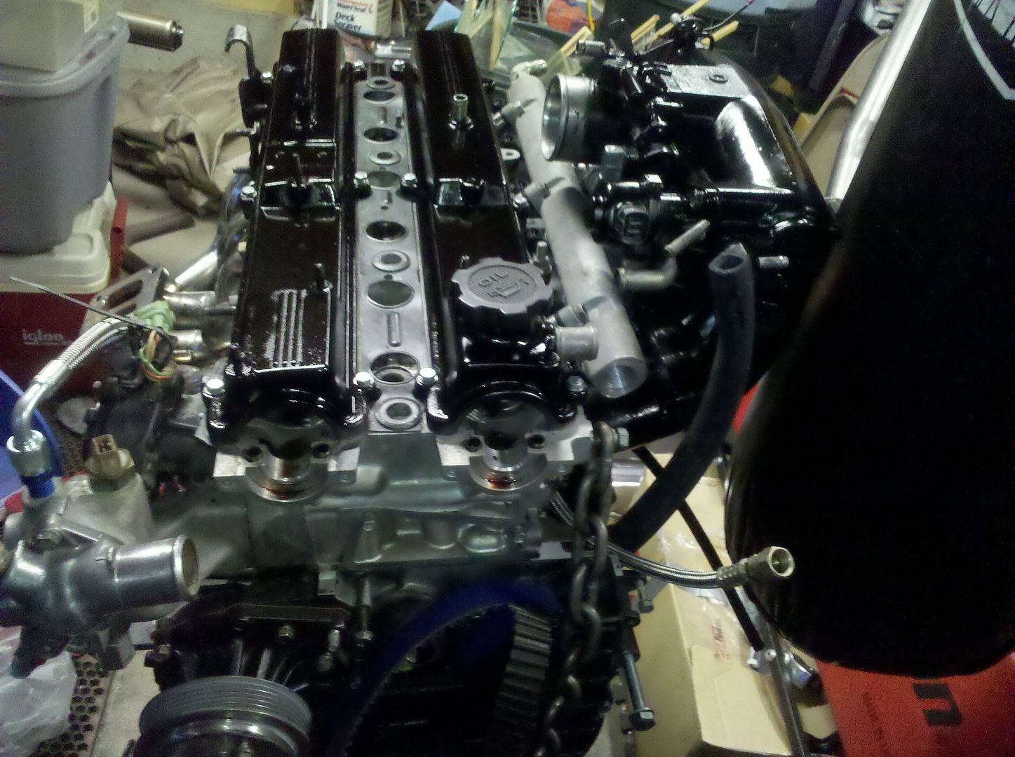

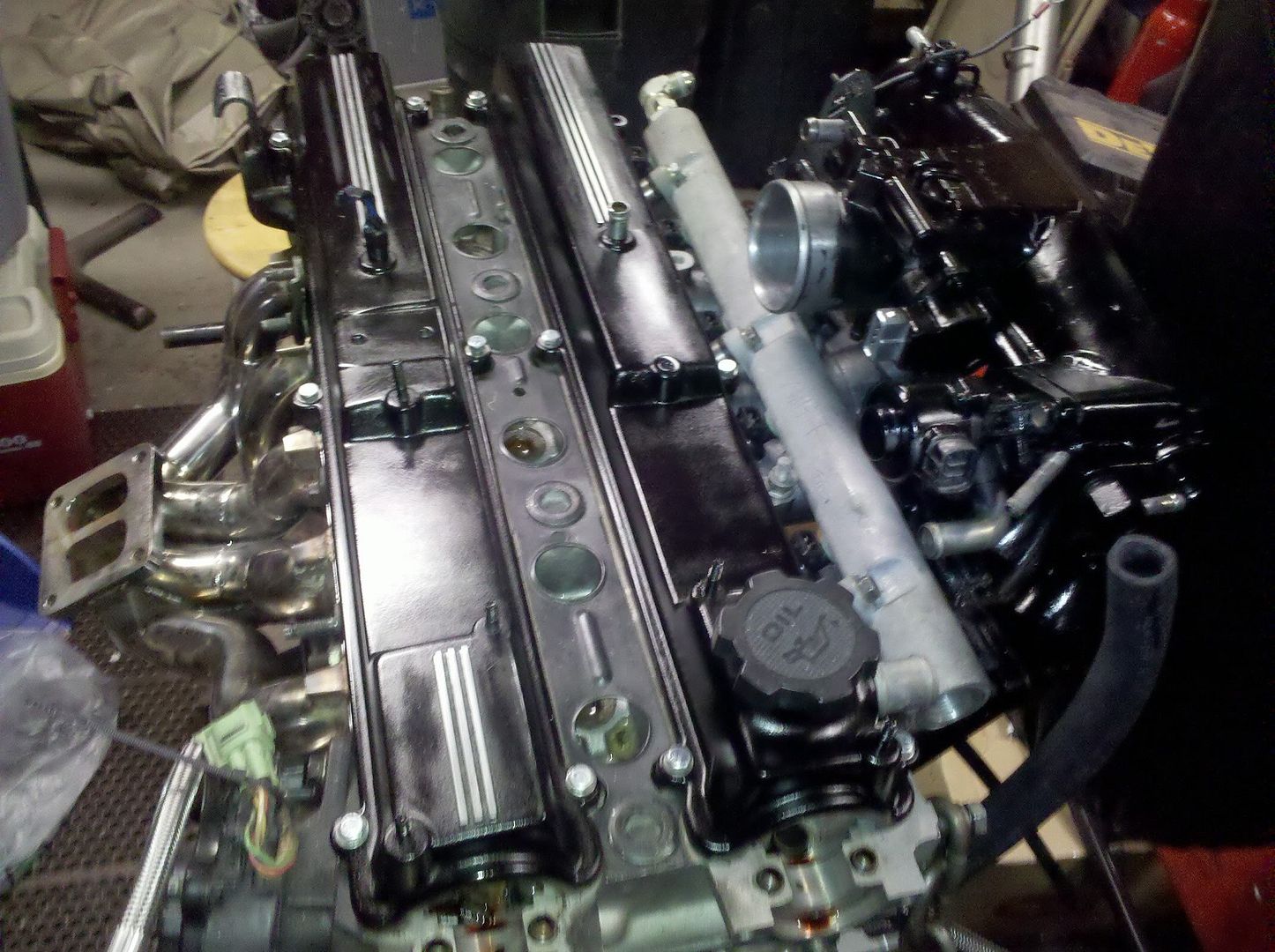

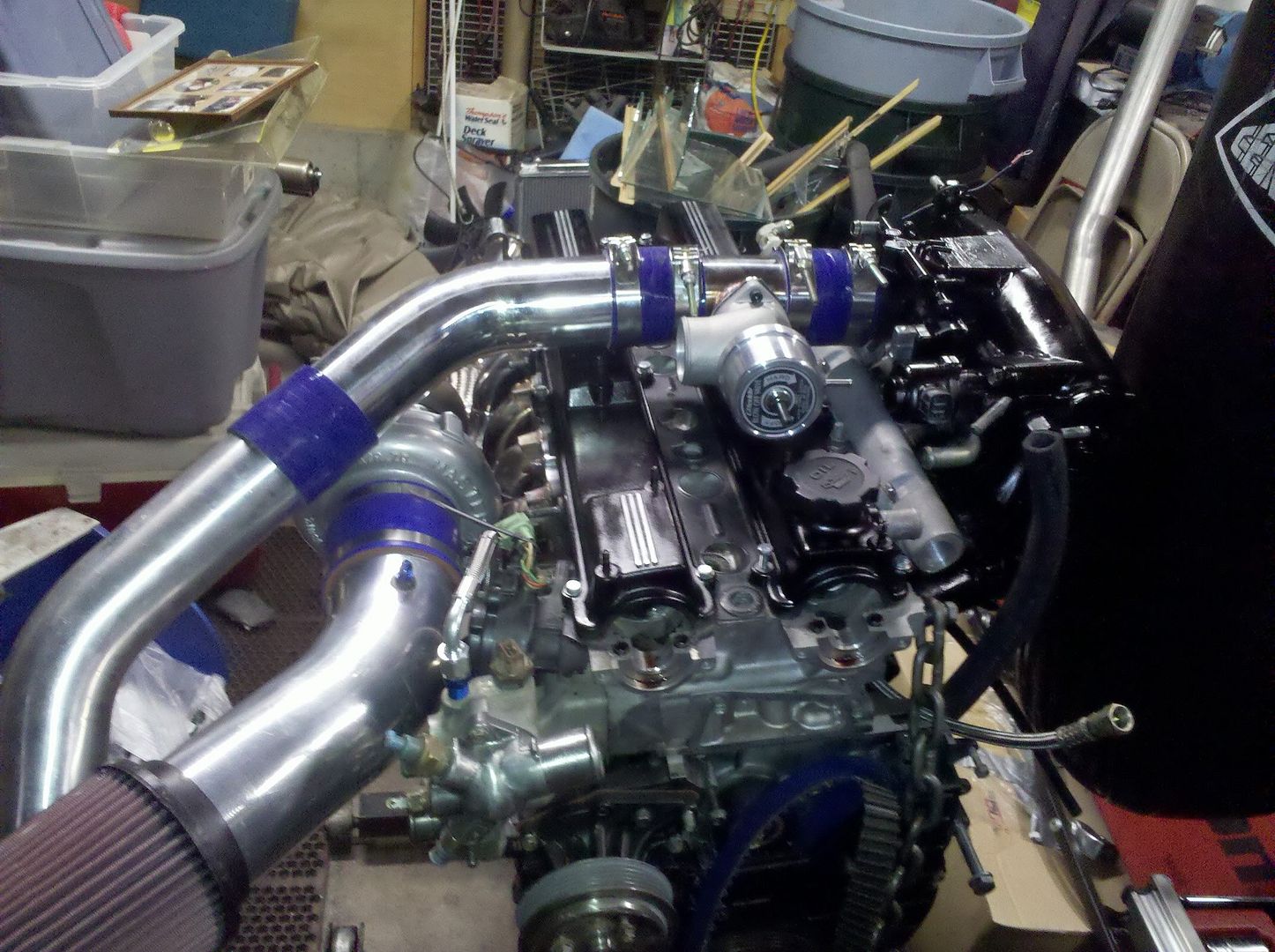

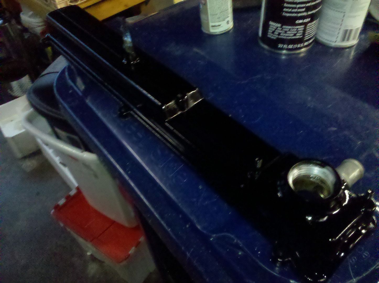

stripped paint off of old valve covers and painted it back to black with a hint of metallic

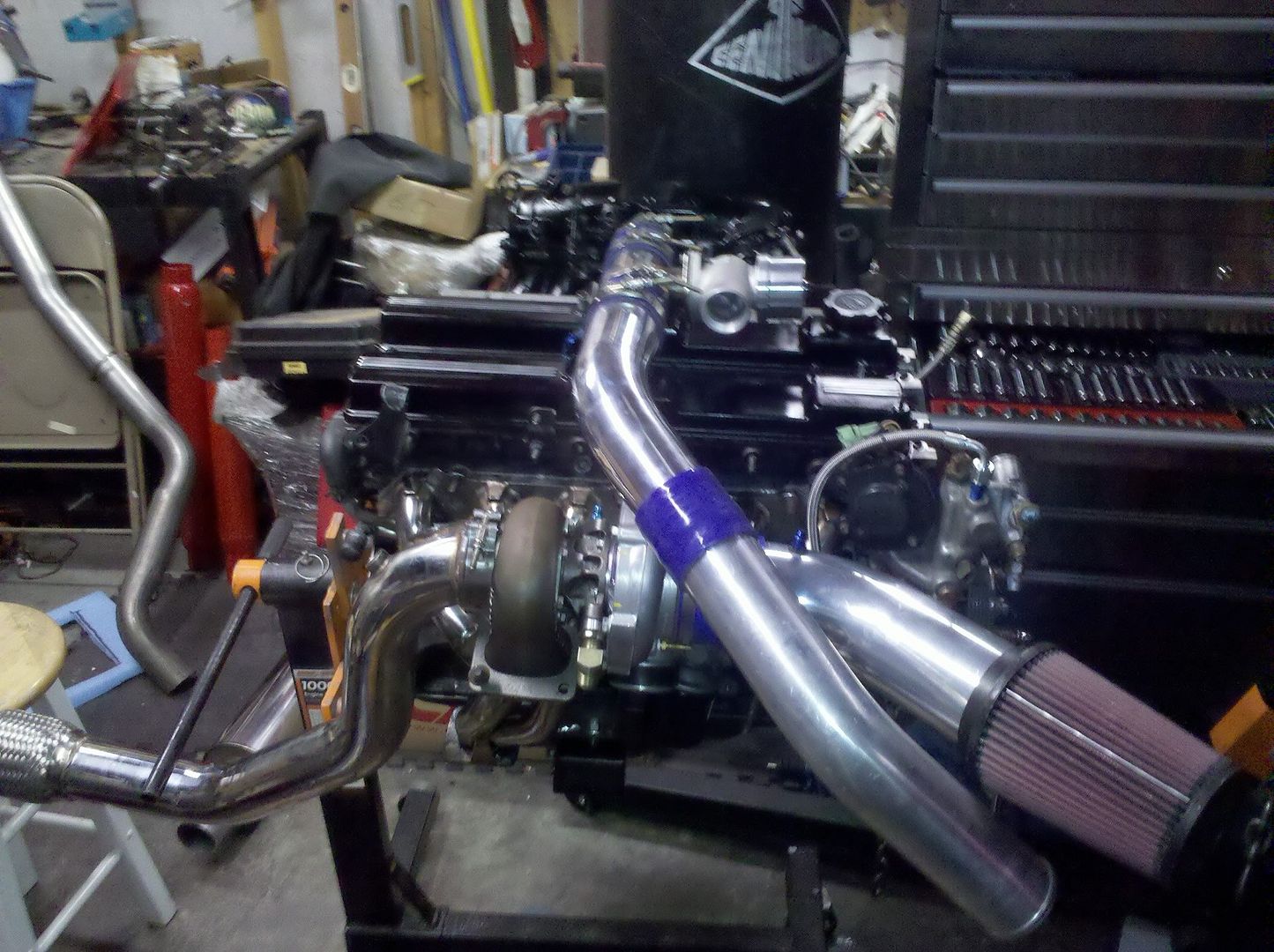

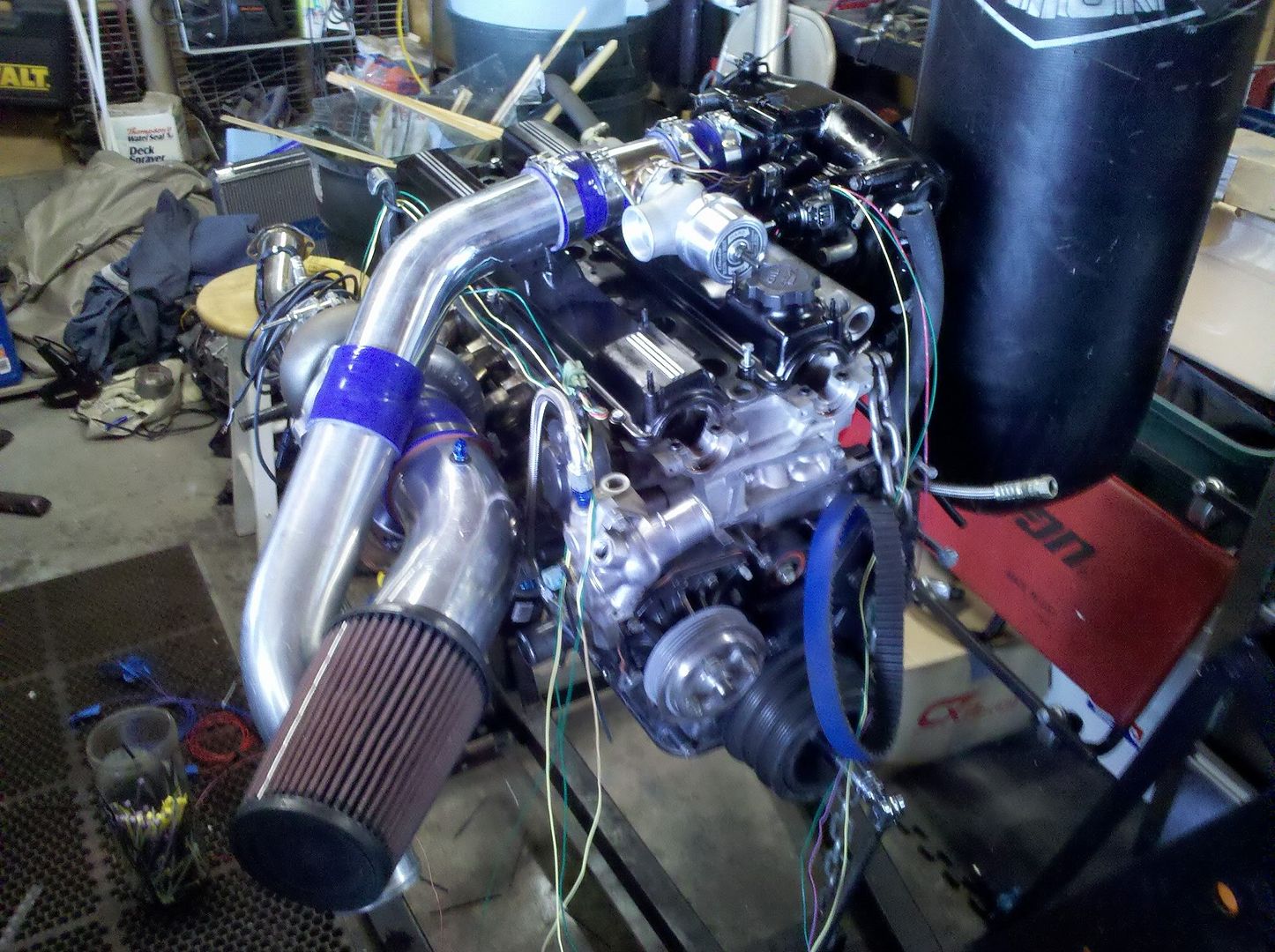

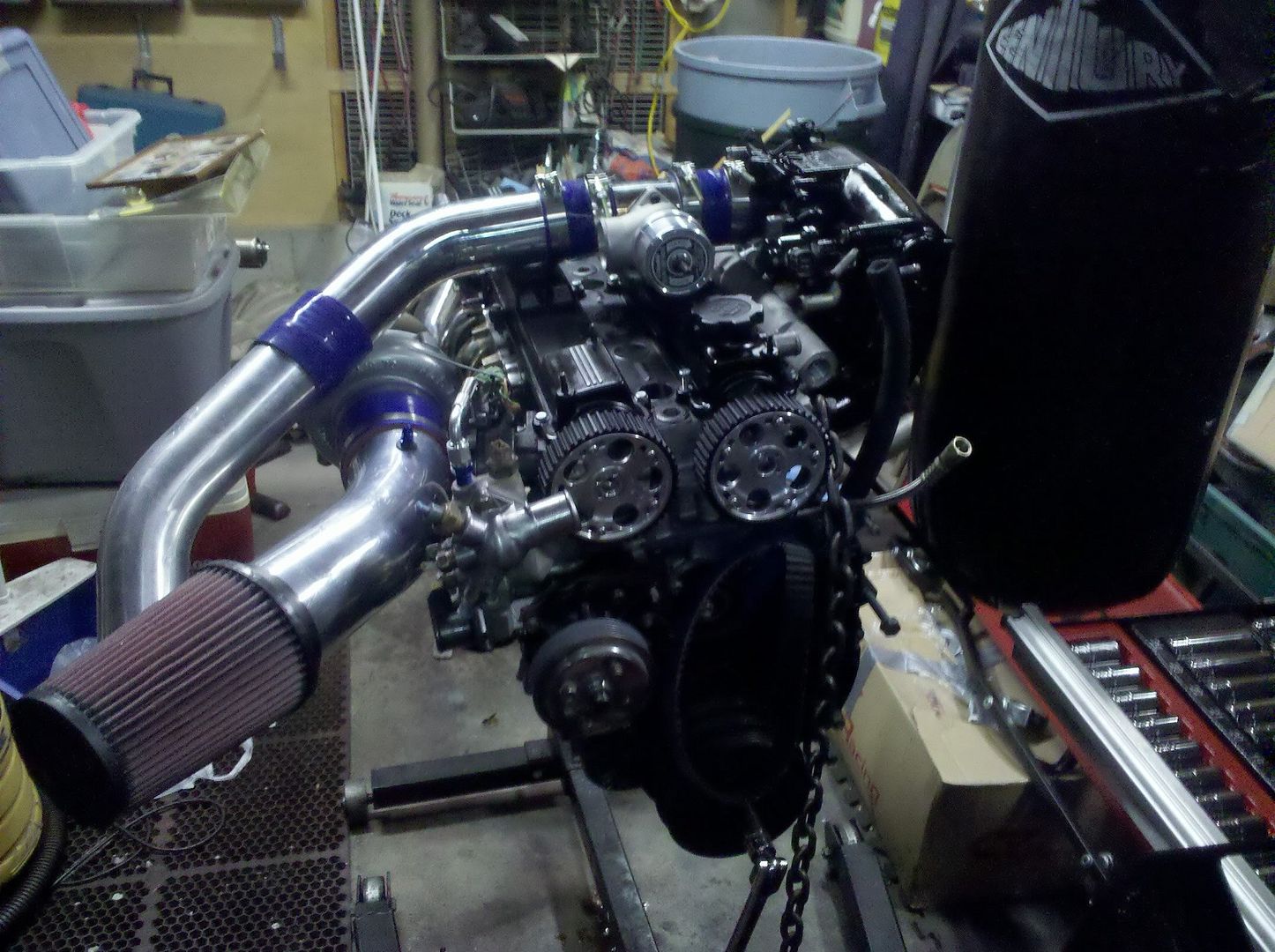

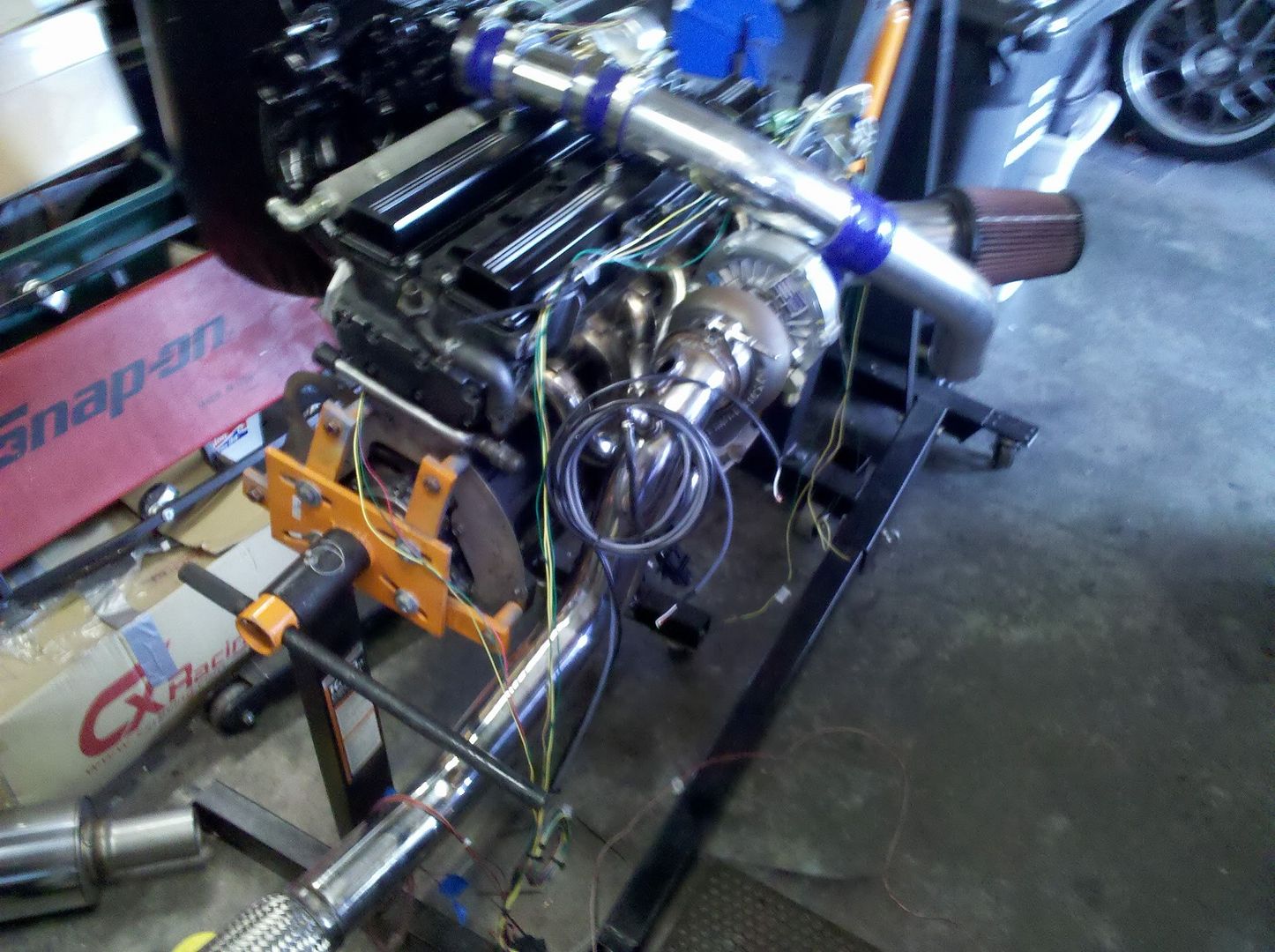

prepped the engine to check fitment of new IC pipes and getting wastegate outlet pipe fitted.
PICTURES!!

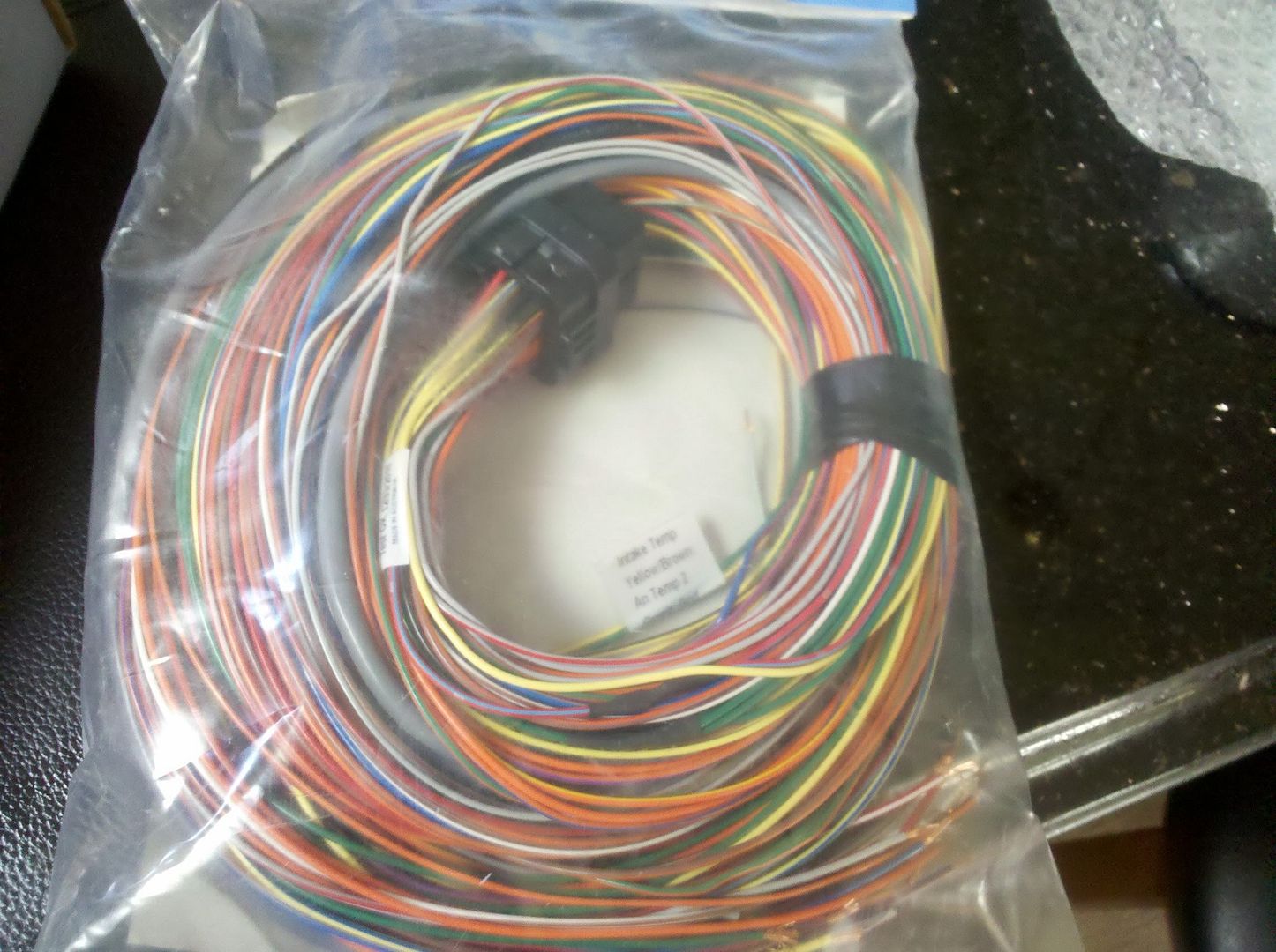

so this is just a glimpse once again into what the engine will look like in the bay. still waiting on the vipec to come, waiting on a call from bob at drift office to tell me where the vipec is
so hopefully i will know that tomorrow
