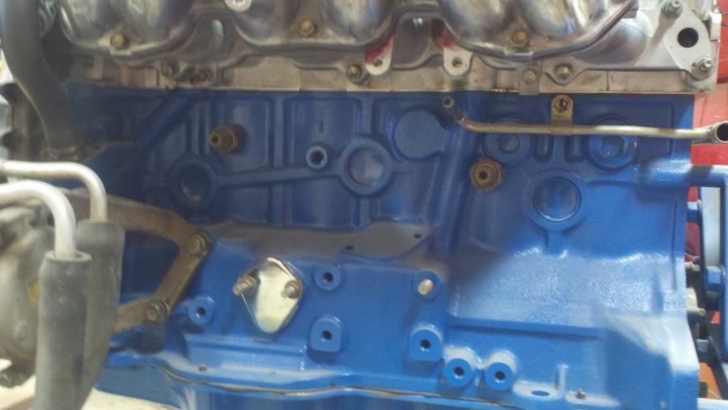

OKay guys, its been a while. And i have practically done nothing to my car. I REALLY need to try and get this motor preped to be dropped in so i can get the plumbing and wiring down in the next couple months.
I have added a few things to the block and i think i am almost done save for one side of the motor.
does anyone have some good shots of the drivers side of the block on a stand?? I need some guidence on what goes where on this side.
Otherwise i am practically ready to go..i think..
I am going to re do the oil drain tho, i think i might even pull the oil pan for the 4th time and get an AN fitting welded on there to get a really strait drain on the oil.
