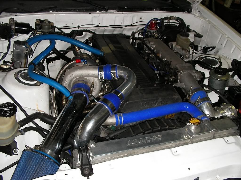

No, time for some race gas and more boost. It's only got 440cc injectors. I would say 426whp is pretty good for just slapping a turbo on a bone stock 2.5L longblock on pump gas. It has more in it, but it's not my car, and the last thing we want to do is replace someone's engine because we pushed it too far.

We modified the MDC turbo. The rear half is Turbonetics, the front half is now Garrett with a 360 thrust bearing and billet backplate.

How big is the AR on the exhaust housing... And the 360 bearing, is that a ballbearing or standard?

Sorry for leaving everyone hanging, it wasn't intentional. I'm real pleased with 426 hp, especially 426 SAFE, 20 psi & on pump gas hp. The rear a/r is .58 IIRC. Happy days!
