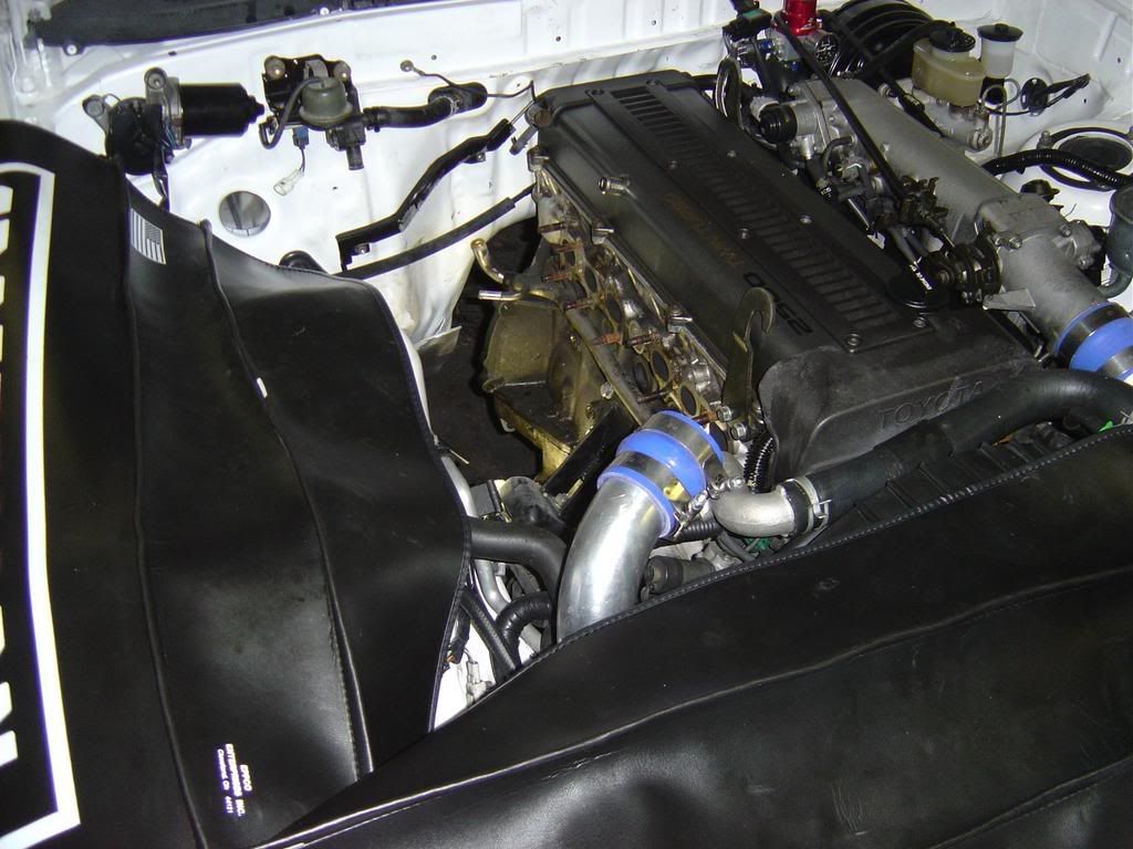

Ok, here's where it's at now:
First the good:
Twins are gone!

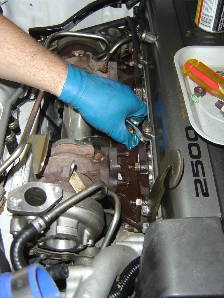

While I was removing the turbos

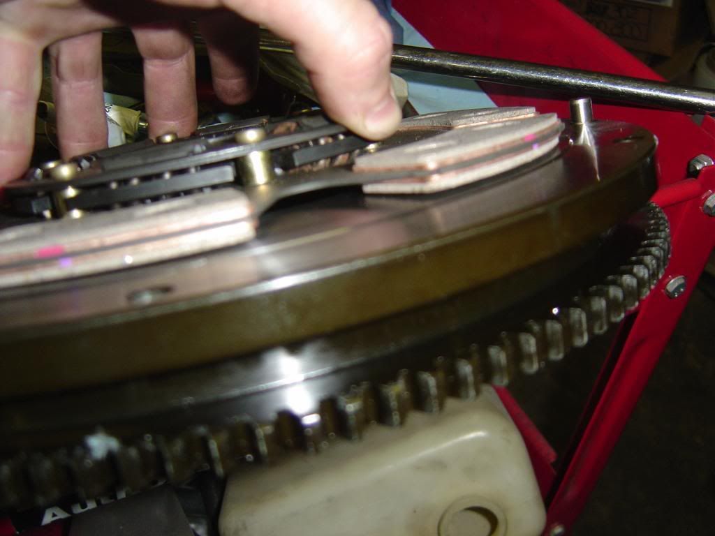

Brand new Spec clutch disk is warped :icon_conf

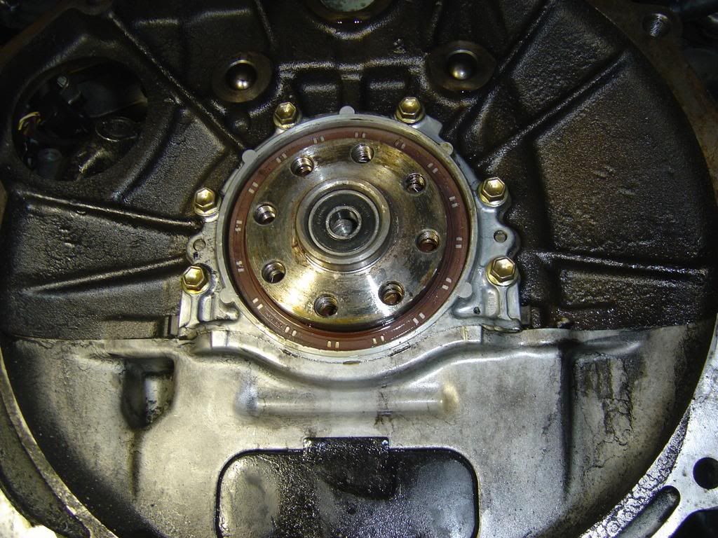

If you've installed a rear main seal on a 1jz before, you should be able to look at this pic and see why it was leaking oil badly. :icon_wink

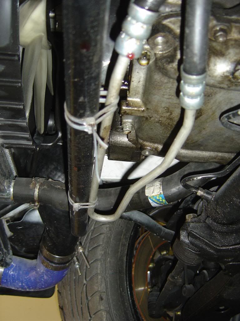

Tip ties holding the power steering line to the sway bar is like bad and stuff :biglaugh:

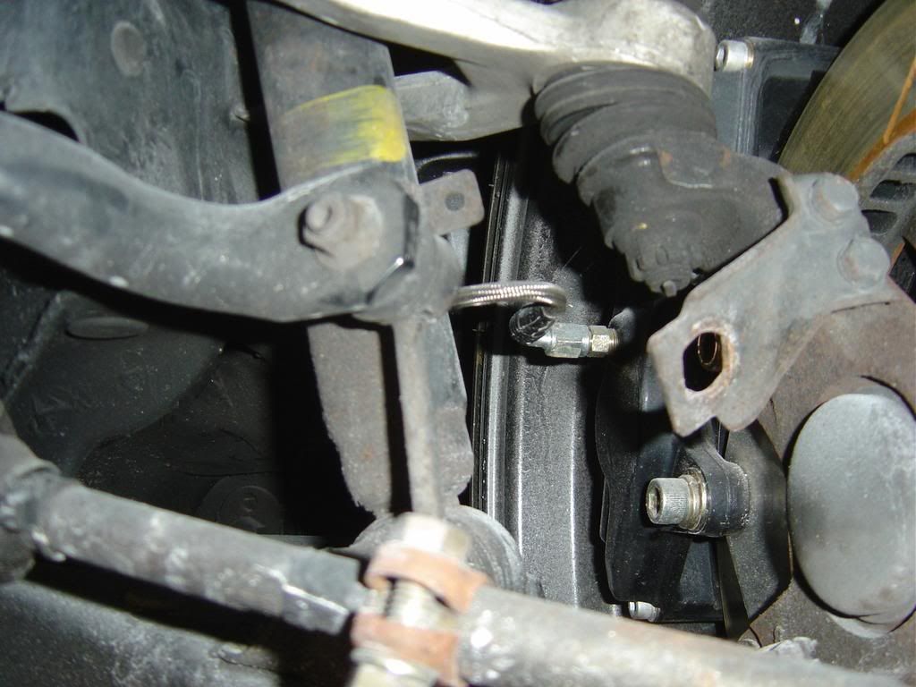

ARZ brake lines are not designed to replace both upper and lower brake hoses, we noticed that the way it was installed it was rubbing the shock and gets almost pinched with the steering at full lock. I'll make new custom brake lines for it.

The engine was already installed. We are troubleshooting some installation issues, installing the turbo kit Mark got from MDC Motorsports, e-manage, wideband, PJ painted it, and last we're tuning it on the dyno.
