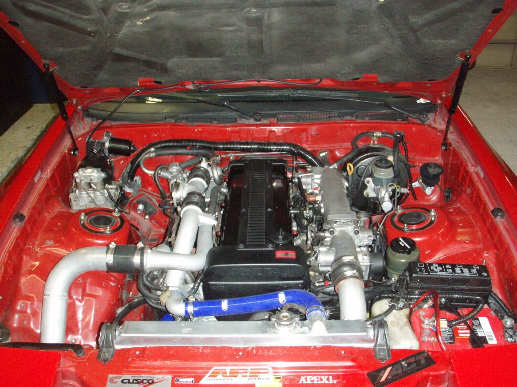

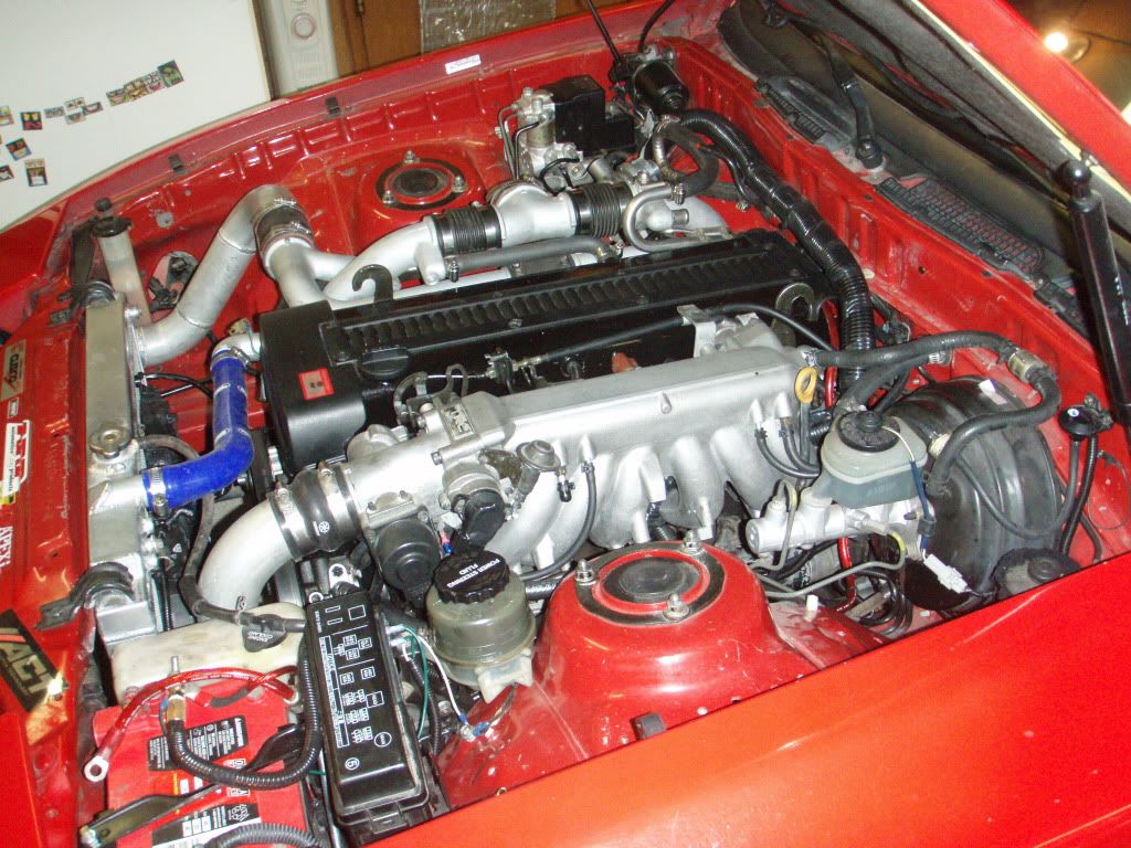

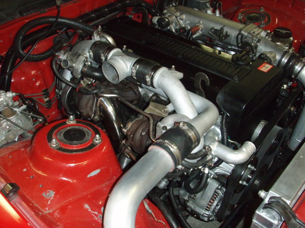

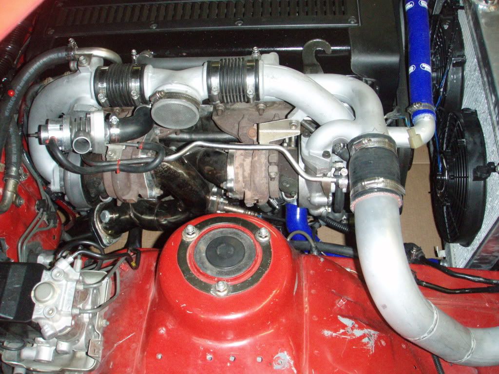

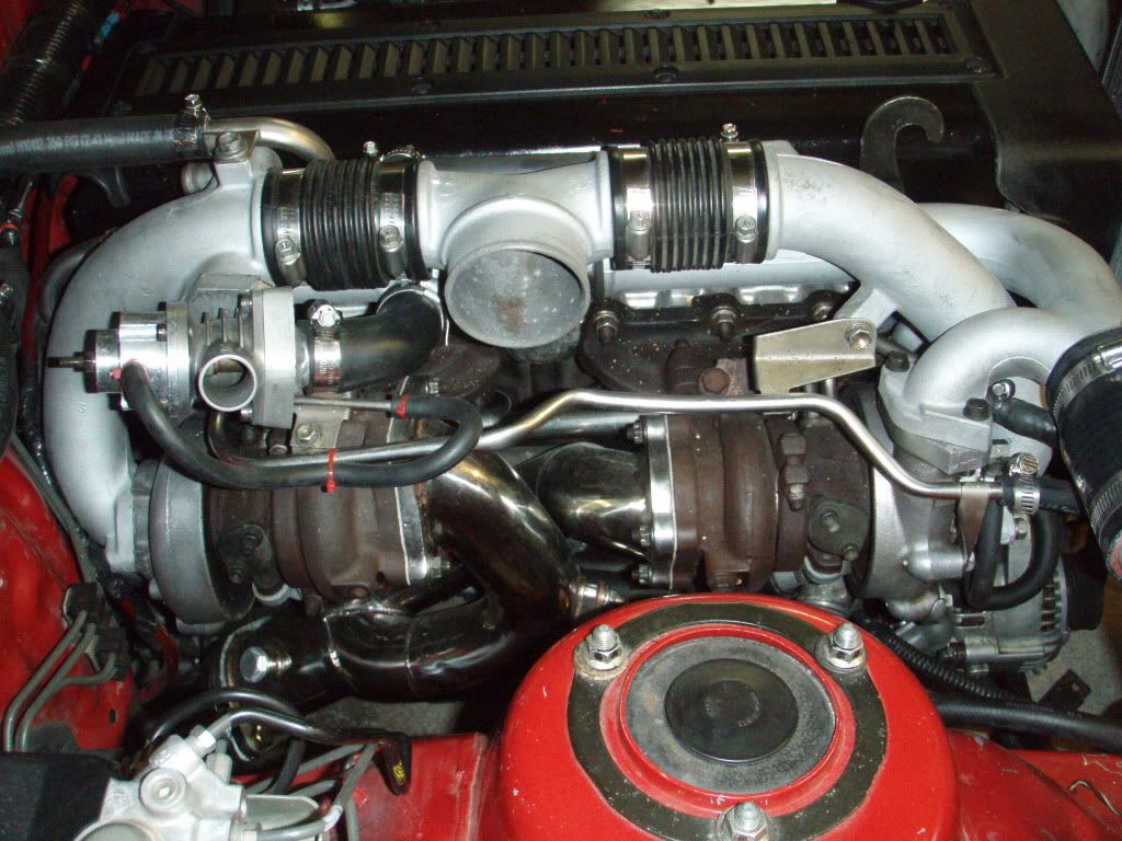

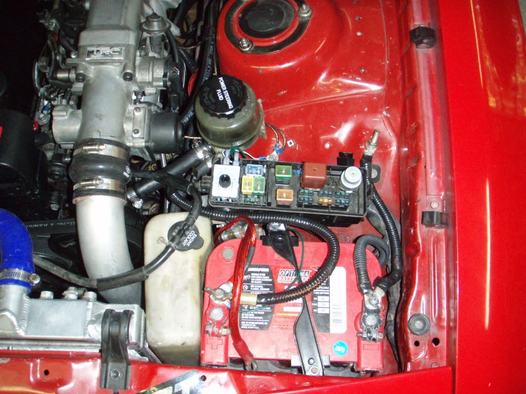

Holy Shit it has been forever since I posted in this, Well the 1JZ swap is 99% finished. I drove her yesterday. I had a little issue with the COR relay not working. In 92 teals write up it says nothing about wiring in the red and black wire on the B1 plug for switched 12v. I wired it into the INGSW out on the Ecu and grounded the green wire. VIOLA key on fuel pump....THANKS JZXPROJECT.
I still have a few things left to do put it is most cosmetic and fluff shit. On to some pictures.

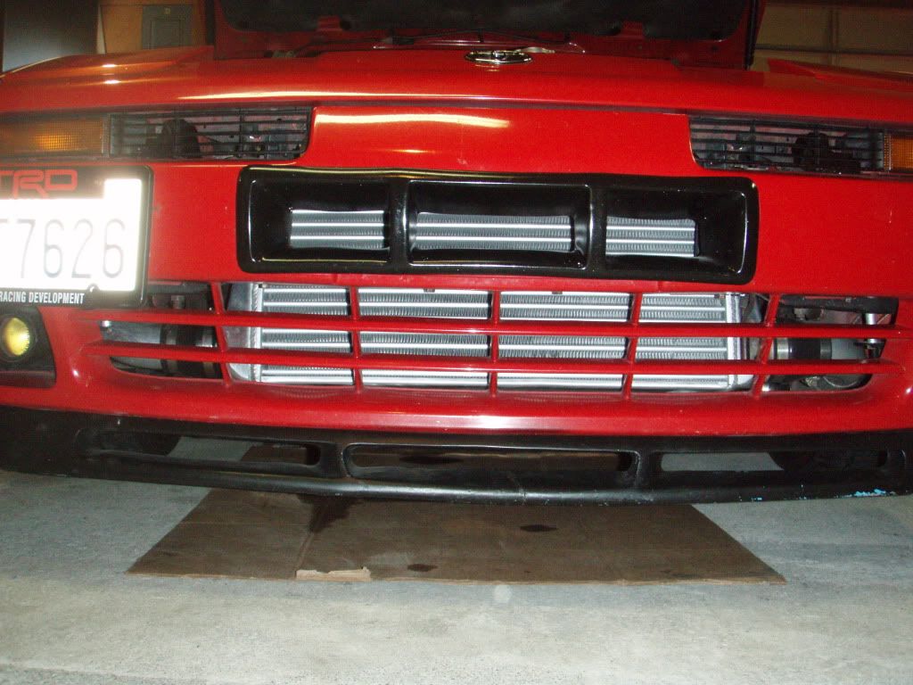

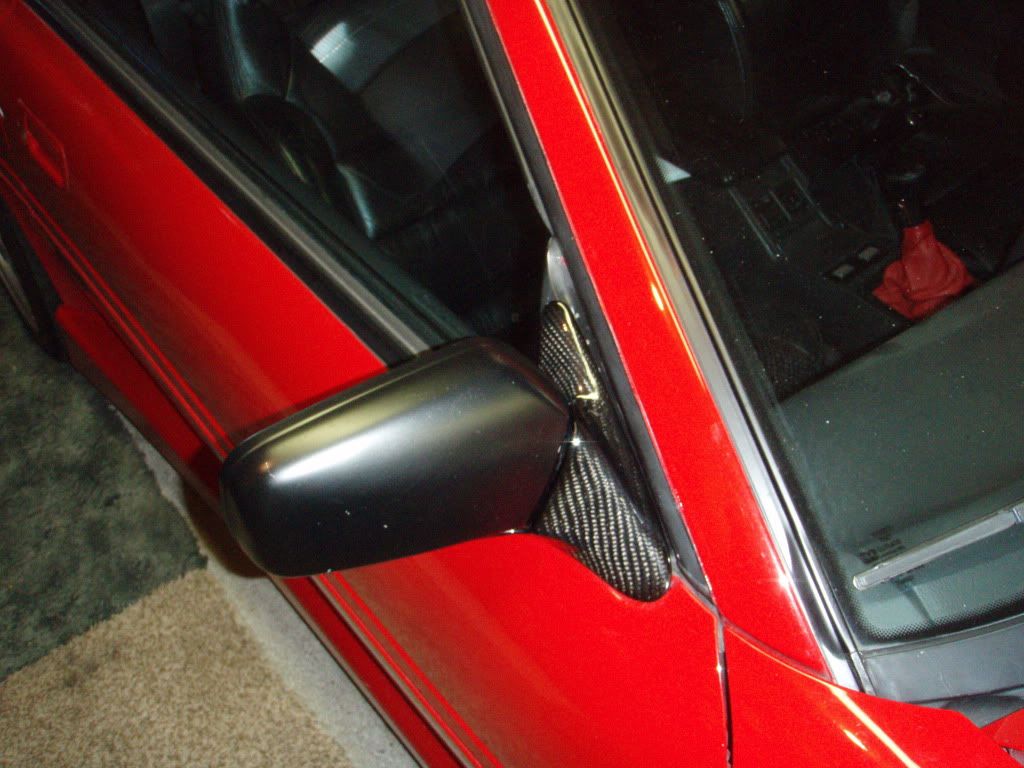

Holy shit, I haven't posted in this for a while. Been over causing hate and discontent on SF. LOL. I now have a 14 month old daughter, finished school, started a media website and work at a Haunted insane asylum. The 1j is running great, I love the JZ series motor. I have have made quite a few modifications lately, Most notable is the J5Classified 40mm front splitter. It is made of 3/16th inch abs and goes all the way back to the rack. I also installed a carbon fiber S2 airguide, and replaced the rears with a set of Do-Lucks. I had the a Do-Luck type 2 wing which I will show you guys, But I recently sold it for 150 bucks. I also now have a J5 Classified twin tipped three inch blast pipes.

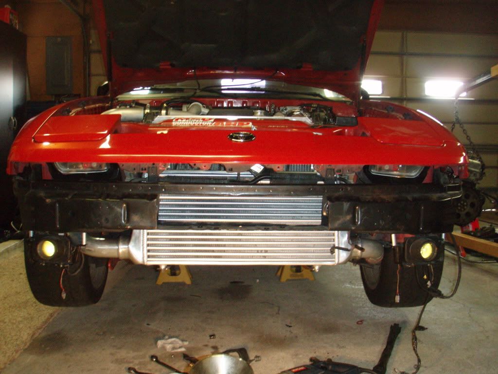

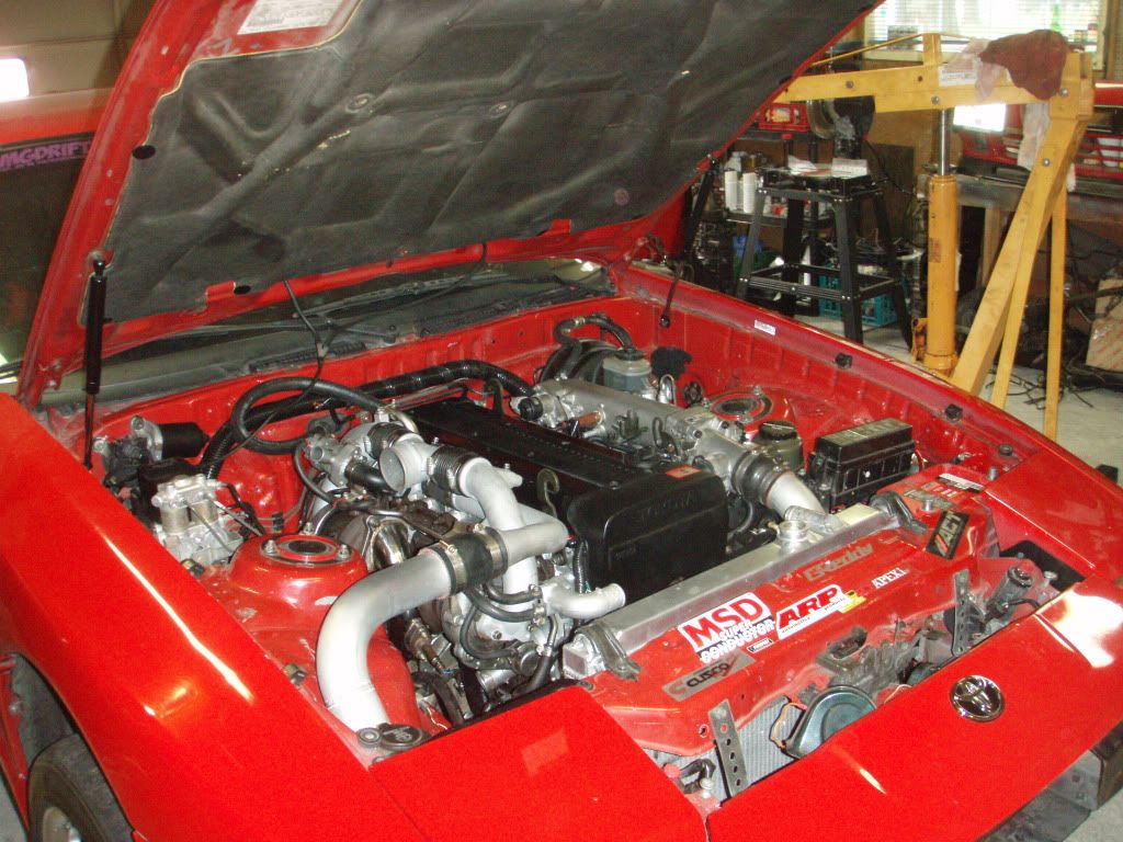

Someday I will up date this for prosperity, I still have this car, it is totally different with a lot of work into it, as I type this , the car is at the tuner for a second time and should be making a modest 22 psi on pump with cams , big turbo, and water meth.
