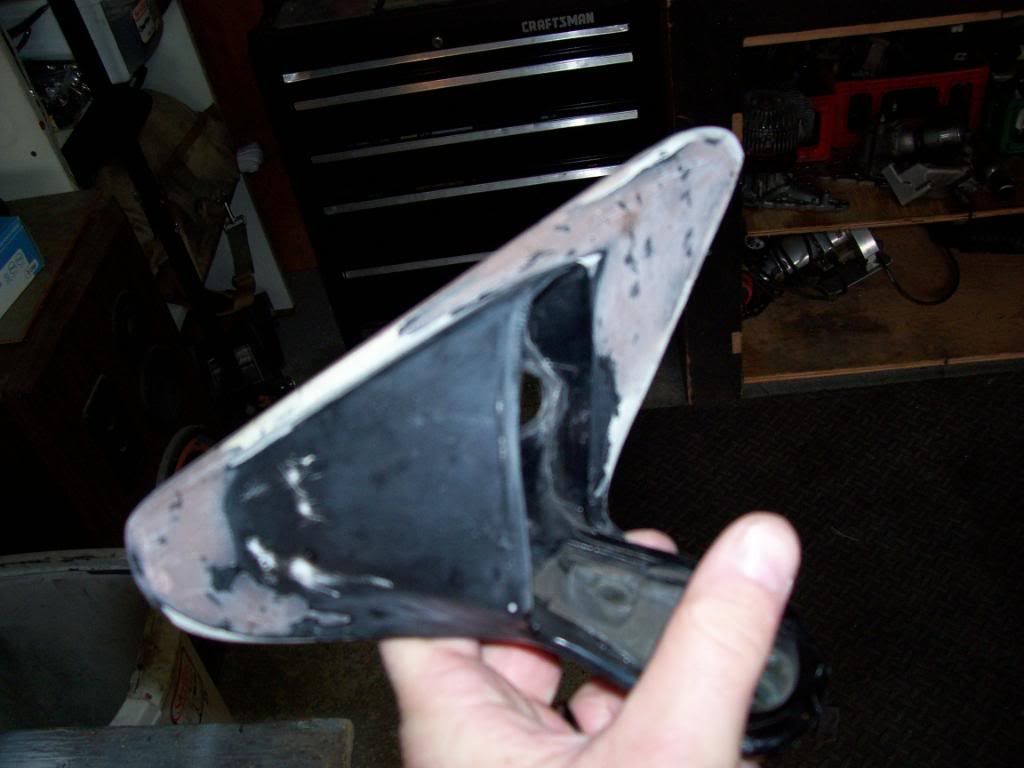

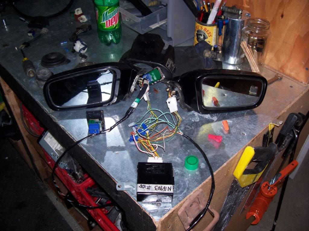

I got these fro RHDJapan. for 250.00 they came with the control switch and the control box. They are in pretty bad shape. I don't have any idea why Toyota used rubber coated metal for these, But it was retarded.
This one was the better of the two. I have some work ahead of me.

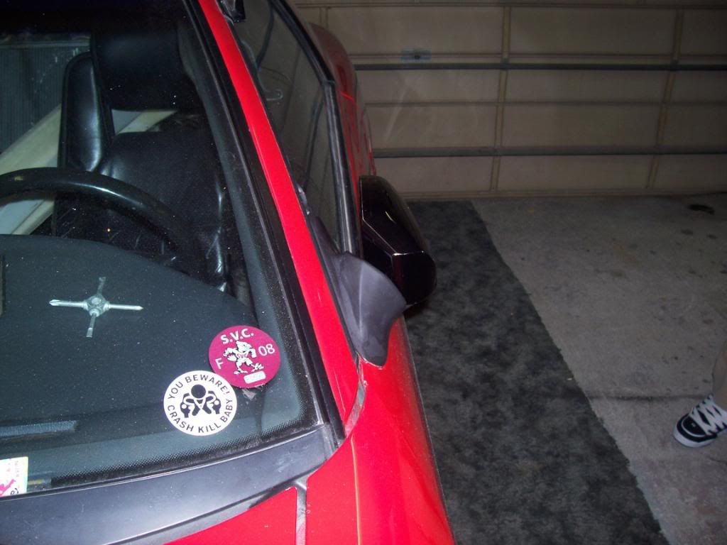

Matt, looks pretty good. When are you painting the parts, or, are you painting the entire car. The fit actually looks good too.

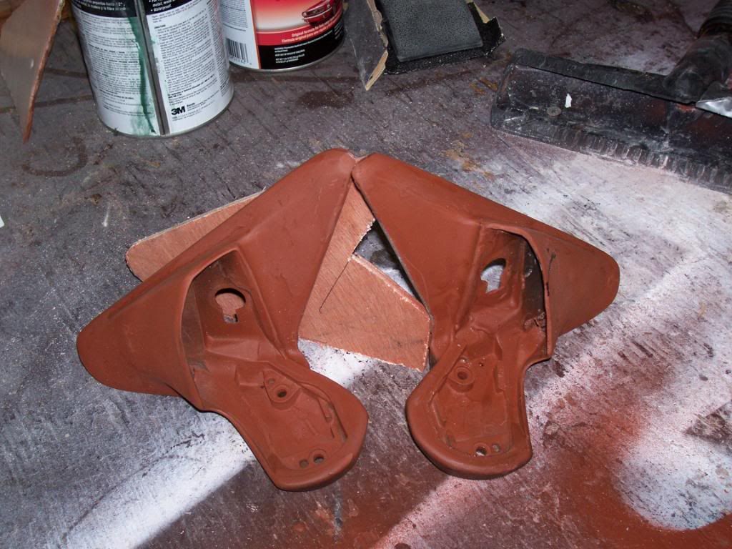

Well I have been some what slacking lately, But the mirrors are done and ready for paint.

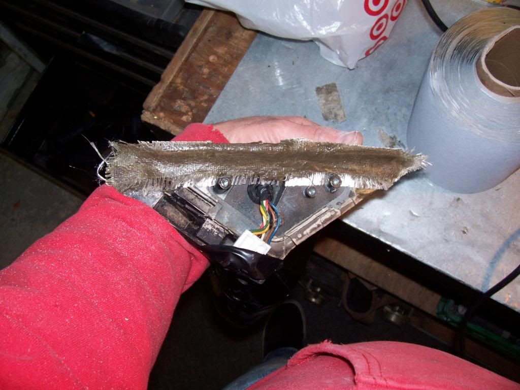

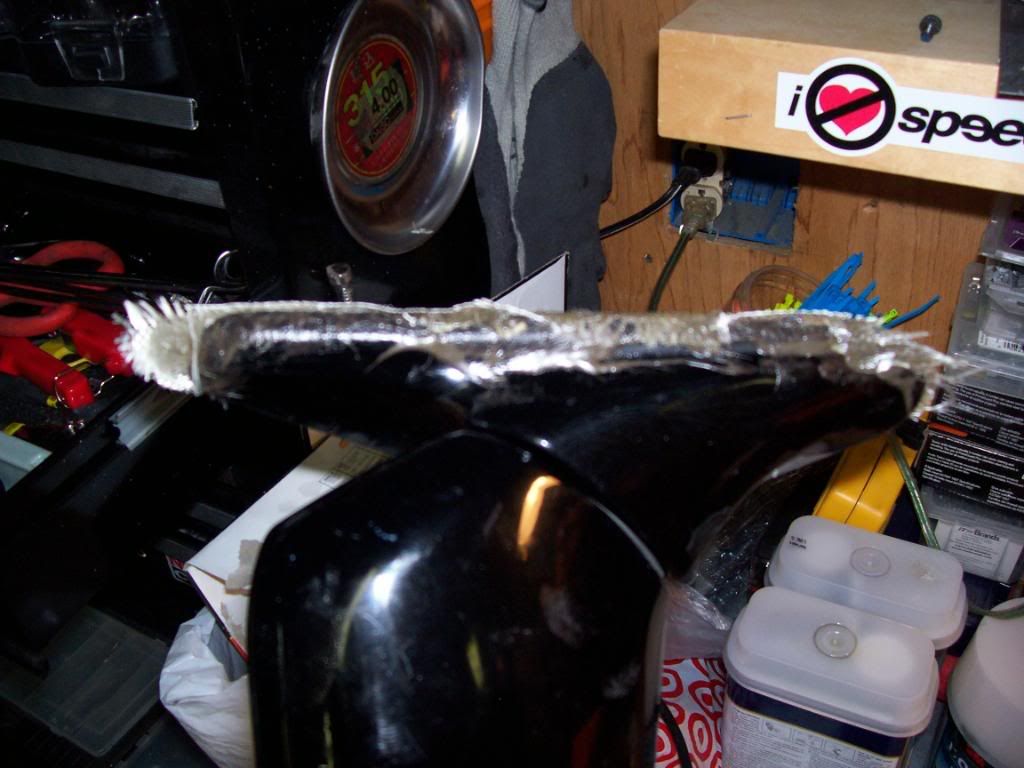

I had to complete rebuild these mirrors the longer I worked on them to more the JDM rubber crumbled . Finally I said fuck it and just went ahead and remolded them by hand.
Final Glassing finished and primered to see hairline cracks and dimples

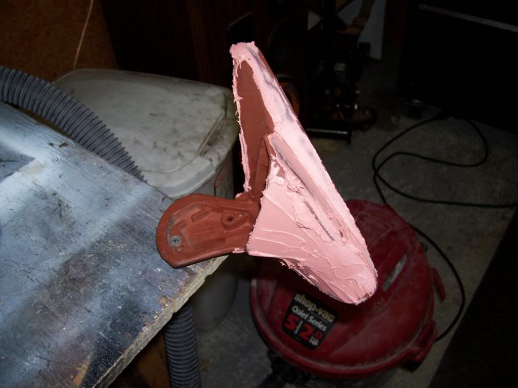

After initial primer I noticed alot of surface imperfections so I started applying filler

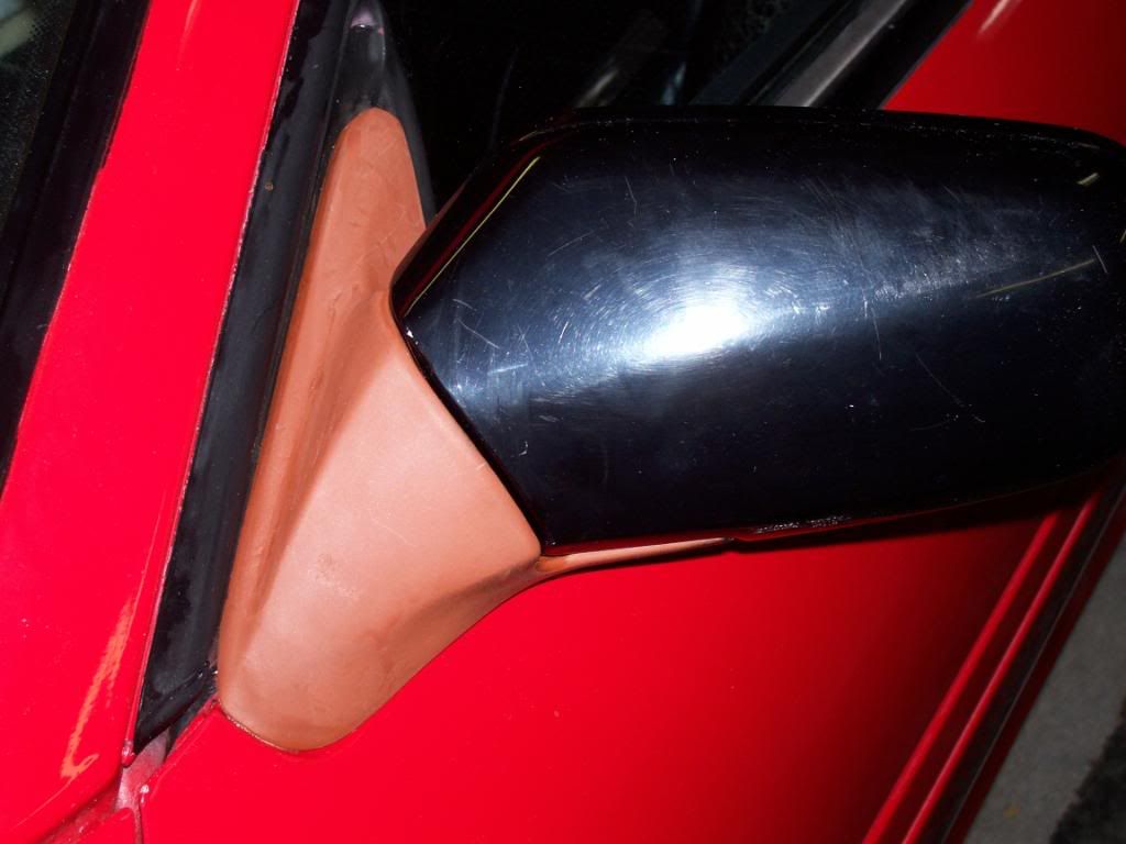

Once that was dry and solid I slowly sanded and fit the mounts until both sides fit the car flawlessly. I started with 60 grit and finally finished with 2000 grit.

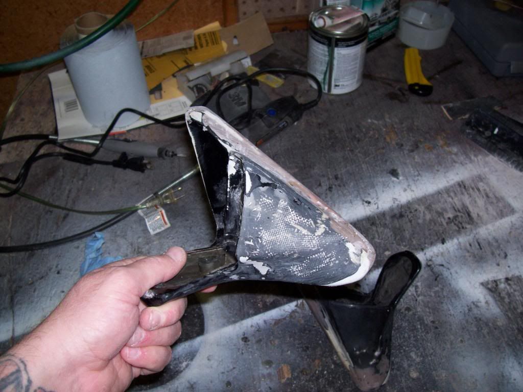

This is after the final glassing,But before the filler you can notice the imperfections along the long straight piece . I was more concerned at the time with the radius at the lower edge where it rests in the factory depression.

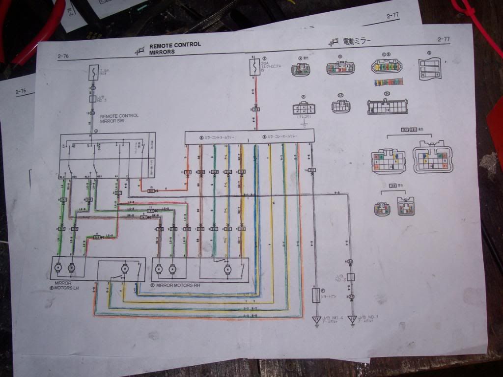

This is the Final test fit and to test the power folding function. They worked just like factory. Next step is to paint them when I get the rest painted. Now I am going to remove the interior to run the wires ,mount the control box,and replace the USDM switch with the JDM switch
