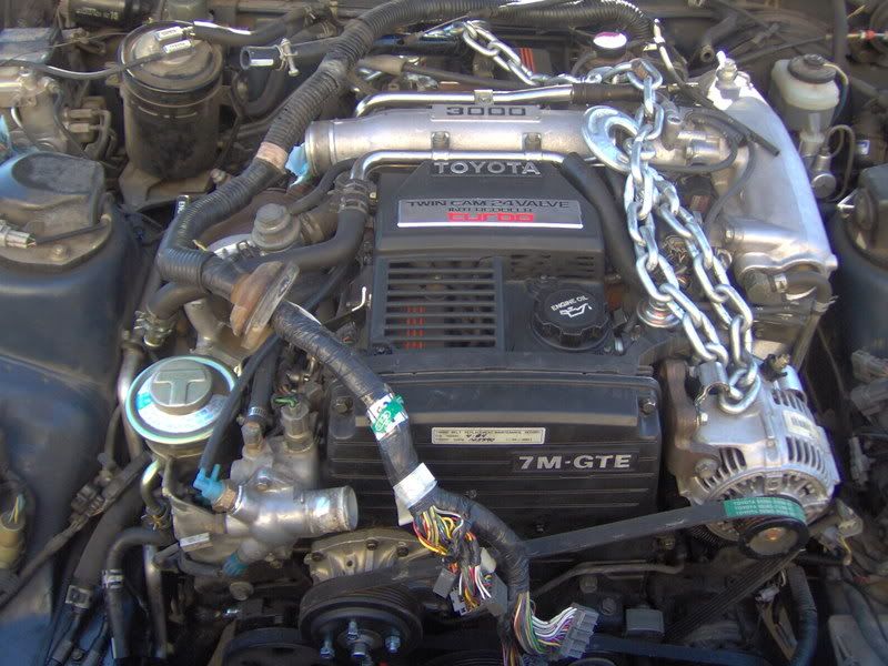

The motor is back in the car but not right. It's being a bitch! Not happy and in a shitty mood. Will try to get the motor mounts lined up right tomorrow.
Oh how I vividly remember exactly this night during my build.
LilMissMkIII;1187562 said:
Come back to it with a clear mind tomorrow, I'm sure it will work out :)
This, and...
Poodles;1187823 said:
They should just slot in...manhandle the bitch until it slips in :D
...This! These two things combined is what cured my problems. Get it as close as you can to being in place. Then, drop the motor until it is resting enough for the chain to break tension. Now lift it to a point to where you can just barely move it. Then manhandle one side in, and get the nut started on the bottom of it, leaving as much slack as you can. Then lift the motor as much as you can without pulling the nut through. Then, you should be able to swing the other one into place, using the one side as a pivot. I think I was able to get it into place in short time the next day, after the frustration got a good night's sleep.

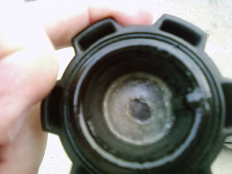

Everything checked out good and then I removed the oil cap.
I just about threw up and almost set the car on fire. But after wiping it clean and realizing it was most likely all the assembly lube in the head, I felt better. It did not reappear. No overheating or boiling over.
