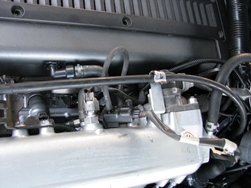

Installed the PLX Devices SM-AFR/DM-5 Wide Band O2 Sensor in the cluster. Removed the boost gauge and installed the WB gauge in its palce and it looks pretty good.

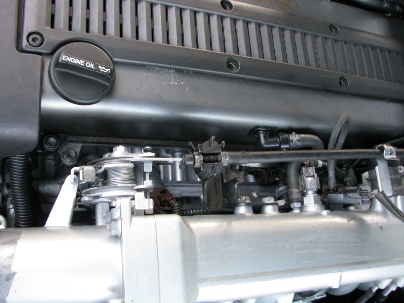

Here is a shot of the Camry's throttle cable - a few bucks at the junkyard. Nice and snug and no sticking.

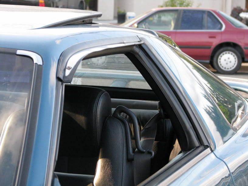

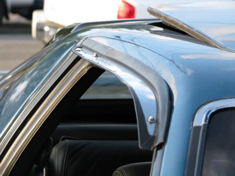

RAIN GUARDS:

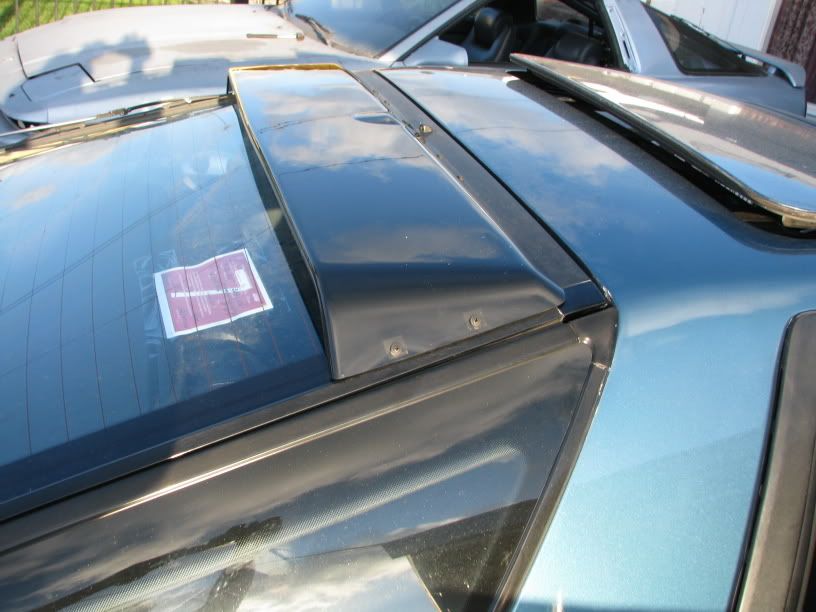

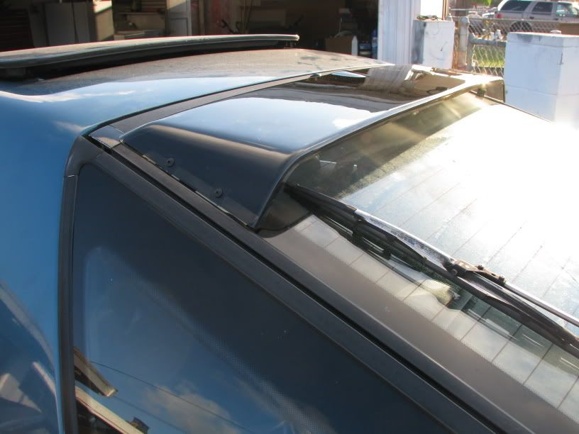

HATCH VISOR:

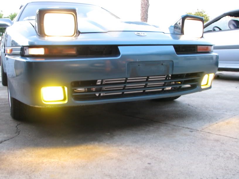

LIGHTING:
EURO TURNS and YELLOW FOGS

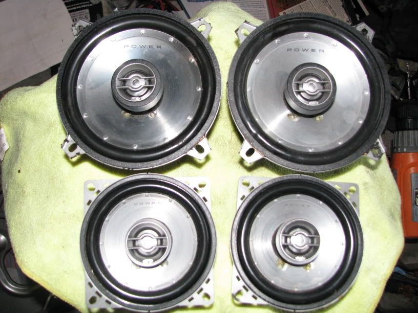

I found two pairs almost new Rockford Power Series speakers in my parts car that is ready for the junk yard. Thanks to 91MK3 for the discovery lol. Perfect for my upgrade :)
