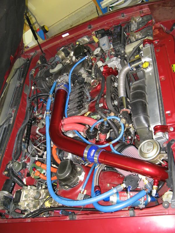

Adjuster
Ok, I'm laughing, but I still don't have my car running, and I've got nobody to blame but myself.. :)
Did some more math.. (Scary, as I'm no rocket scientist, and do not claim to be by any stretch of the imagination..)
New injectors are 780cc PTE sourced Delphi injectors.
Stock is 440cc. Denso's..
Fuel pressure being a constant... Should provide the following mainscale data.
The new injectors are 340cc larger than the old, about 77.3% larger is 340.12cc... So the mainscale reduction should be set at -77.3% right? (Assuming that it can be cut down to that, or -77% if not.)
Also, my motor displacement is 3.24L. And reading on here, I believe the TranslatorPro will accept the 3.24L info.. (Or will it just accept 3.2L?)
Speed density setup with timing monitor/control wires hooked up and boost control too.
I put the IAT sensor in the mid IC pipe from the cooler to the upper IC pipe... so should not be heat soak issues.
Also located the MAP sensor just behind the right head light, near the IAT sensor so the wires were easy to route. My vac line also has the BOV's on it, and is coming off the intake manifold at the front port where the fuel pressure regulator stock is sourced. (Appears it's down a tube cast into the manifold, so it should be a good source right?) Is the BOV's on there going to cause me grief however on the signal?
Here is a photo. The vac line going to the BOV's also has a T fitting going to the MAP sensor that is facing downward under the plastic headlight hood gasket trim. The IAT sensor is sticking out of the IC pipe right there too.
Ok, to go back over this again.
1) At idle, with the hose to the AFPR clamped shut, base fuel pressure is going to be 30psi. (Will check to make sure it's still the same as before.)
2) TPS is new with rebuild, will confirm it's adjusted right if there are issues there, but should not be. (As per TSRM for voltage.)
3) No concerns about ICS with this right? It just has a filter clamped over the intake port, and should control idle speed air like normal, and be "metered" by the speed density calculation from the Translator Pro right?
4) Have a good stock O2 sensor, in "stock" location, and PLX Wideband in another bung further down the exhaust where it's cooler. Plan on using the TCCS/Stock O2 for idle and running around, and will only tune the WOT for now with the Translator Pro. (Eventually, might use the low and mid ranges and build up the fuel map from that data, but for now, I just want to get this car running again..)
5) All other parameters as indicated in the manual/etc.
Also plan on running the latest 4.8 version of the software, and have the 4.4 version of the User Manual and 4.80 Online guide/worksheet to take notes and keep reccords..
Anything I'm missing? :)

no way in hell id take 77% out of mainscale. that would screw your timing map and run extremely high timing. remember, mainscale is cumulative, so any corrections you have at rpm are going to be added to -77% which would make things that much worse.
also, you would probably be better off by using a lower displacement. on my car and all the others i have tuned i use 2.9 as the displacement. it shifts the map slightly it seems, and technically stock it isnt a true 3.0.
i would do as much bulk tuning as i could with the fuel pressure. the pte's will run fine down to about 26psi bfp.
lastly, ive had the best luck out of version 4.65. i never could get 4.8 to run that smooth, even with the part throttle correction turned off.
