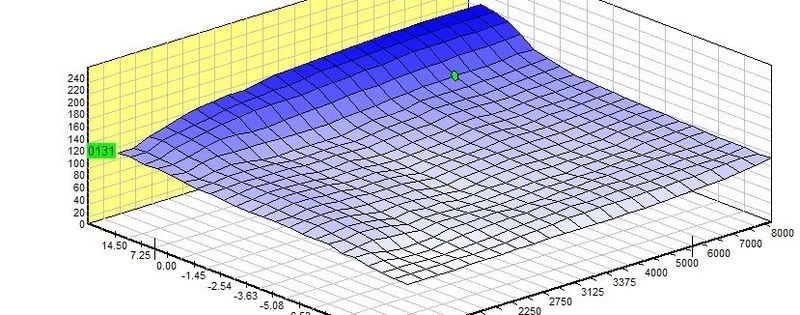

Problem Found!!! Stop the thread! :p
Look what's happening at 19psi! It's going to run way too rich and bog, causing the lack of boost. These maps are very critical to engine performance, the engine is going to run how the map looks, terrible.

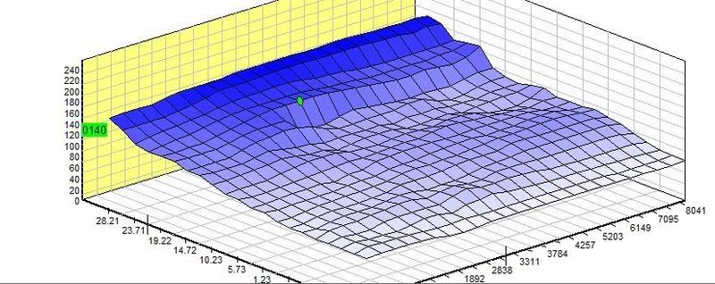

Here's what my map I made for my car in Vegas looks like for comparison.
Keep in mind I made this while driving on the freeway, so it's not perfect, I needed to add resolution under vacuum to get rid of a little lean spot that happened when it was at cruise speed on the freeway. Notice there's no huge changes anywhere from one map point to another, except between 0psi and 14psi. Also, consider that I was only running 380cc stock injectors, so I needed to max them out under boost because I'm running a GT4082 turbo, which means all my map points under boost look more dramatic then yours would on a 3d map. You have much bigger injectors, so a huge change like your map has would probably add far more fuel then the engine needs.
I see what's happening @ 19psi Aaron, but I"m never reaching that point. I have my boost cut set @ 19 psi and it's never once reached it. I couldn't tune it for 19psi since it never made it up that high in boost. We tried adjusting the AVC-R to make it run higher boost and it just wouldn't do it. It loses it and it drops down to 10psi. If it would make higher boost, wouldn't it just go rich on the dyno?
I corrected my timing map and my fuel map to make them look more presentable. I took the peaks and valleys out made it look more like the one Aaron made. I took it for a drive and the same thing happens. At 6400rpm it went from 16psi to 9 psi, but the afr's never changed from 11.6..... Here is what the tune looks like now.
If someone can copy it and paste it on here, please do. I dont' know how to copy the picture like Aaron did.
