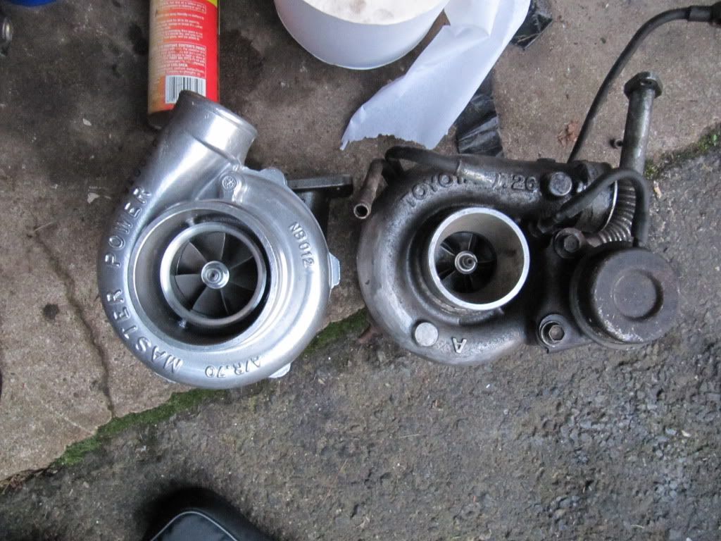

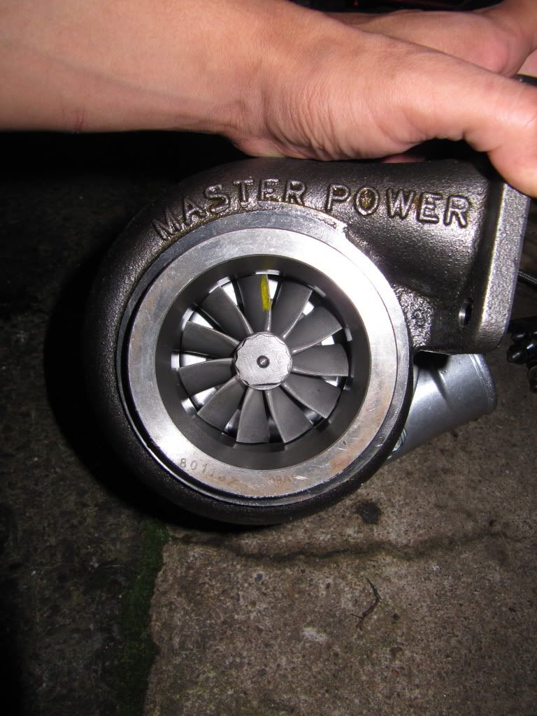

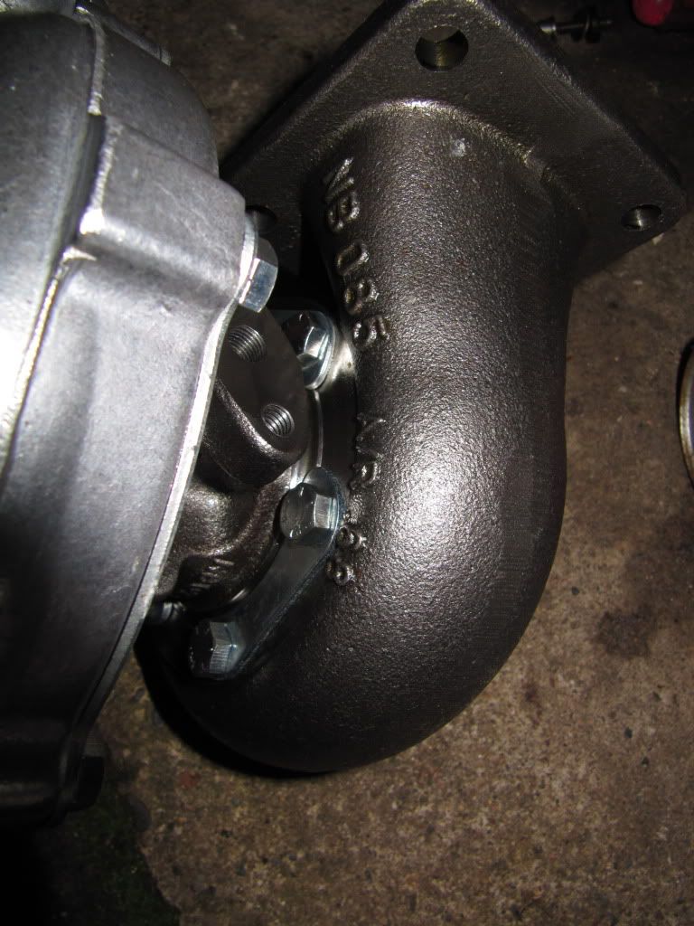

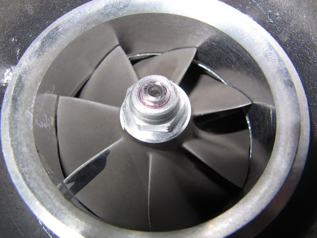

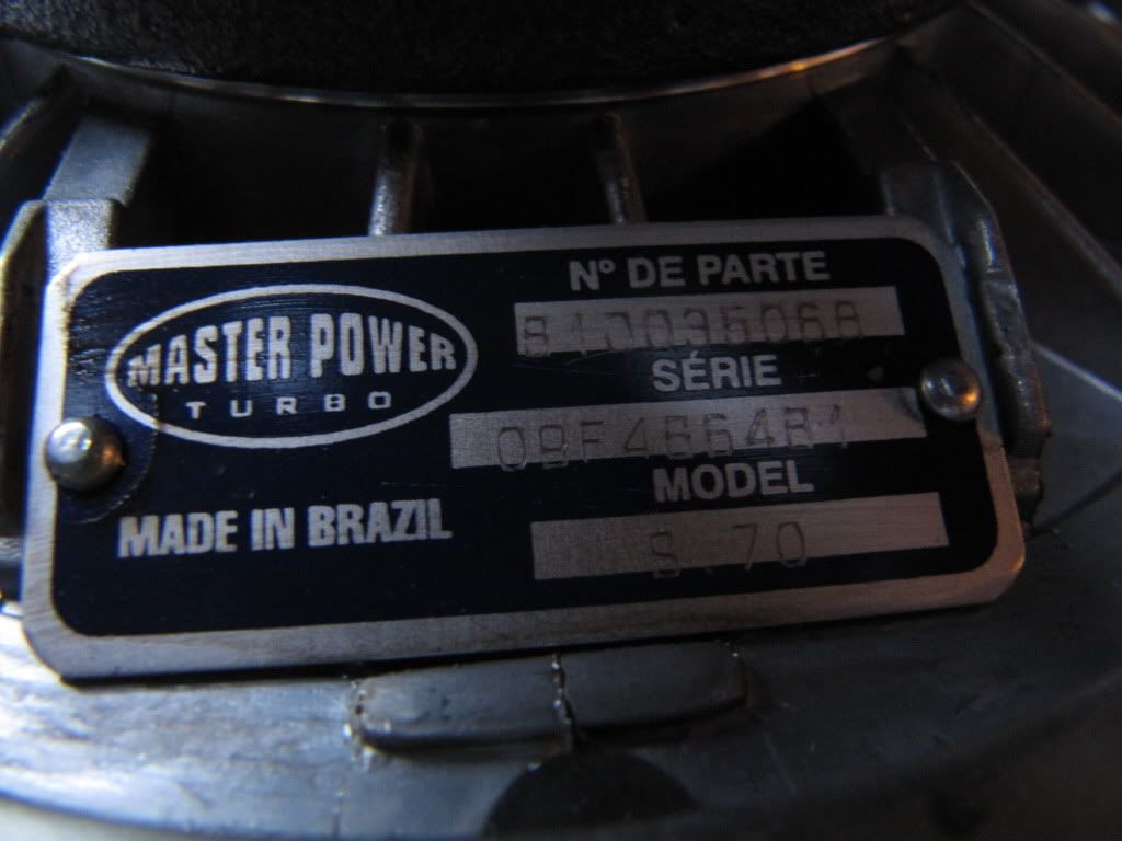

I dont know about you guys but the best part of any build..... THE TURBO!!!!
it finally came in today, and instead of the t-64 i ordered, i was sent a t-66. eh, i'll settle for it. its a Master Power t-66 with the same .68 a/r i wanted. with a .70 compressor housing. so it looks just like a t-70.

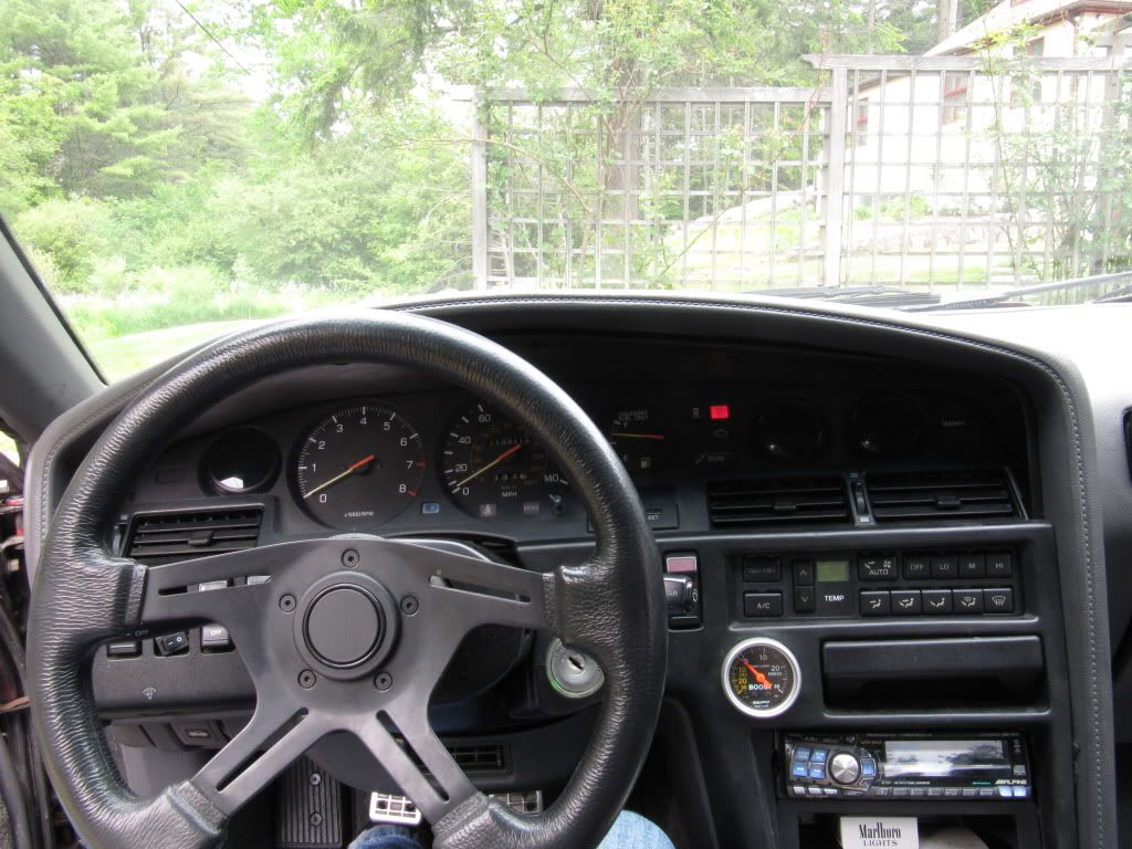

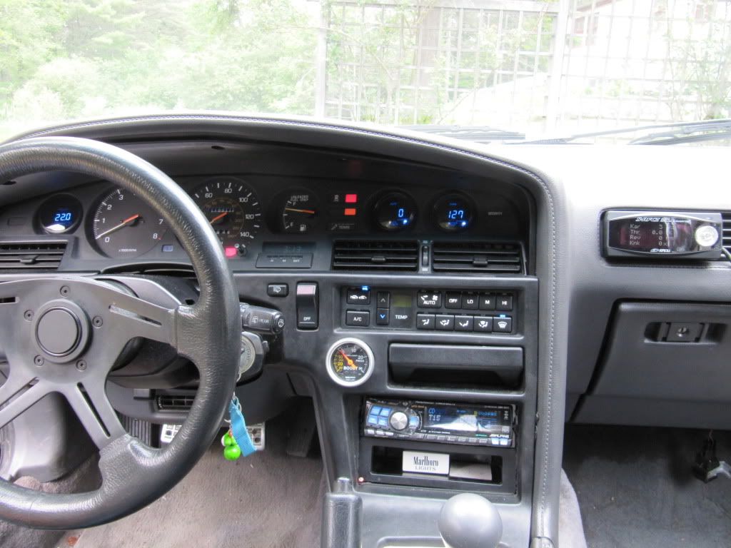

well onto the pics. threw in a couple of the gauges too.

im pretty sure the manifold will be in monday, then after that, all i need the the oil fitting/flange for feed and drain for turbo.
the gauges are some no name hong kong china brand... they not accurate worth shit... i'll be swappin em out for some balck needle gauges and just light them with blue LEDs.
can't really tell in that pic either but i did the climate contorl w/ white n blue LED's.

rayall01;1353134 said:
Where the fuck did you get those gauges? How hard was the conversion?

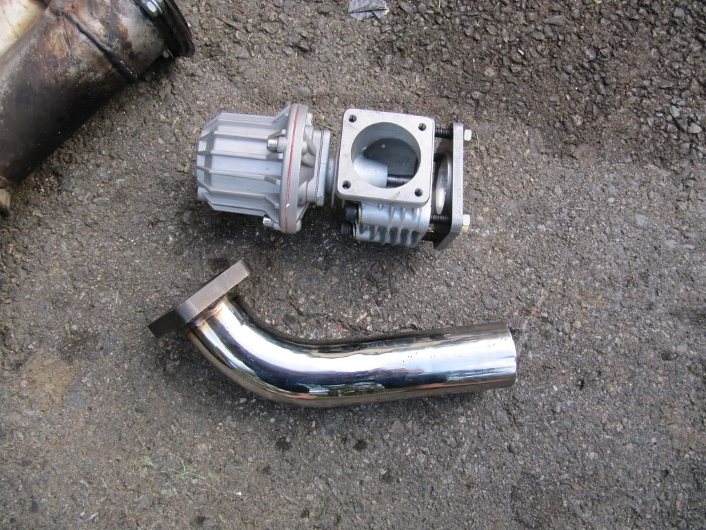

everything on my car cam from either another supra owner, junkyard, or ebay. turbo came from ebay $570 shipped. wg and dump tube were 75 shipped. the gauges i got from hong kong for $66 shipped for both of them. but they're highly innacurate. eventually i will switch to a name brand LED display but for now im gonna go back to needle gauges.
the conversion was fairly simple, some 1/8" lexan sprayed black trimmed to size (to fill the gap left by the gauges.) and a 2" holesaw. used a dremel to open the hole a teeny bit more but left it so the gagues stay snug. i can get some closer pics if you'd like.
