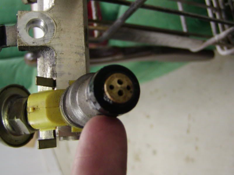

UPDATE....My Crank is STILL on the way but i got my block back and i've started to clean the head PICS! PICS! PICS1!!!!This is not my normal camera so sorry if not as good...:)

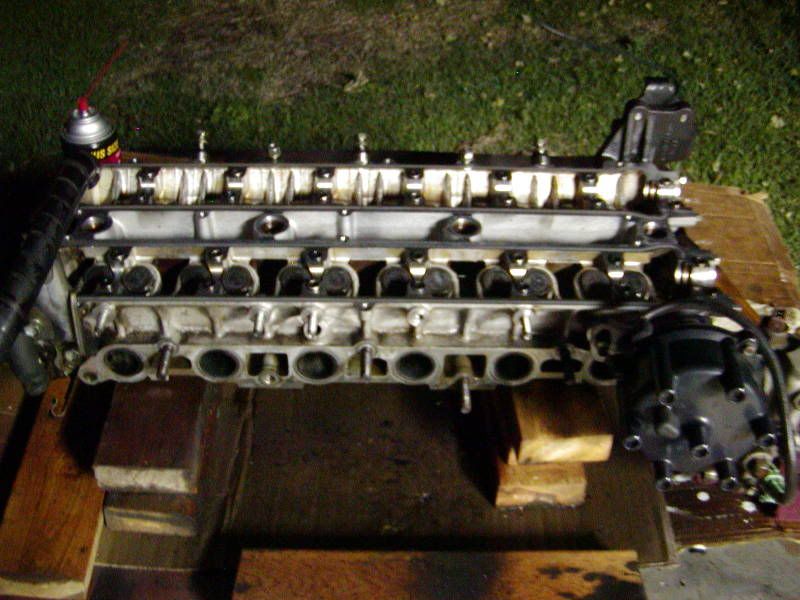

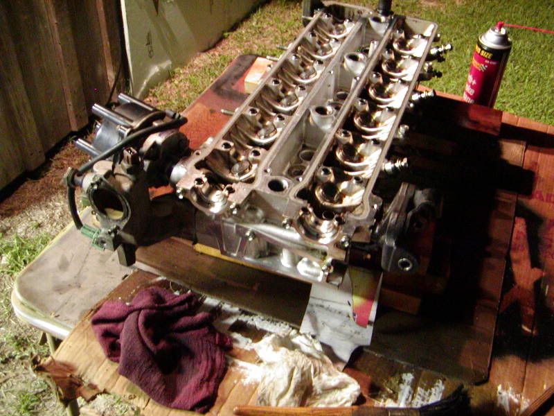

Cleaning the head
Front side

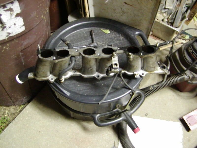

Bottom part of intake ready for cleaning

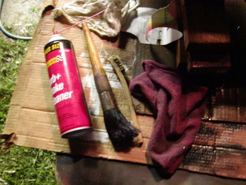

Cleaning utensils

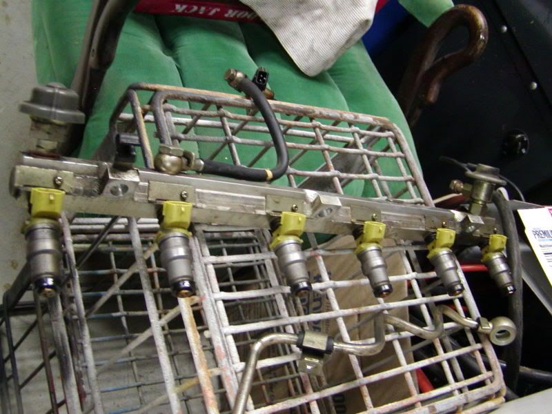

Fuel Injector next to pointer finger
Fuel Injectors after removal

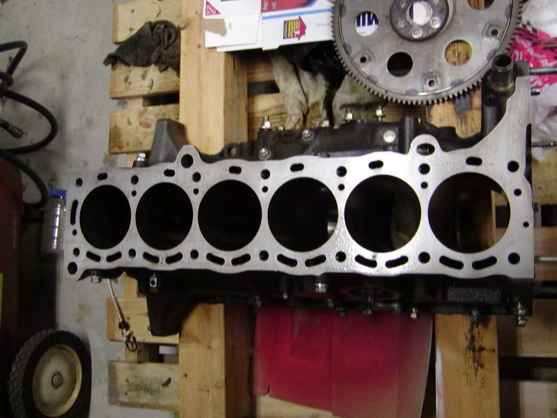

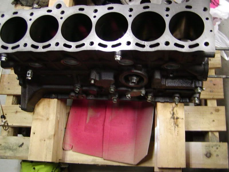

Block before machine shop

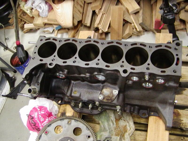

Here is a few pics of the block after the machine shop(140$ for resurface on the top of block, engine wash, new freeze plugs and new oil shaft bearing in the front)

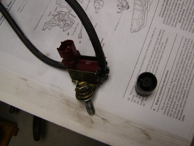

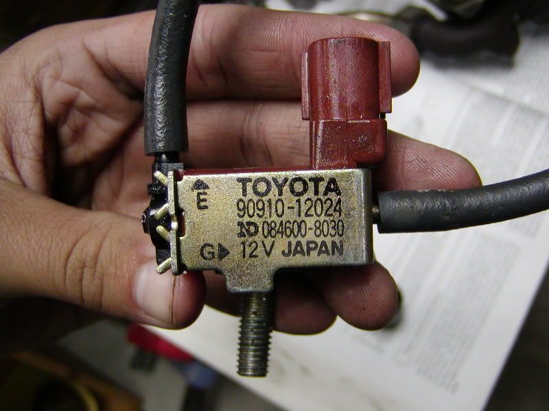

Piece i broke when i was taking out engine(what the hell is this)

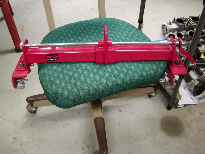

My engine load shifter that goes on lift to change the angle of the engine as it goes into the engine bay...says 750 lb limit...plus i did some modification...had some shitty chain and hook on it....put some heavy duty hooks on it...:)

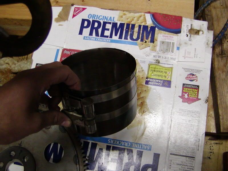

Found some type of piston ring compactor from back in the day....Still works!!!

Just curious...i was going to get a Metal Head Gasket and i don't know what size to get...I think He said he took off 9 thousandths...what is the max u can resurface a 7m block?....and what size gasket should i get?

whats the stock mm head gasket 1.2? and how did you figure out that i needed 2.mm? SHould i go Hks or greddy mhg?...Also arp head bolts? What rings should i get?....i'm asking these questions because i'm going to order all in one BIG order from horsepowerFreaks so i don't waste time...LOL...

I bought an upper gasket set and took that head gasket and had it measured at 0.76. I had 7 thousandths of metal removed from my head. You had a bit more so I hypothesize 2.mm . Dave will sort it out no doubt for sure he's the guy that did my math, lol.

i talked to the guy Dave, SUPRA NICE GUY(HA HA i made a funny), at HPF......he told me i needed a 1.5 head gasket and recommended a greddy one...he is going to send me a estimate for arp bolts(which he said he wasn't sure if the arp bolts for a 7mgte would work for the ge but i'm pretty sure they would...i mean same block correct?) Head gasket, and oem rings...
