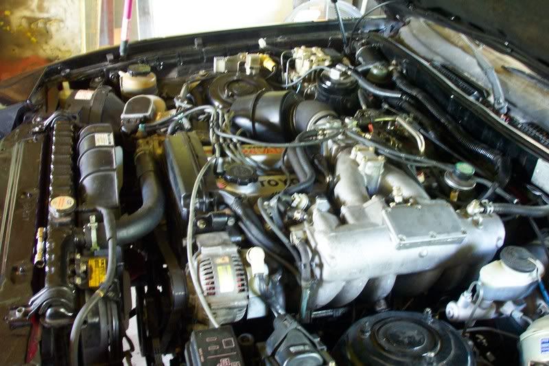

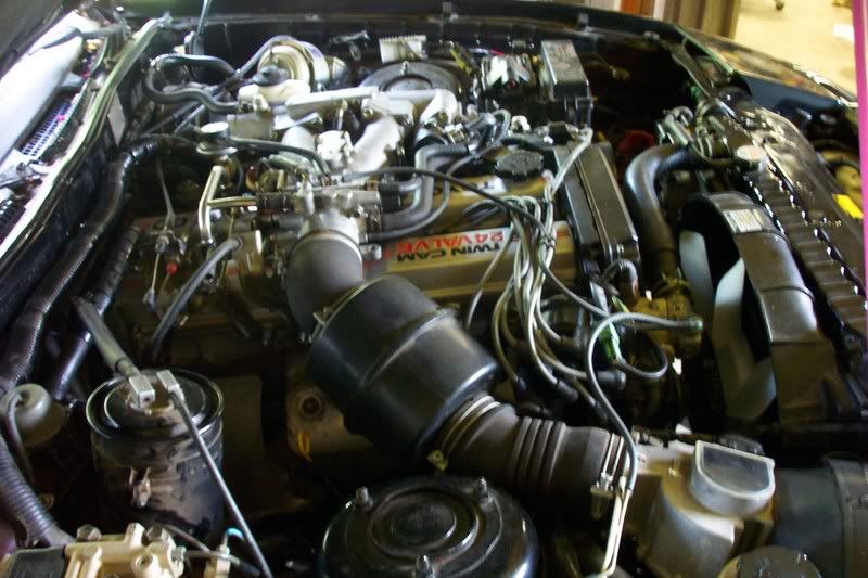

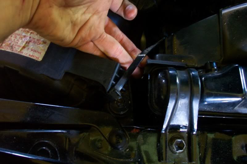

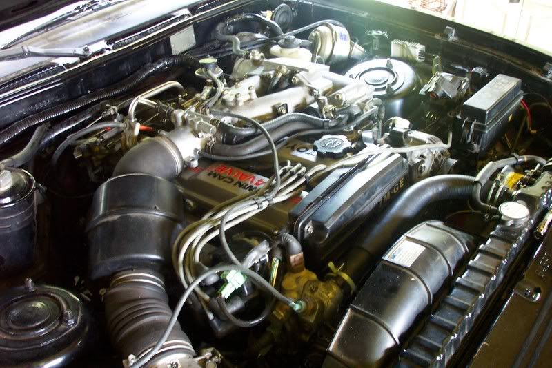

Here is some updated photos!!!! I forgot about em...lol
Tie Wrap...WHOOT!....thats jdm...lol...
