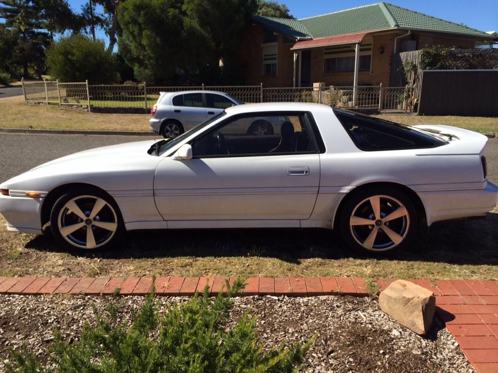

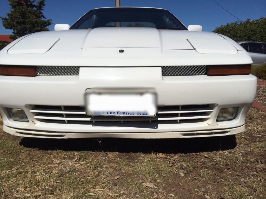

Here are some photos of the car as purchased. Previous owner may be reading. It was not in the best shape, but was accurately described and fairly priced.
DeSloth
Jun 24, 2007
220
Australia
Wheels are not to my taste either.

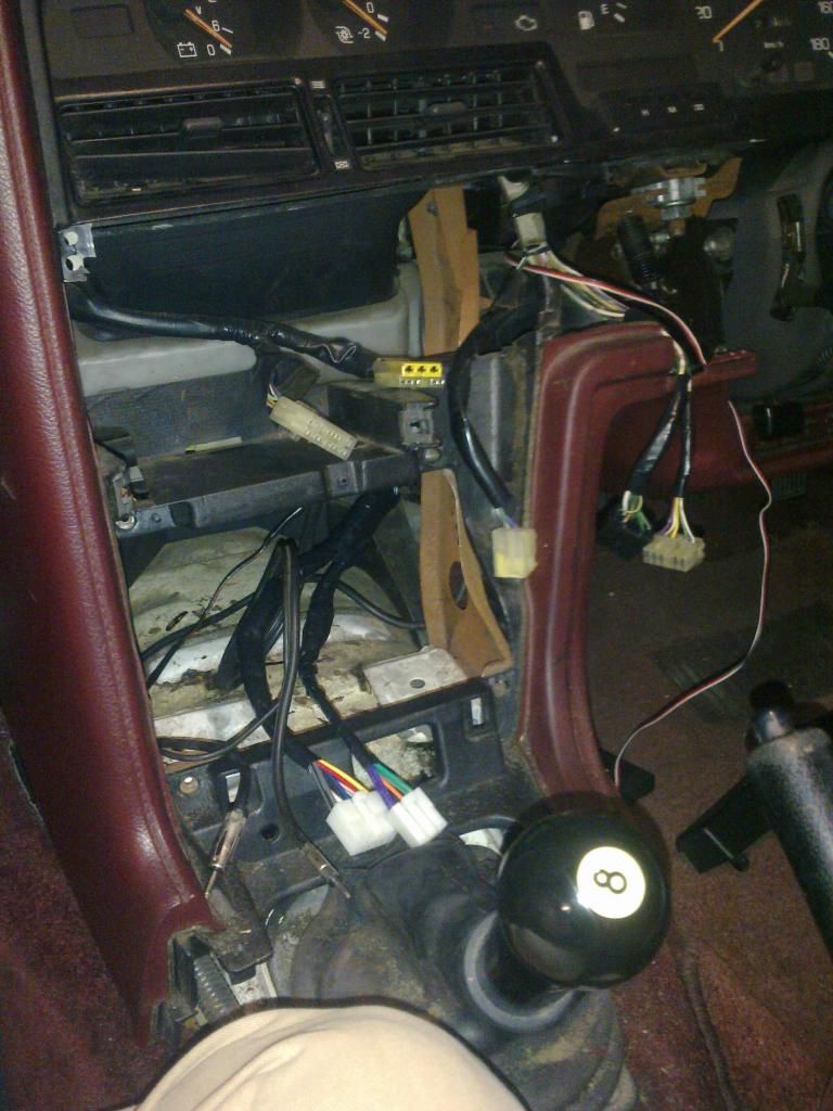

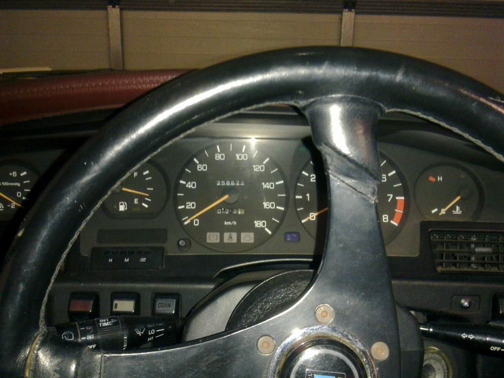

Car arrived with an aftermarket steering wheel, pre 89 indicator stalks, and 23 km put on it by the shipping company.

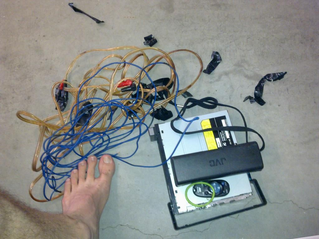

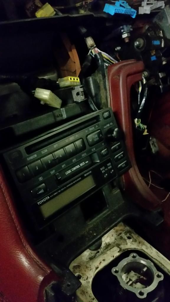

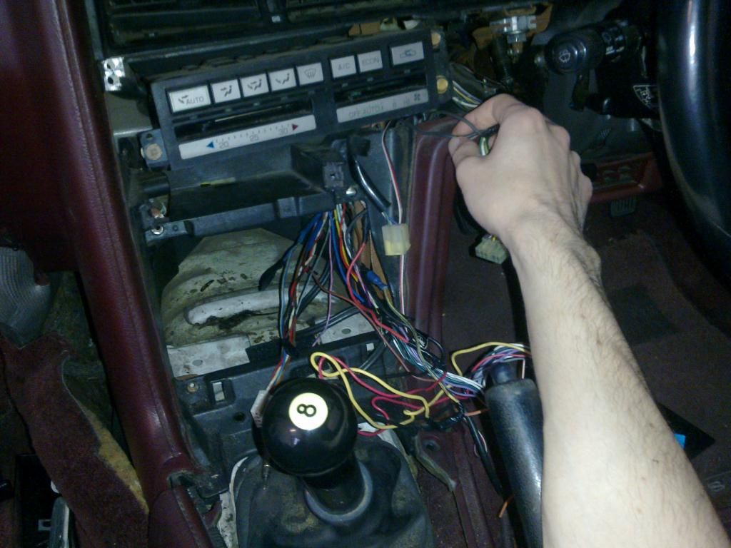

Also a radio wiring rats nest
So I bought a OEM pioneer radio (JDM period correct) and fixed up the wiring. Out with the old
In with the new

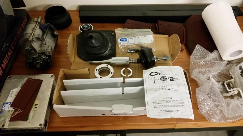

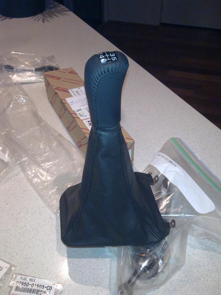

Pool ball shifter wasn't really... my thing. Also bushings etc were completely flogged out. So I bought a new shifter, bushes, gear knob and leather boot.
And a C's shifter

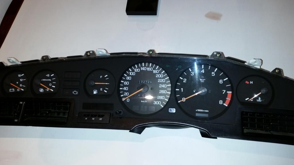

Being a JDM only model, the JZA70 came speed limited to 180 km/hr, also maximum indication on the dashboard. Couldn't handle that so obtained a k's 300 meter. Colour matches better in real life.

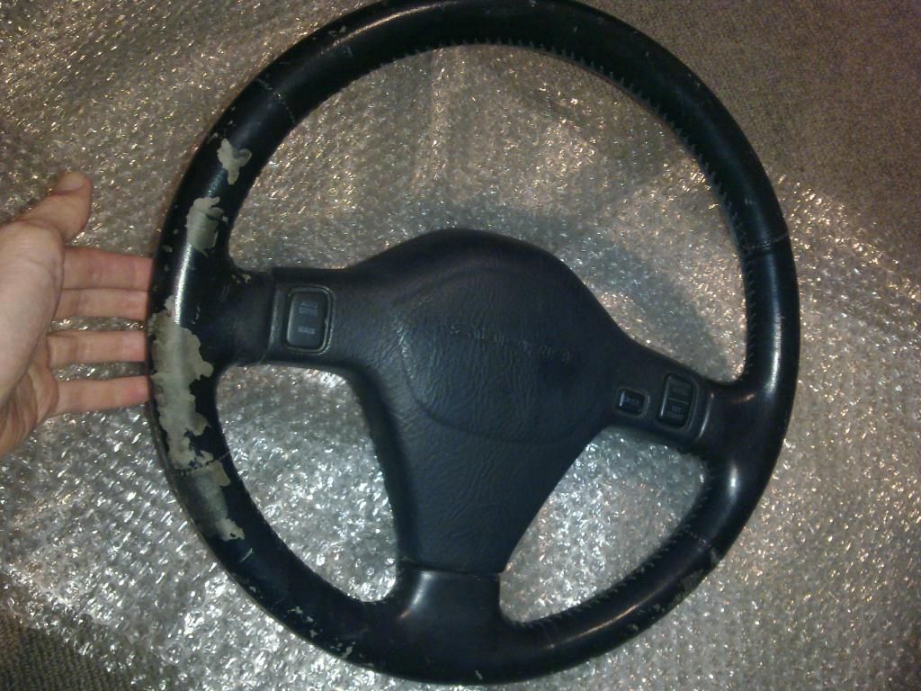

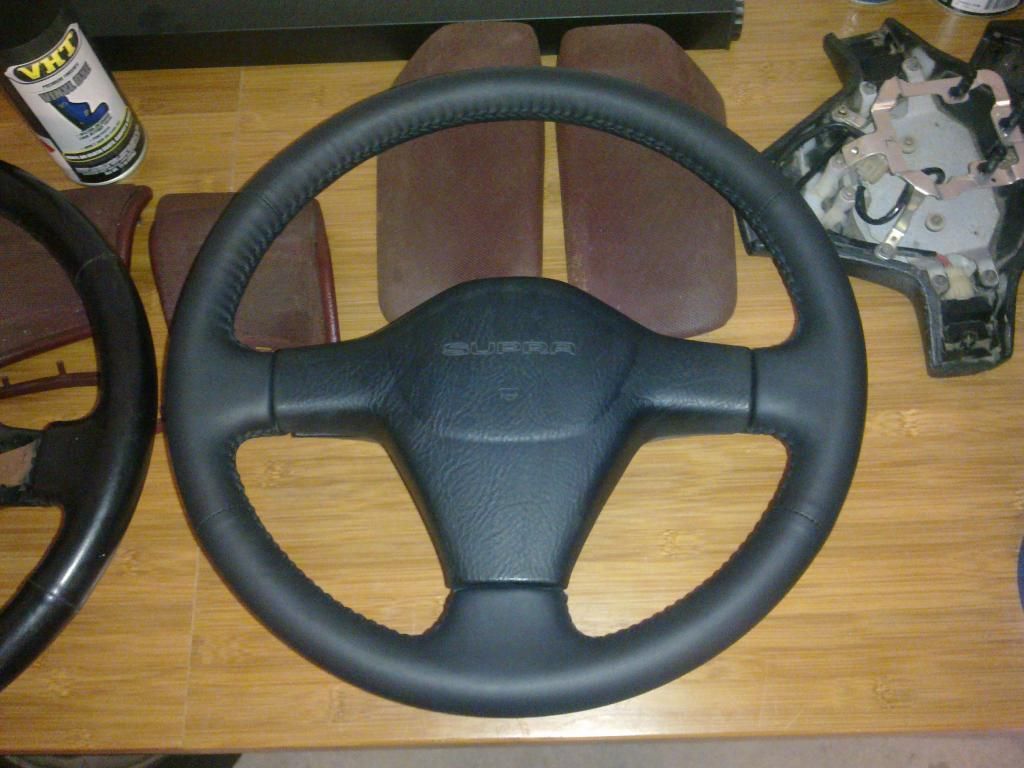

Aftermarket wheel also had to go. So I bought a used OEM wheel.
And got it professionally recovered. No cruise control was fitted to this car, so finding a non-cruise horn pad was a bit of a mission.

Silent Deatz;2034110 said:
Oh It's still possible to buy a new lether boot?
Not a Toyota item, though it looks like it might be. Full grain leather from an ebay seller from Surrey in the UK. I bought the same gaiter and handbrake boot from him in 2007 for my previous Supra, and they were in perfect shape 5 years later when I sold the car (daily driven).
Oh It's still possible to buy a new lether boot? How much did you pay for a new one?
Look up Redline Leather Goods. They do amazing leather work, and they're in Poland, so they're closer to you than us over there in the US. I'm really happy with their products in my Supra.

Hybrid;2034124 said:
Curt can still supply new shifter boots (black only)
Curt Aigner from Elmhurst Toyota, great service and very good prices as a bonus.
Here's another photo of the gear boot, it looks OEM and better quality in my opinion.

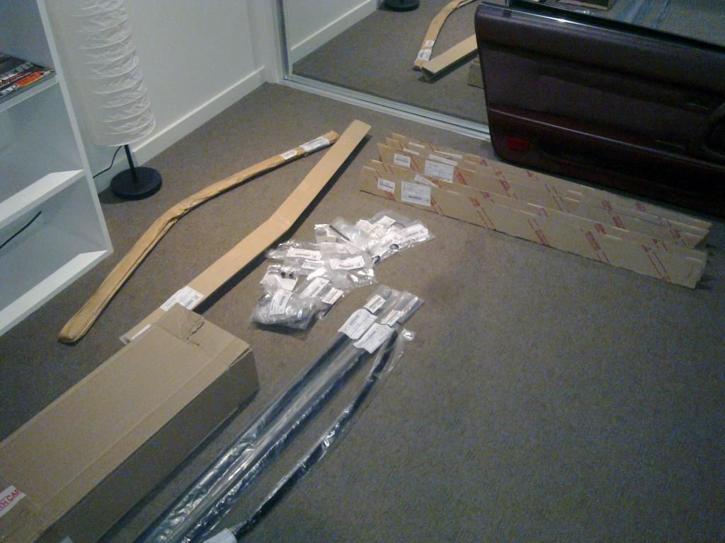

And all new exterior trims
Except for the LHS window ventilation louver. If you have a new one to suit hardtop, or a pair, please let me know!

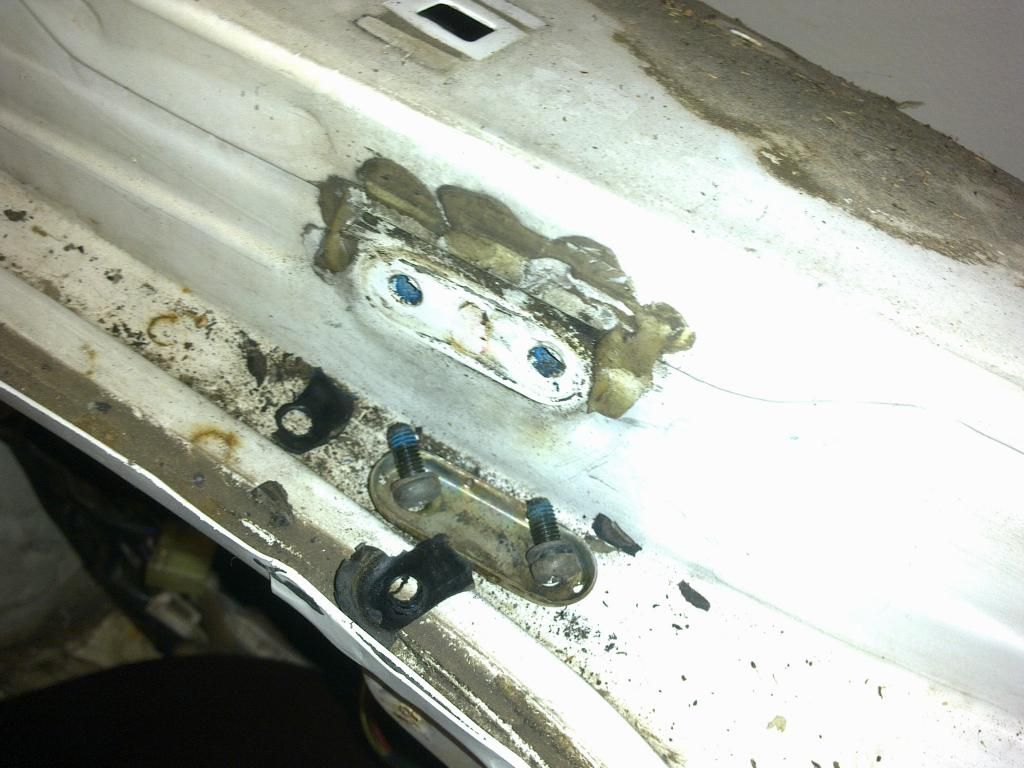

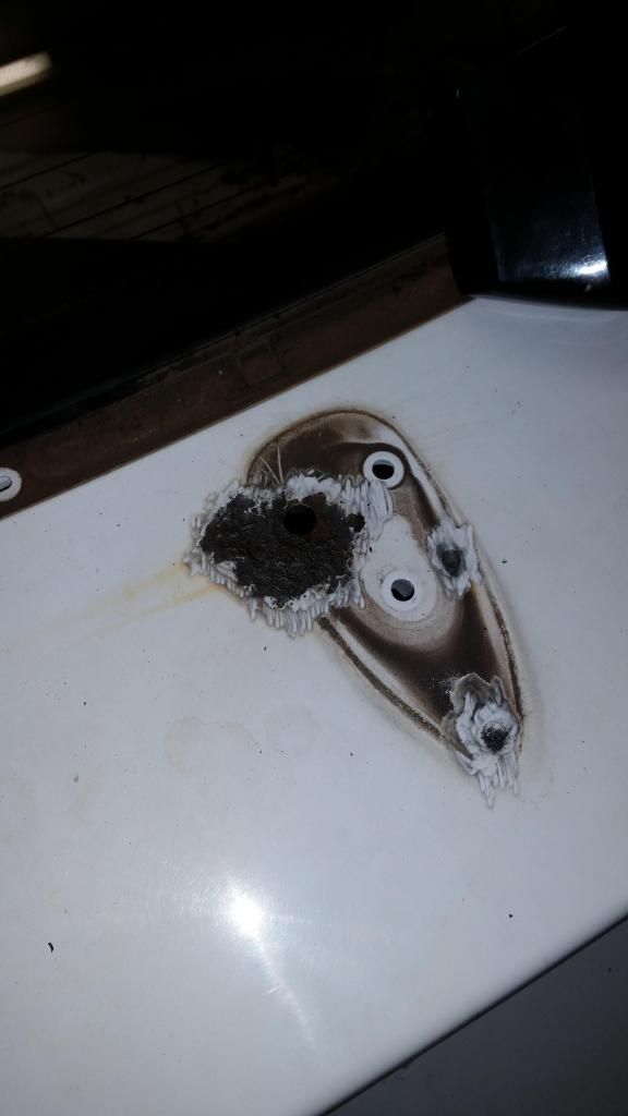

For reasons unclear to me, compliance workshops were required to replace all the Japanese seatbelts before the car could be registered in Australia. For the rear, they accomplished this by bolting pointy head-height brackets with NEW holes in the drilled through the chassis and quarter window interior plastics... really safe. The old belts were just cut off. Insane and ugly.

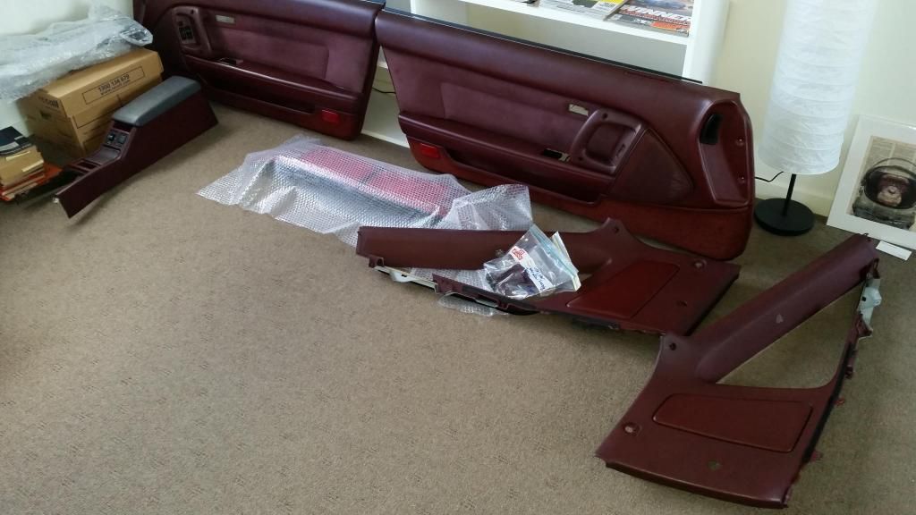

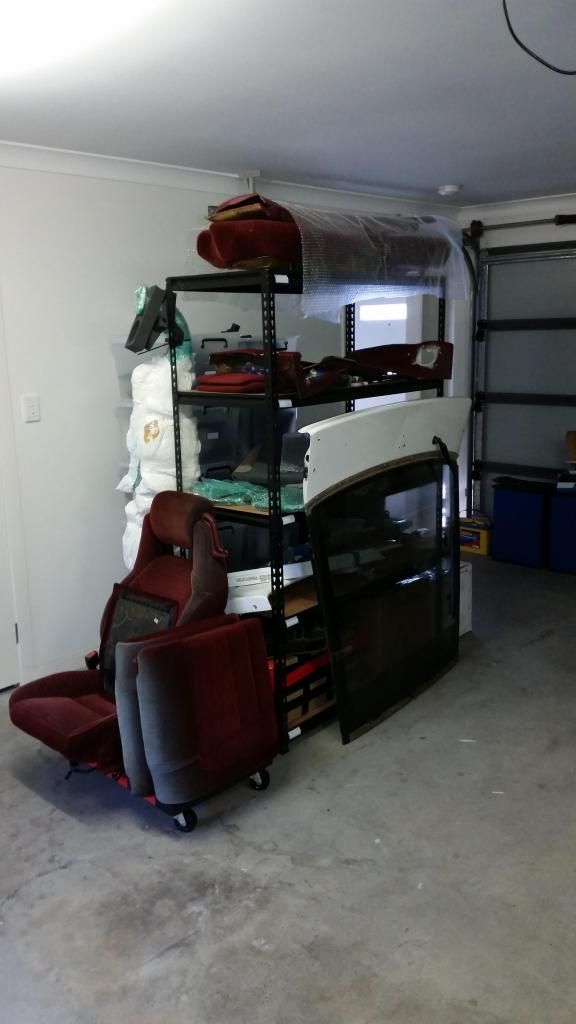

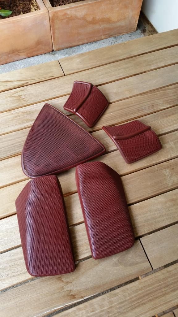

Anyway, I needed a lot of new plastics including above quarter trims, hatch deck, and door trims. These were very, very hard to find.
Still looking for hardtop boot plastics, centre console, dashboard, and dashboard under plastics. Colour is 'deep red', not oxblood / burgundy.

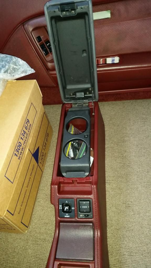

I sort-of fixed the existing centre console, and bought some cupholders.
Would like to buy a centre console pocket in deep red if anyone has one (with spring lid adjacent the mirror and seat control buttons).

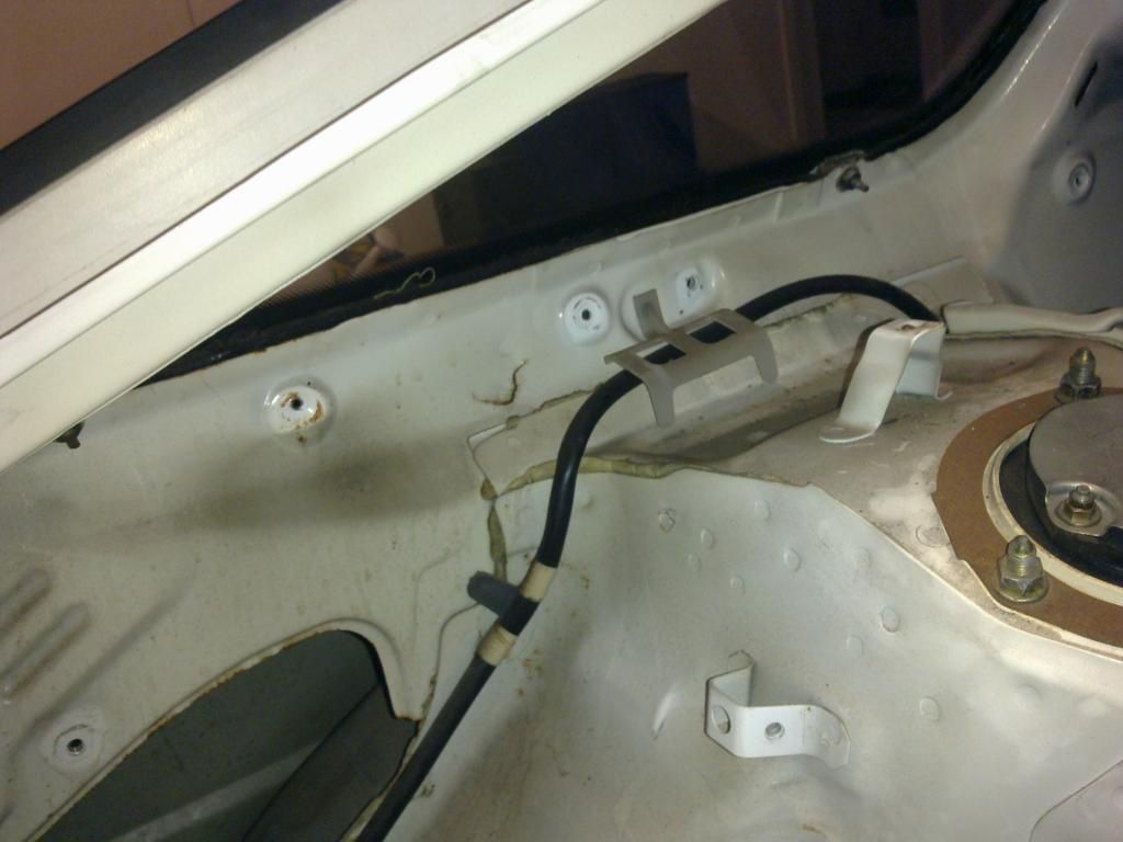

So I've found some cracks under the quarter glass windows. Both sides are the same.
My previous car had similar cracks in the same location.
Jumping to 'a' potential cause here, but both this JZA70 and my previous MA70 were fitted with stiffer than stock aftermarket suspension.
Does anyone have any advice? Seen these before? What caused it? Should I weld them up, or drill out the crack tips and leave them alone?
Here I pushed a cable tie through the crack and took a photo from the rear of the panel

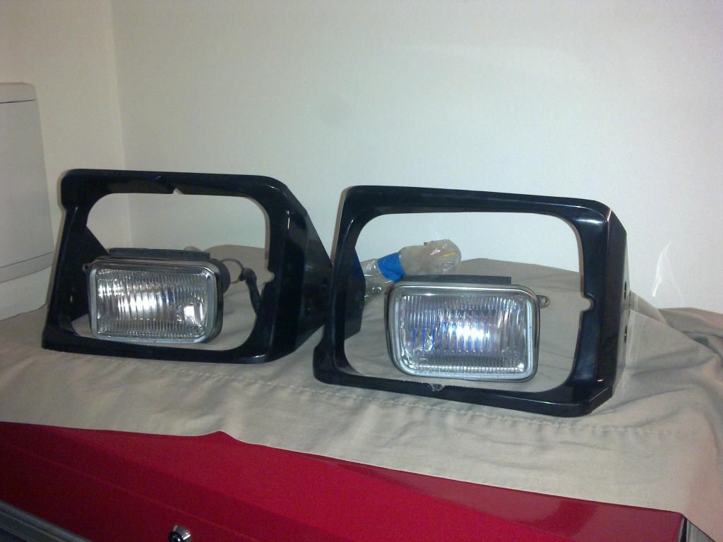

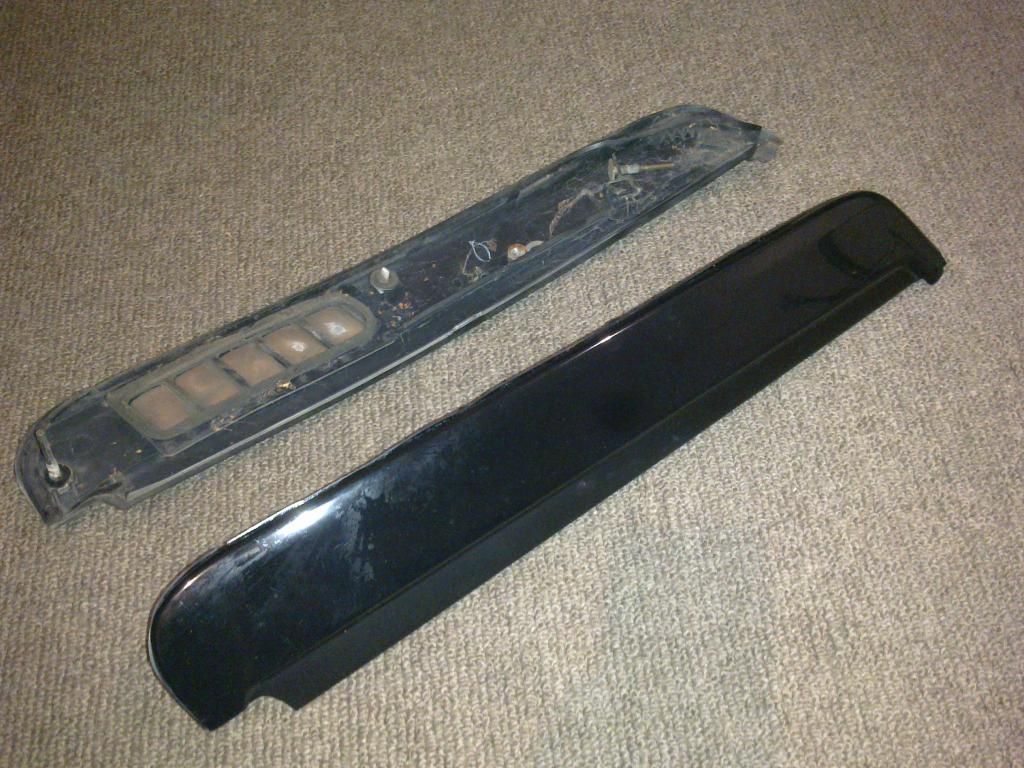

Polished up headlight / foglight plastics and chrome

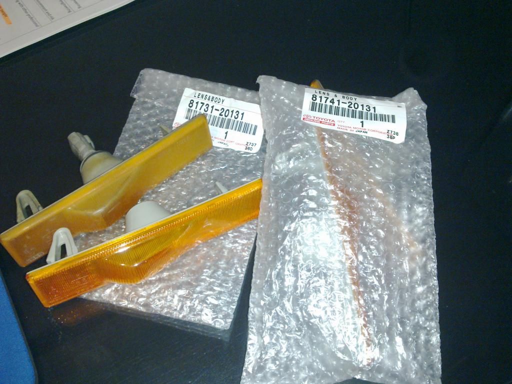

Purchased new side indicators. Comparison with old shown

My car had the exact same thing done with the rear seat belts, and those new hole are being welded up as part of the tidy up of the car
Whats interesting is your car being such a late build probably had over the shoulder belts in Japan anyway, the earlier ones had lap belts so was a given they had to be changed, but either way something that meets our ADRs is needed
Klippan who made the awful rear belts make another model that you can set up as per the factory belts, I forget the part number but another guy here had his car complied locally under the 15 year rule and they looked alot better, my guess is your car was imported in WA like mine to have those seat belts
Yes had shoulder belts from Japan, identical setup to my 1989 Australian MA70. These folks took out something safe, and replaced with items that... weren't.

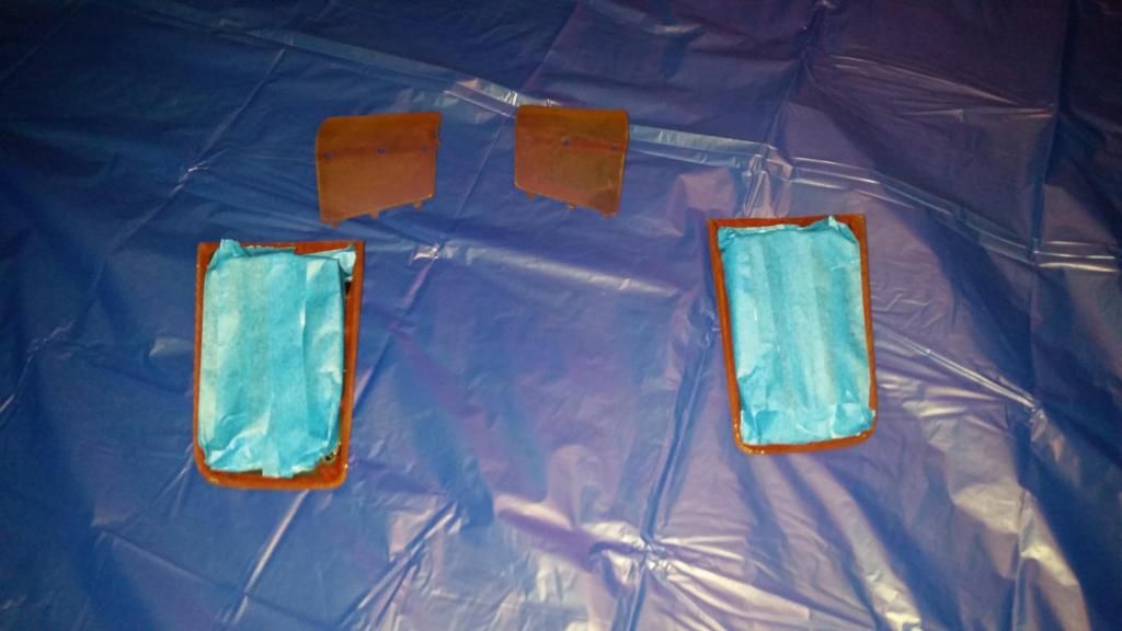

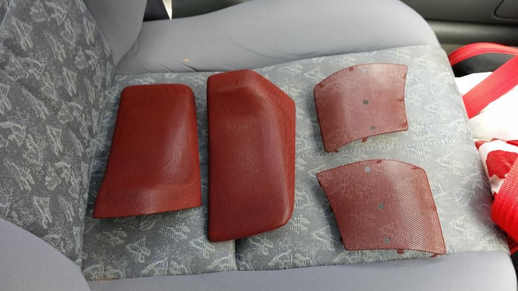

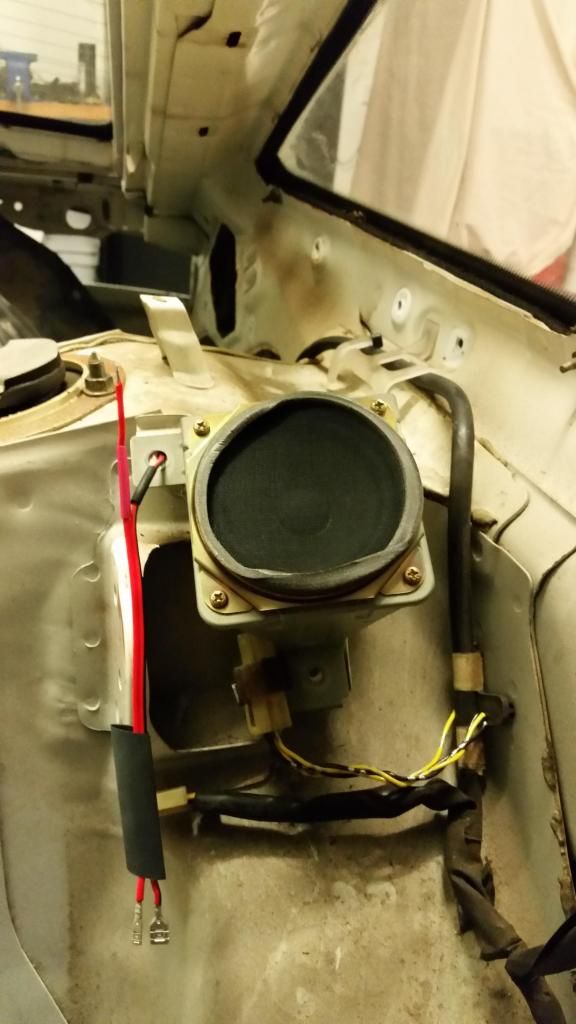

Small update, yesterday I painted my faded and rusty rear speaker grills. Due to the above mentioned seatbelt installation, water had dripped on them and they got messed up over time.
JZA70 rear speaker

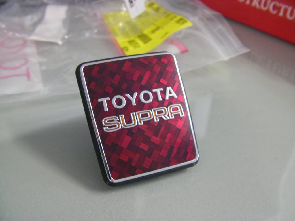

New front emblem :)

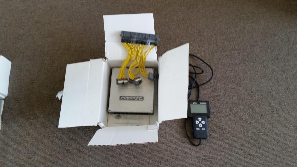

Big thanks to Hybrid, APEXi Power FC ECU - plug and play for JZA70.
A 415-A003 Power FC boost control kit also ordered and on its way

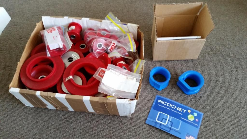

RonnieK bushing kit I've had for a few years.
Steering rack bushes were installed into my previous car, so bought some others to make up the full set.
Silver MK3
Jan 24, 2011
1,517
Madison, AL
Good choice on the Ricochet bushings. I've got them and they've been great so far. It's a little difficult to get the brackets to come down over the new poly bushings though because they're so much stiffer and not worn out like the old ones.
