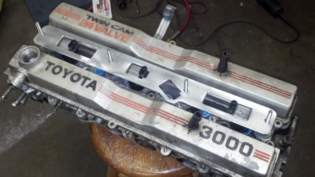

I got this far, then realized how the coil was actually captured on top and I moved the hole to much. Ill setup later and make the hole larger and maybe even grind my head to exact hole placement then cut another for ya.

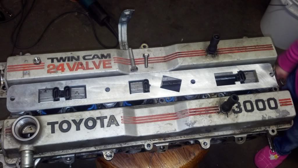

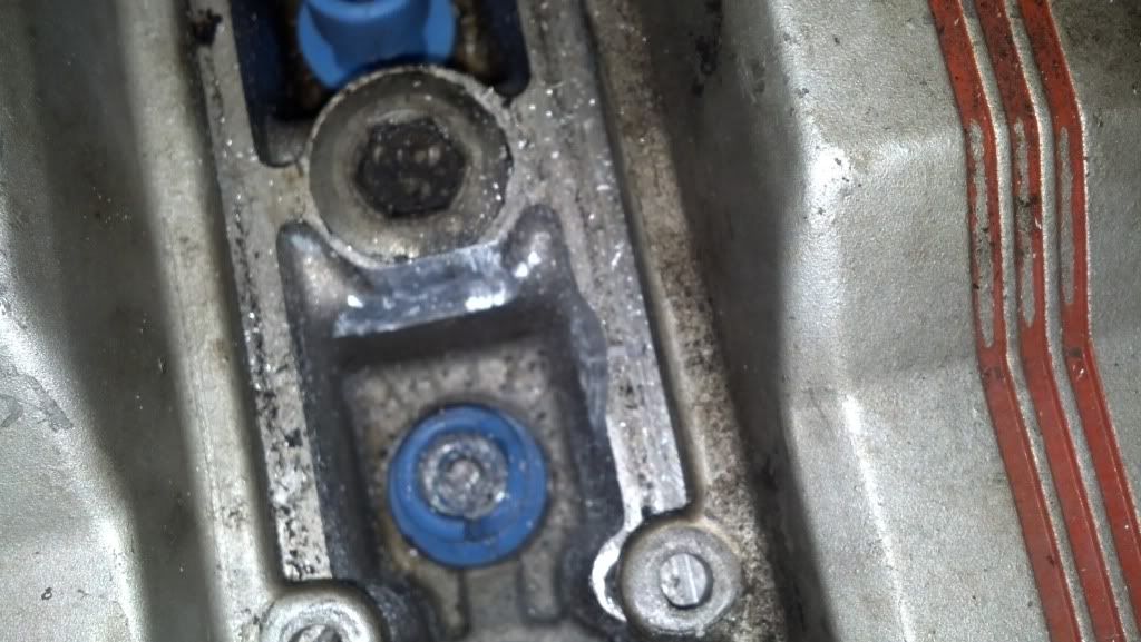

I need to move one hole, just going to weld it up and relocate. I need to make a wee bit more room for the plugs to come off without taking the cover off and deburr it. I looks like it will work just fine, its hard to tell with just 4 coils and no mount studs. Ill grab a few bolts tomorrow and try them out.

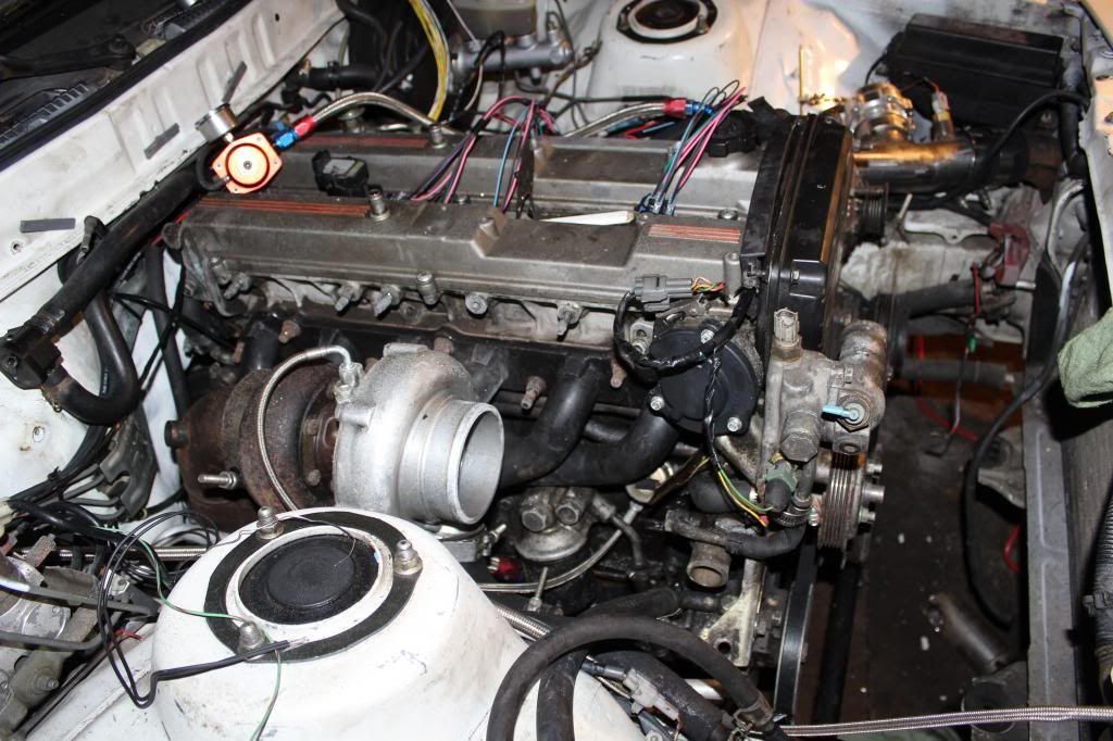

Tonight I ran battery cables and hooked them up(not to the battery yet)
Got throttle sorted out, began putting stuff back together...
All I am waiting on now is my injectors which shipped out today ups says they are arriving Monday,
a ton of random cosmetic stuff,
And putting the car back together (fenders, interior, bumper, ect)

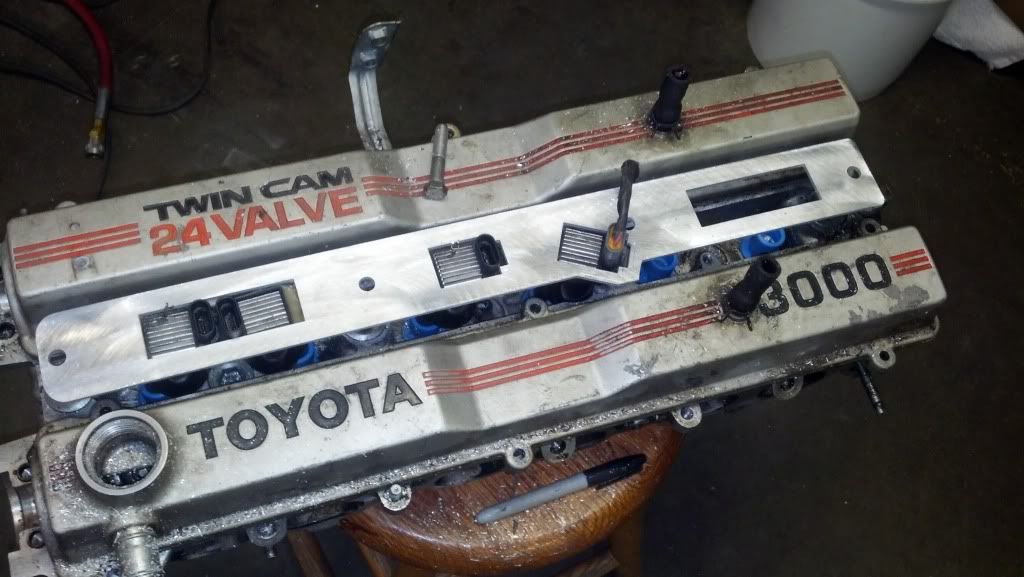

I got busy the past couple nights. I have the coil spacers made, just need to weld them in, then send this your way for final fit/fitment.

Wired in turbo timer and check engine light last night double checking through tunerstudio that there aren't any other options I want to run wires for before I put the dash back together
Ps. Yes I know that the turbo timer is not necessary however cool factor+voltage gauge+the fact that I already had it = run it
