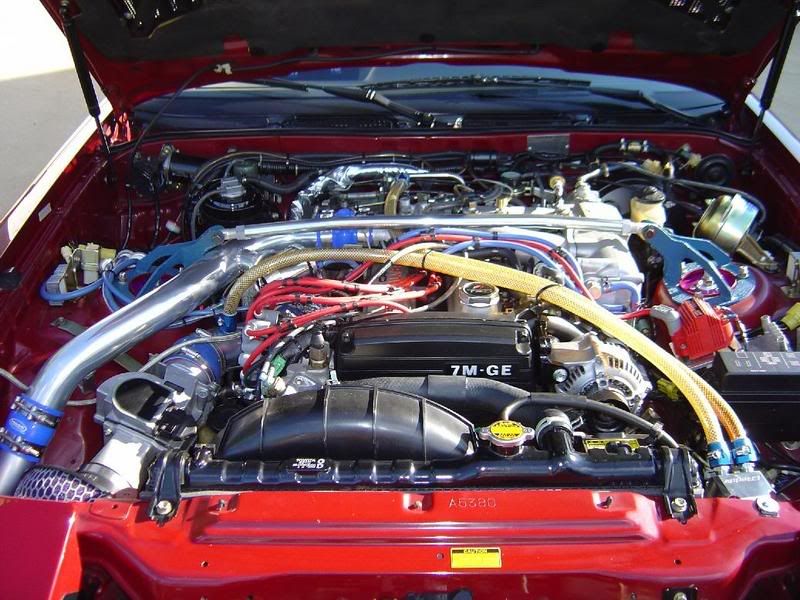

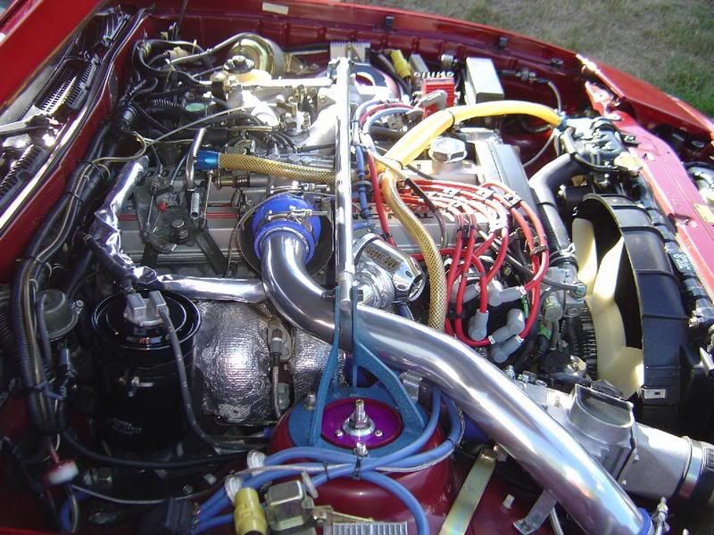

The Eclipse is my wife's. And there is an HKS intercooler along with an HKS oil cooler behind my grill. If you look close you will see a silver powdercoated intercooler pipe on the passenger side of the lower grill. The car is very strong.

Maybe you could post a quick run down of the engine specs? I love to see NA-T conversions! I jsut completed mine :)

HKS 3mm steel. Brings me to 8.5 compression,

Garret TO4B 57 Trim. .70 AR. I'm running a 4.30 rear axle so lighting up the tires is pretty common even in second gear.. I love the combo. I've smoked mid 12 second cars from a roll with ease. Very usable power band on the street.

The power band is very linear. Damn near like an NA. I am really happy with it. Thats why I haven't done something over the top at this point. Additionally, you should hear the Goliath under boost. Oh My God. Pure Sex!
