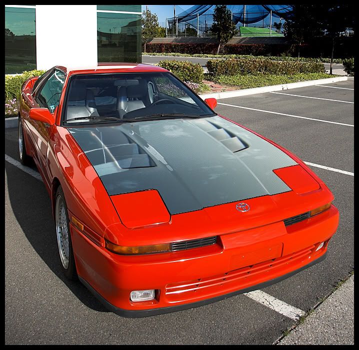

I has pics for one for the mk2, but this is mostly a mk3 forum, so you see which one got put up... lol
