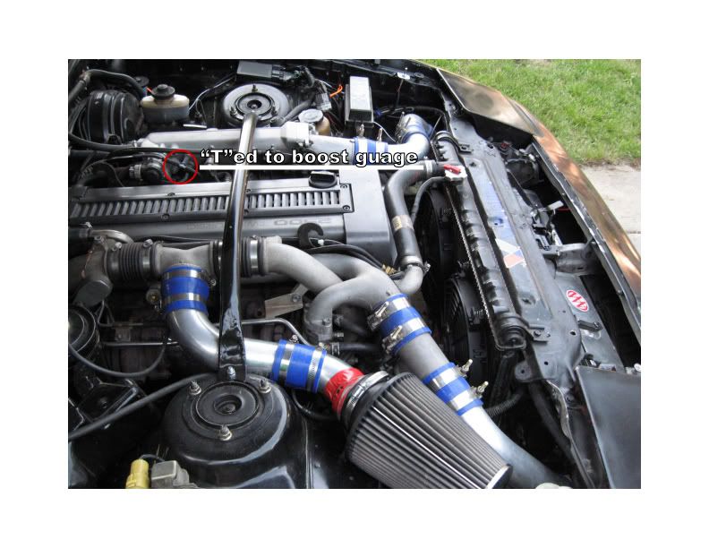

i was under the impression that 9psi is stock boost? do you have a completely stock car?
3" ypipe and down pipe, intake, 255 feul pump, 2.5" hard pipes, HKS BOV, and 3" 24" FMIC!!!:nono:
I would sujest looking for boost leaks, damaged turbos, restrictions and do you have a cat? With the same mods I was getting 1.1bar with out a boost controler.

Cat: yes,
Boost controller: i tried everything, and every setting on one and all i get is spiking boost and fuel cut!
Boost gauge connect: (oops spelling:nono:)

viperkillertt;1079263 said:
what!!! You are boosting 16lbs on a stock car? First, that is unsafe for the stock turbos and i dont understand. Your stock spring must have been changed to stop the wastegate from opening at a lower psi
Yes I was and how is it unsafe if I have the fuel? Were did you I say it was all stock? When I put on the Profec-B I was running 18-19 psi on the stock turbos with out any problems(over a year). Once they started smoking I went to a large single and ran that at 24psi and 550whp. Toyota Ceramic turbos are no were near as sensitive as Nissan ones.
If you have a free flowing Y pipe and a no other restrictions you should see anywere from 13-16psi with out a boost controler. I had to install a FCD after I installed the y pipe and exhaust. I also had a S-AFC so I was able to controle the fuel.
Try taking the cat out and see if that makes a diffrence.
Edit: what exhaust do you have?
