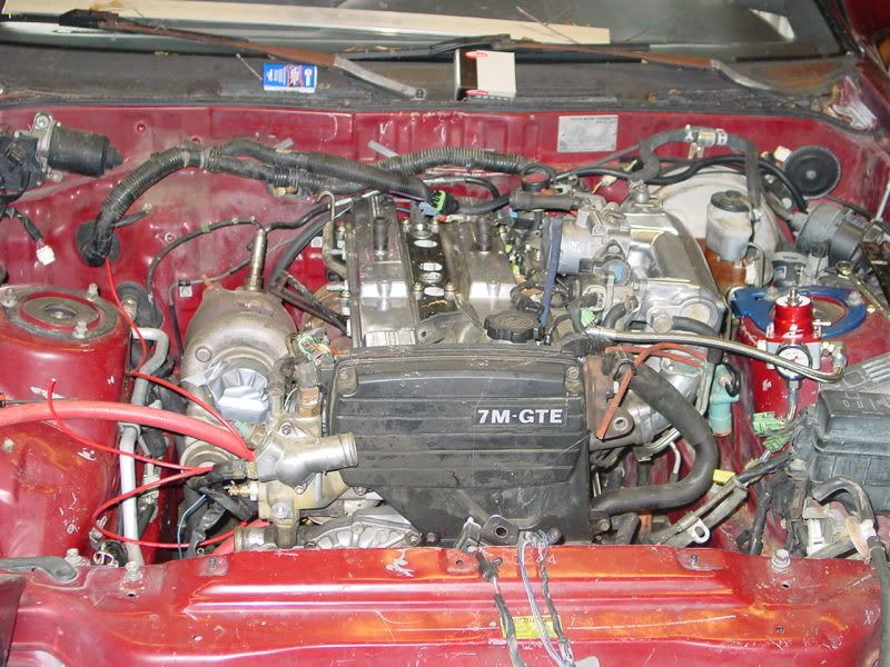

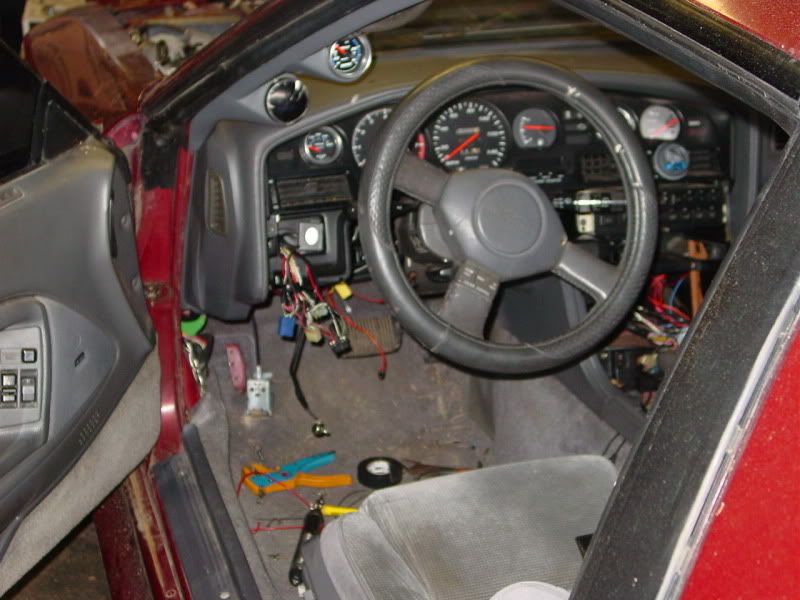

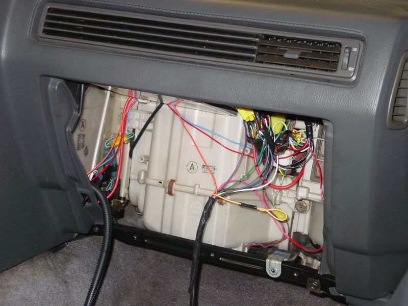

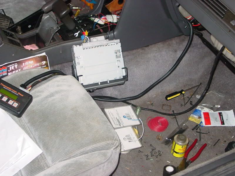

Honestly didnt take too many pics along the way but here goes some of it..
Wiring in the MAFT Pro and LC-1
The engine as it sits right now waiting for me to finish it.

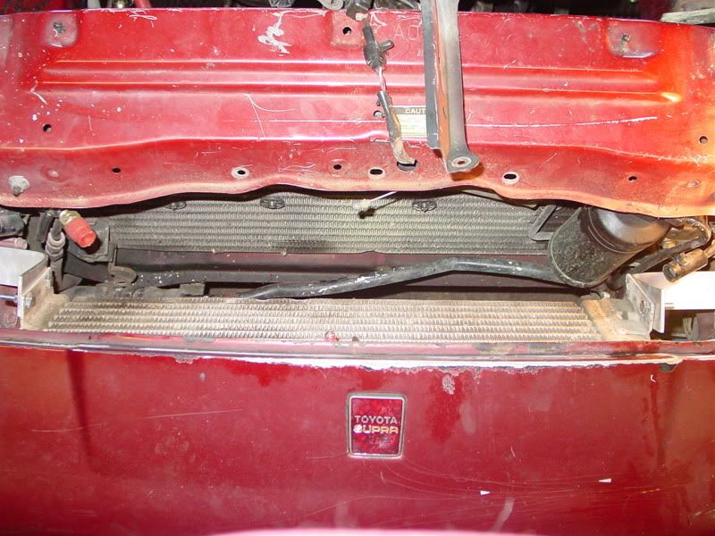

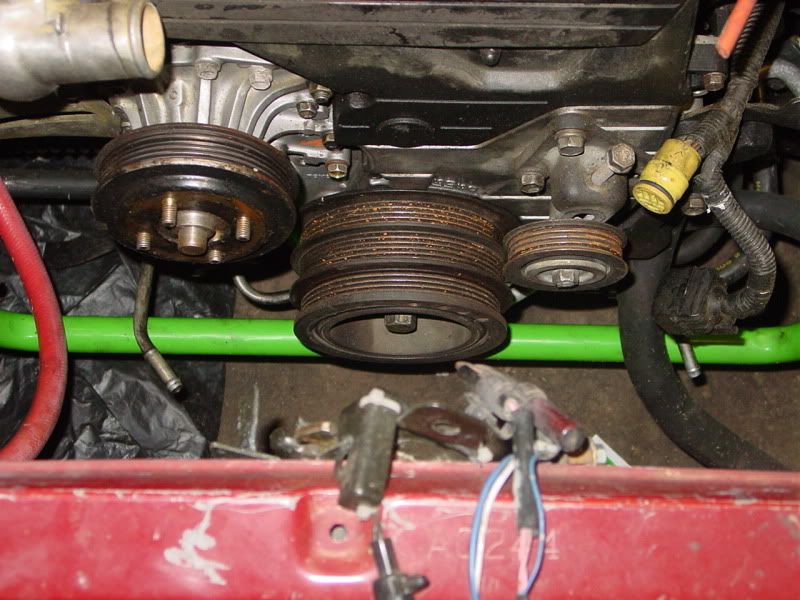

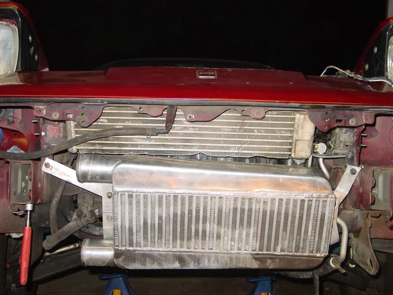

Made more progress this weekend. Got all the AN fittings and hose routed and installed. Was able to get the IC bolted back on and pipes in place. And finally put the front bumper back on!! Evreything was going fairly well if not a bit slow.
Had to make damn sure those lines dont move anywhere I dont want them to.

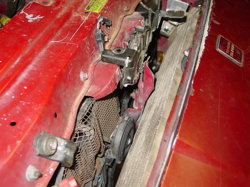

Had moved into the engine compartment mounting up the accesories (PS and AC) when I decided to test fit the radiator. First, I wish I had found this thread. It describes all the problems I just now discovered. I decided to go with this radiator due to this statement however.
Grimsta;871725 said:
ZANKOKU PERFORMANCCE
JVT RADIATORS
For those of who dont know, Zankoku will always give you the best rads and the ABSOLUTE lowest price. And of course, JVT's rads fit perfectly better than Megan's or Mishimoto's AND the custom top mounts are included making it a drop in affair. The stock fan shroud even bolts up fine to these.
2 Row- $168.10 + shipping (& tax for Cal.)
3 Row- $213.60 + shipping (& tax for Cal.)
Seems like hidden fees? I dont think so, look at this. The 2 Row at $168.10 shipped within California is $199.55 OUT THE DOOR!!!! Thats about $11 less than before. Who loves you baby,
Before I can make it a drop in affair, I will have to modify the lower mounting tabs. Then order electric fan setup with thermostat. Then rebuild the top brakets. Then I can have a 'drop in' raditor.
Here is the included brackets.
And the radiator.
