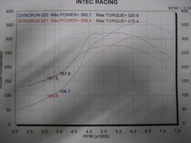

Went to intec today for some tuning. This is about an hours work. Not really perfect but a good start.
12psi for you ric :)
dyno 001=10psi
dyno 020=14psi
Turbo was $250 well spent.

congrats, will there be any video's? A dyno run perhaps, or maybe a little drive.
What turbo and exhaust housing is this again?
How's it feel for lag now that you've had some experience with it?
Inquiring minds want to know:naughty:

nice broad power band from 4500 on ur in power for most of the power band not only that ur most likly shifting into boost !!! way nice dude!!! congrats when my stock turbos go ill do the same use nitrous to insty spool but it looks good for ur aplication

fstsupra: Yeh with the 4.30 back there It lands square in boost! I didn't really play with the timing below 130kpa so i think I can get it to build boost a little quicker. The tune is still really rough and it will get a lot better. If I end up not liking it there's always the BEP turbine housing. But so far so good.
