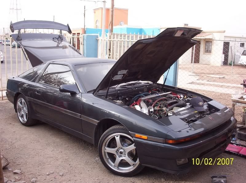

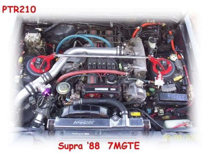

Here is also hot: Imperial, CA,
With out AC system on:
Ambient temperature 12pm – 5pm: 100 - 115F
Water temp: 190 – 200 F
Oil temperature: 190F
I have the following cooling mod's:
Koyo Radiator
New fan shroud
180 Thermostats
Redline water additive
Permacoll Oil cooler with electric fan
New water pump
New Fan clush
MR2 Hood vent
