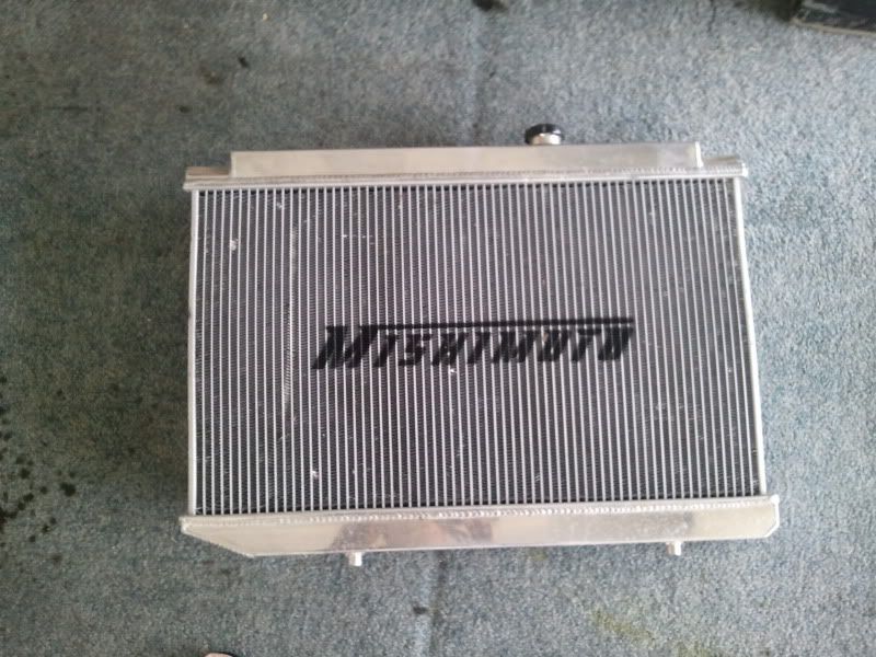

So since I'm happy with the power that I have made so far Im looking into getting some more parts.
Shine auto S2 lip
Shineauto air guide
Getting my old wheels back
Aftermarket radiator
New Clutch

Had a little hiccup with that today I am running a turbo clutch fan with a NA fan blade from Driftmotion. I also purchased a fan shroud to put on as well but when I put it all on together the fan blade struck the fan shroud causing it to burst to a million pieces. The reason was that the fan shroud stuck out farther than it should of cause of minor fitment issues and my fan liked to deflect outward under high revolutions. So needless to say not going to run the fan shroud. Between the radiator and fan there is plenty of room and my motor does not flex at all because of the solid motor mounts so I dont have to worry about he fan striking the radiator cause of motor movement.
I ordered a true TT fan and those are suppose to sit even more flush on the clutch so I hope it all works out well. Nice way to blow $135... :: angry ::
