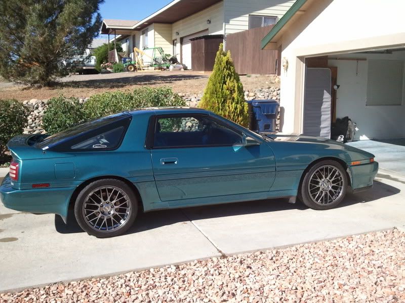

Glad to see you kept the car...your bay is pretty much why I cry when I see my dirty old 7M sitting there. I think about pulling it out for block/bay/valve cover painting every time I pop the hood, and it's your fault, lol.
I like the Enkei's...super slick, especially with your color. I'm always partial to split spokes, though; probably getting something similar for my ride. Manaray MJ-9 sounds about right ;)
