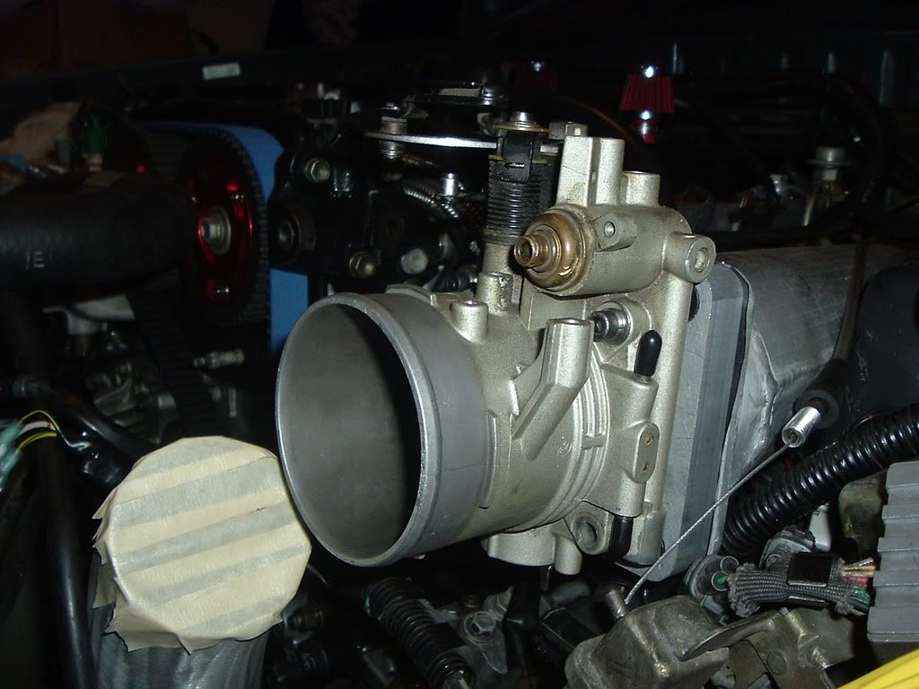

Well I have the A Q45 TB now bolted up, and she is ready for a another test fire. <crossing fingers> But the problem Is my turbo is on another supra right now that we had to move and now that supra is under 3 feet of snow. Plus with it being -15 degrees out side for the last month nothing else has happened beside ordering a couple more parts. Maybe with in the month Emilio's turbo will be back form the rebuilders and I will install his turbo untell we can get his car out of the snow.

EDIT: Yes the CPS is set correct, timing is on the nuts at 10 degrees and is not a problem at this time.

Yep that would be your old one Ryan, I just "modified" (removed xtra linkage) it little in hopes of getting it to work.

Ok well to bring some closure to this thread, Sean & Emilio stoped by yerterday and last night Played musical turbo's for the last time (remove mine from Emilio's car), got mine back on my car and Emilio got his new turbo installed on his car.
Put back together my supra, with the Q45 TB. & BAM, she idles like no ones business!!! Perfect, except for the "loop" with the 272 cams. I even had the idle down to 750 rpms. I havent driven it yet but the throttle seemed responsive, and everything look to be ok.
Still have low vacuum only 10 inhg :( cams?

Kristian_Wraae;1248099 said:
What was the problem?
The main problem was the "custom" throttle body, that was a POS. The butterfly valve / plate did not not seal correctly. There was also the manifold flange problem towards the beginning of the thread.

I am using the 7M TPS on the Q45. There is a adaptor out there at suprasport, but I just modded the Q45 so it will work.
