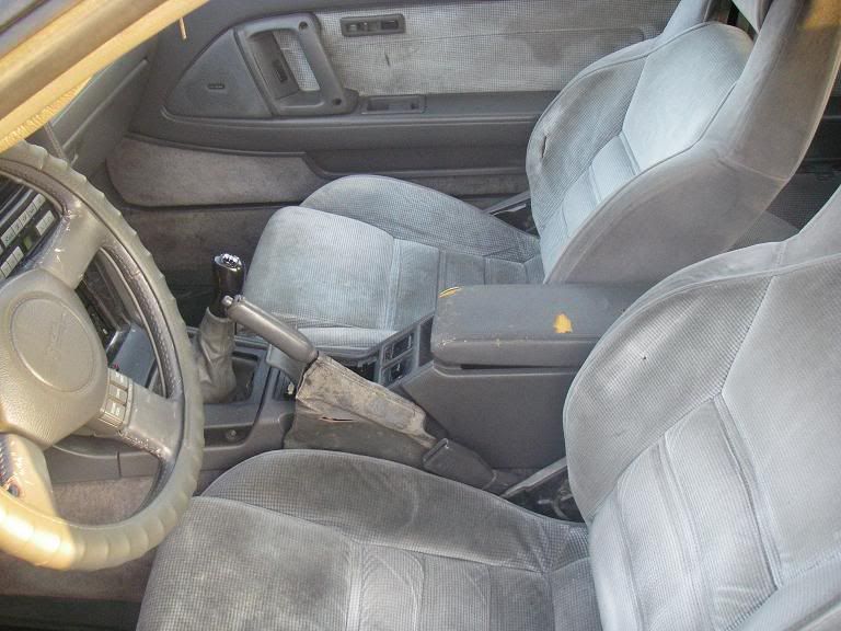

i need a new shift boot and ebrake boot. are those supra specific or can i just snag anyone off ebay? i found a new center console cover but its blue and my car is grey
my friend sprayed it down with some brake cleaner when he had it on the lift. i made fun of him and pointed out that the brakes are not in the middle of the car, haha.
The leak is very, very slow. i layed there for a couple mins to try and find one and was not able to see it drop down. im only assuming its coming from the weap hole because there was some on my driveway and when i got down to look, it looks like thats where it was coming from.
i had a previous heavier leak and they replaced the valve seal for that.
Also, now that you've seen the interior of the supra, do you think i would be able to get away with these door panels?
they appear to be leather and not the same color, but kind of close enough. what do you guys think?

the boots and armrest cover can be found on ebay and you can get them in all different colors and even get colored stitching
if it is a seal leaking it will most likely leak more while the car is running
i will see what gray interior parts i have leftover from my partout, i can get you some pics tomorrow if youd like
overall it looks like you got yourself one hell-of-a-clean supra

That door cover should work. The panel itself could probably use some cleaning but it the same color. I think you may be able to swap the leather insert with your cloth if you wish.
