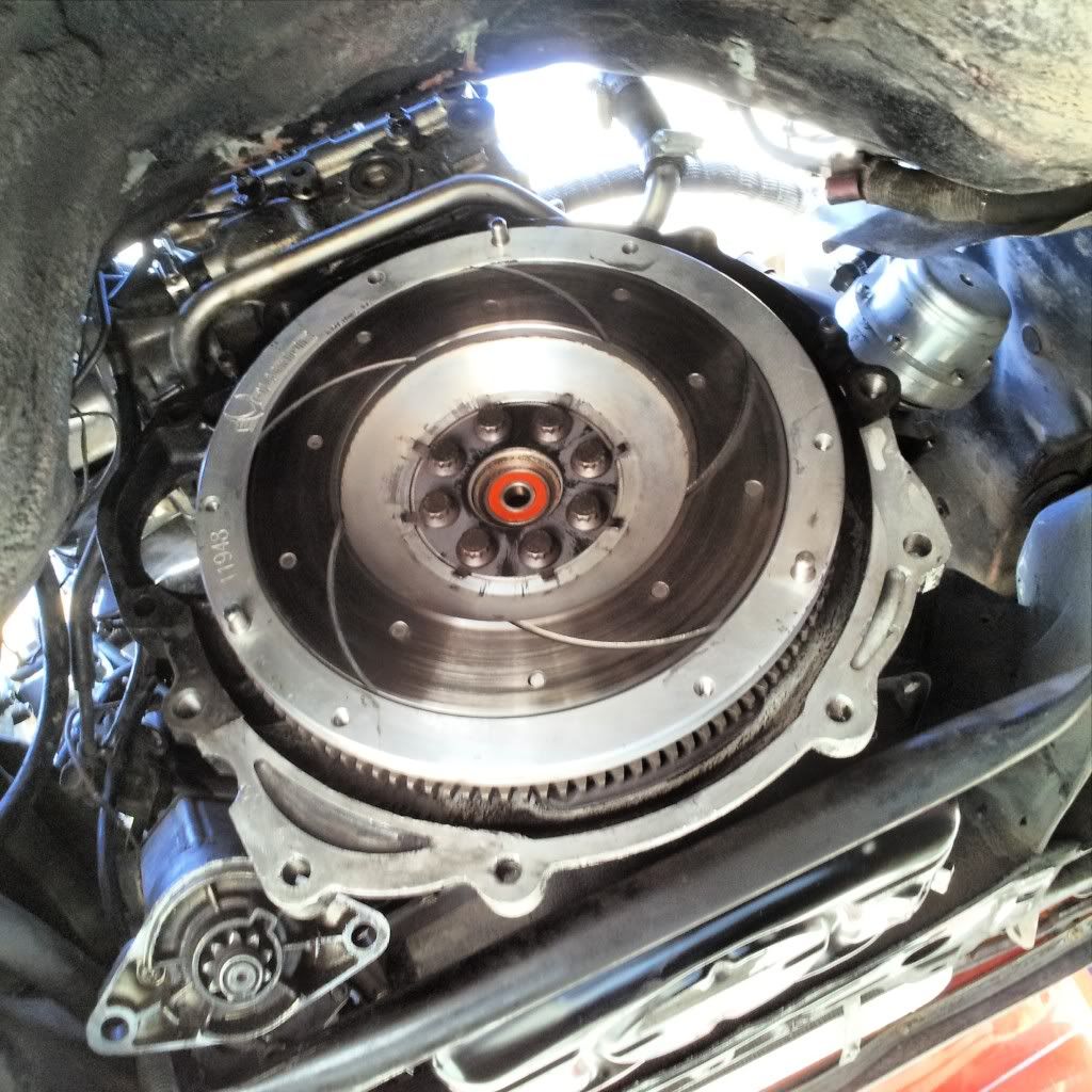

Aren't the tabs on that DM flywheel lockplate supposed to be bent in towards the bolts?
Isnt that what keeps the bolts from loosening?
Turbo Habanero
Apr 28, 2009
4,229
Tucson,AZ
Sounds like it makes since. Wonder why no one ever did it at any of the shops my motor went to lol. Oh well they were still nice and tight last time i did my Trans.
Next time ill be sure to address that
Albert
May 13, 2009
1,710
Tempe, AZ
The locking tab won't work for arp
Mickeys supra had the same issue...
Use red locktite(you have to with jzs or it will leak) and torque to 65lbs
supraguy@aol
Well-Known Member
Dec 30, 2005
4,238
Atlanta
Well, I'm sorry Steven.
Ive' been staring at the pic, as deep in to the obvious as i can, but my eyes aren't what they used to be.
I don't have any experience with using a lock plate. Maybe you could help a brotha out ?
Grandavi
Sep 25, 2008
2,664
Calgary, Alberta, Canada
stevenr816;1937925 said:
Your answer is stated in that picture. Deep inside the obvious.
tyvm for being enigmatic... that works when people have missed something important.. lol. But you did it very well!
I stared and my eyes hurt.. but cool. I still don't think the tabs will stop them from spinning and I believe Albert's response (above yours).
Grandavi
Sep 25, 2008
2,664
stevenr816;1938086 said:
Lock ring will only work with a hex bolt. That have flat edges which will allow the lock ring to engage on something. Arps have the round face, on top of being 12pt. Nothing to lock down on.
Ya know how your sure your right and then someone makes a statement that makes you question yourself?
stevenr816
Feb 12, 2007
932
Phoenix,AZ
Right
And I know Alberts right cause I was the one that told him that. Your actually suppose to use thread sealant since the holes are into the oil galley. But I recommended lock tite with a full bead around the bolt instead of a drop since he had some loosen in the past.
supraguy@aol
Well-Known Member
Dec 30, 2005
4,238
Atlanta
So...
I was right? The tabs are to be pressed against the sides of the bolts?
But they weren't in this case, because arp's were used?(the deep obvious)
So, why is there a locking plate on the flywheel in this case?
I ask, because i was thinking of buying one, but I'm using arp's also, and additionally,
I've seen oem pieces that are called lock plates, but they are tab-less rings.
I was wondering if there was some lockwasher-type friction effect that these offered or something...
