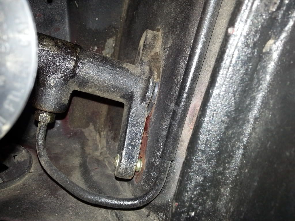

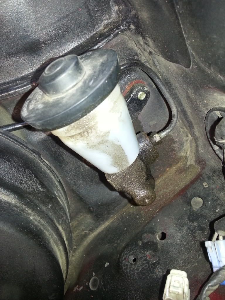

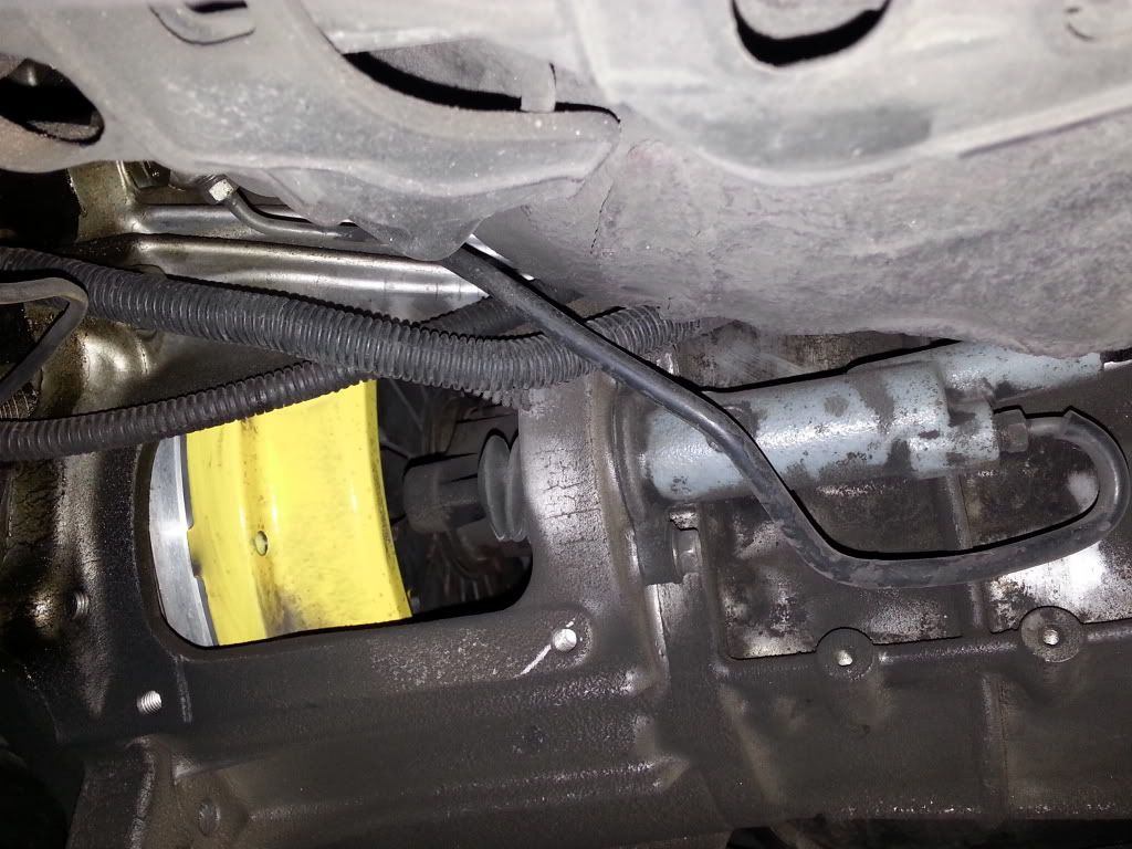

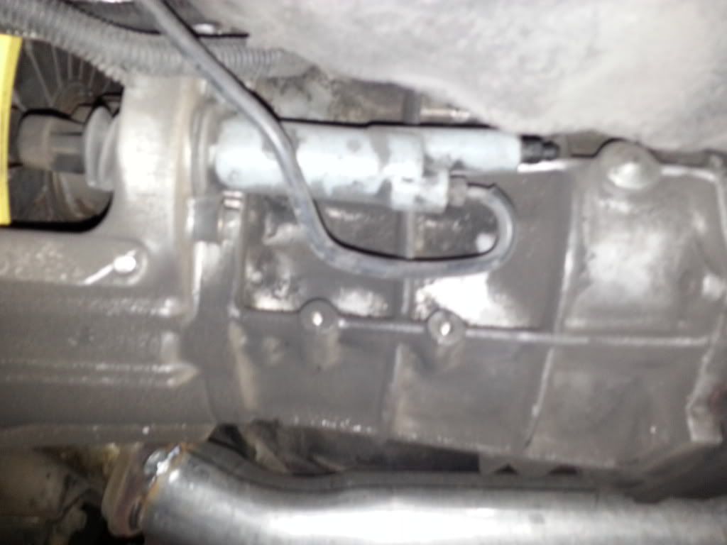

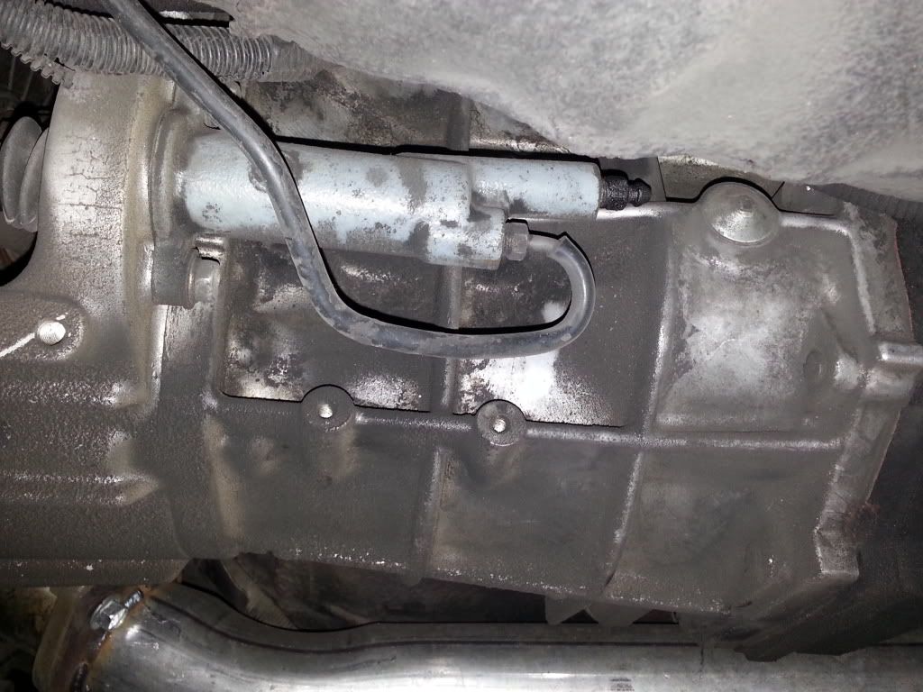

How old are the master and slave cylinders?
Btw, the stuff on the bell housing, is that from the master blowing out fluid or elsewhere? Transmission seems quite dirty for how little you've driven it. I seem to recall it being cleaner is why I ask.
Turbo Habanero
Apr 28, 2009
4,229
Tucson,AZ
I'm not sure. It was a hell of a lot cleaner before.
Slave I've never changed
Master is new but obviously not installed correct also a cheap auto zone part.

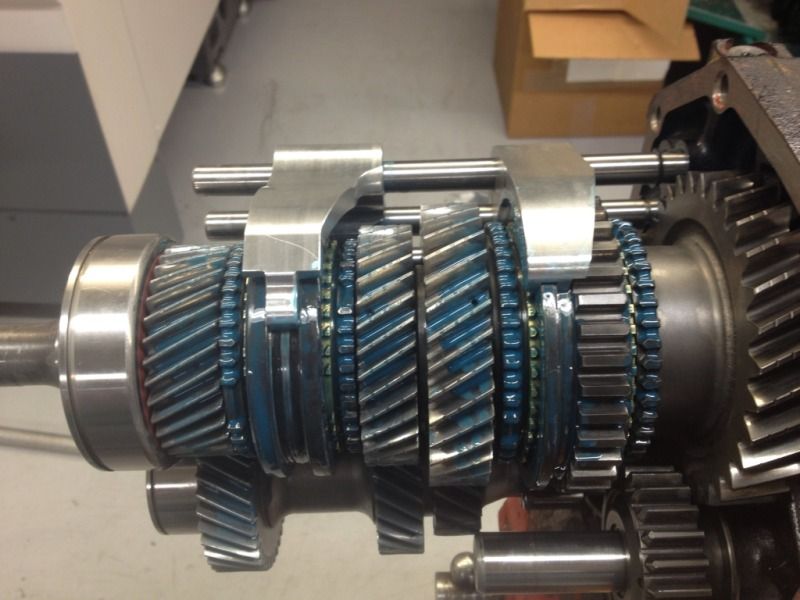

Okay Jordan, I have a Slight recipe that may work for a r154 to last a little longer than a week for you ;)
First get al lthe MC parts
1 retainer plate
1 Thust washer
1 1-2 billet fork
1 3-4 billet fork
After that get the rebuild kit. I went with Cobra Transmision and so did Dutin. $160 for the same stuff you get from DM.
http://cobratransmission.com/index.php?main_page=product_info&cPath=2_2066&products_id=50276003

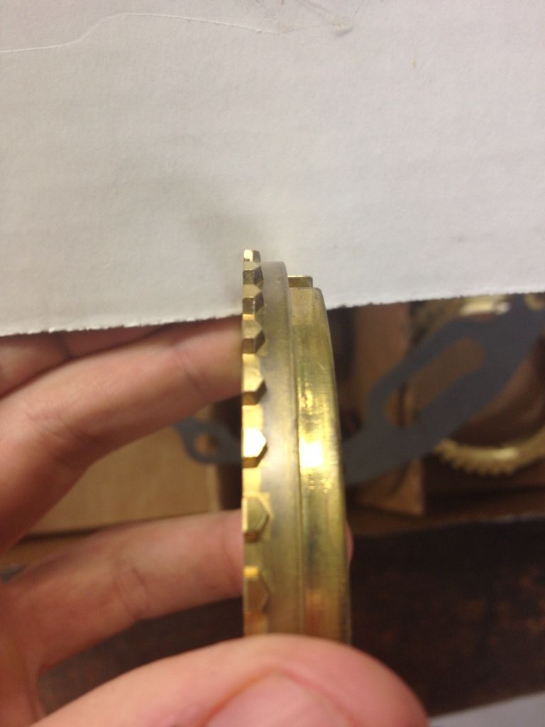

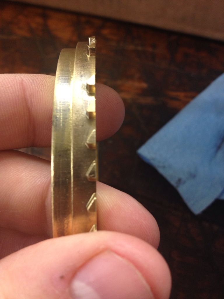

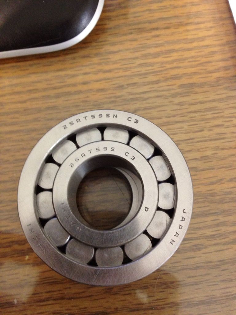

It has the upgraded/revised 3rd and 4th syncro, and the Upgraded full compliment roller bearings for the counter shaft.
Stock synchro:
Revised Synchro:
Upgraded roller bearings:

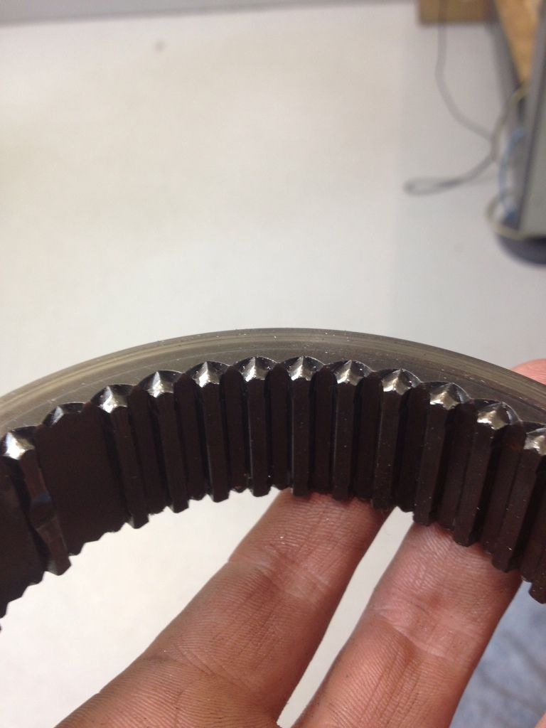

Then you really need to look at your Hub, Sliders, and engement teeth on the gears to see how rounded they are.
Mine were pretty bad, even tho it shifted fine, you want these things as pointy as possible just like the syncros. Luckily I had a friend send me sapre R154 parts, and his sliders, hub, and engament teeth were alot pointier than mine. So I used his. this sound really really help the sliders engange a given gear easier. Easier is better. Missing gears while shifting does a number on the tranny.
Here is why my sliders looked like:
This was one of the best ones, I can grab a photo of the worst ones, which was more rounded
Here are new ones you can buy:
