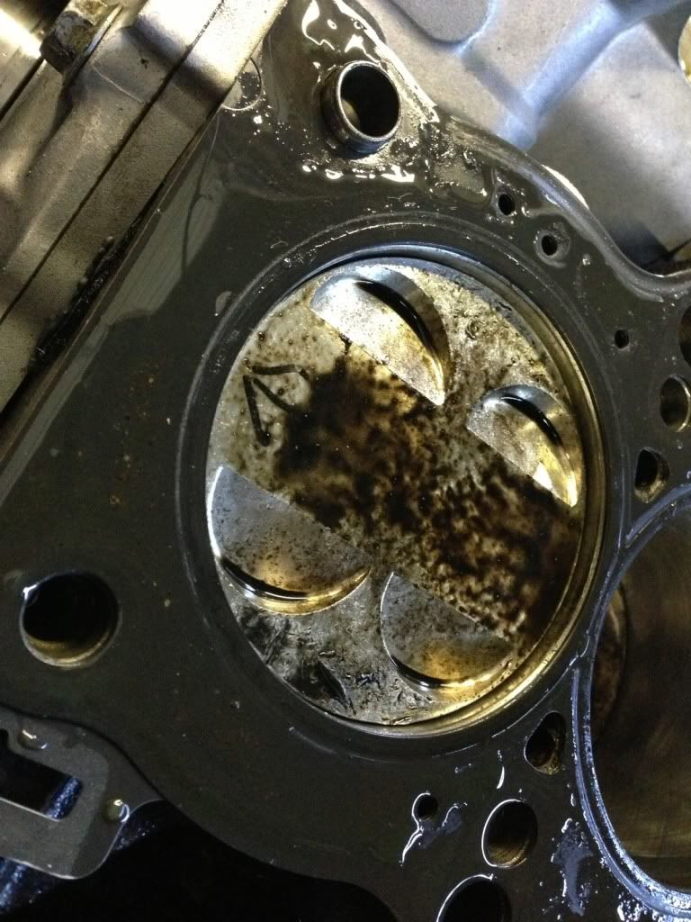

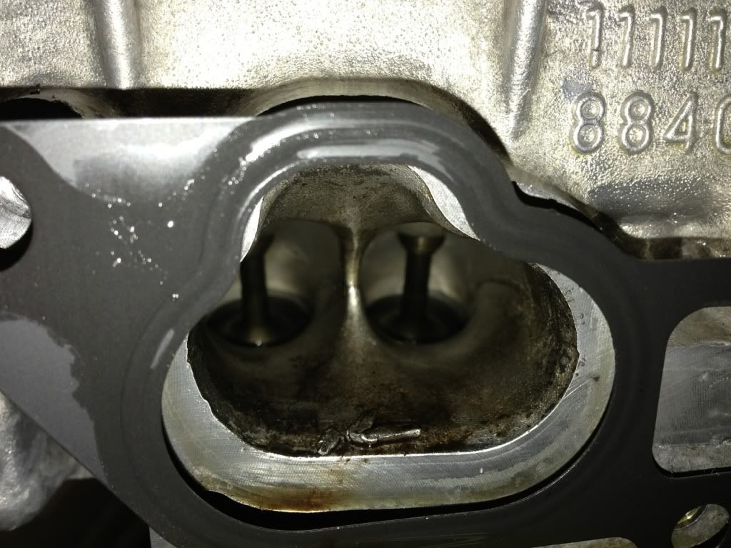

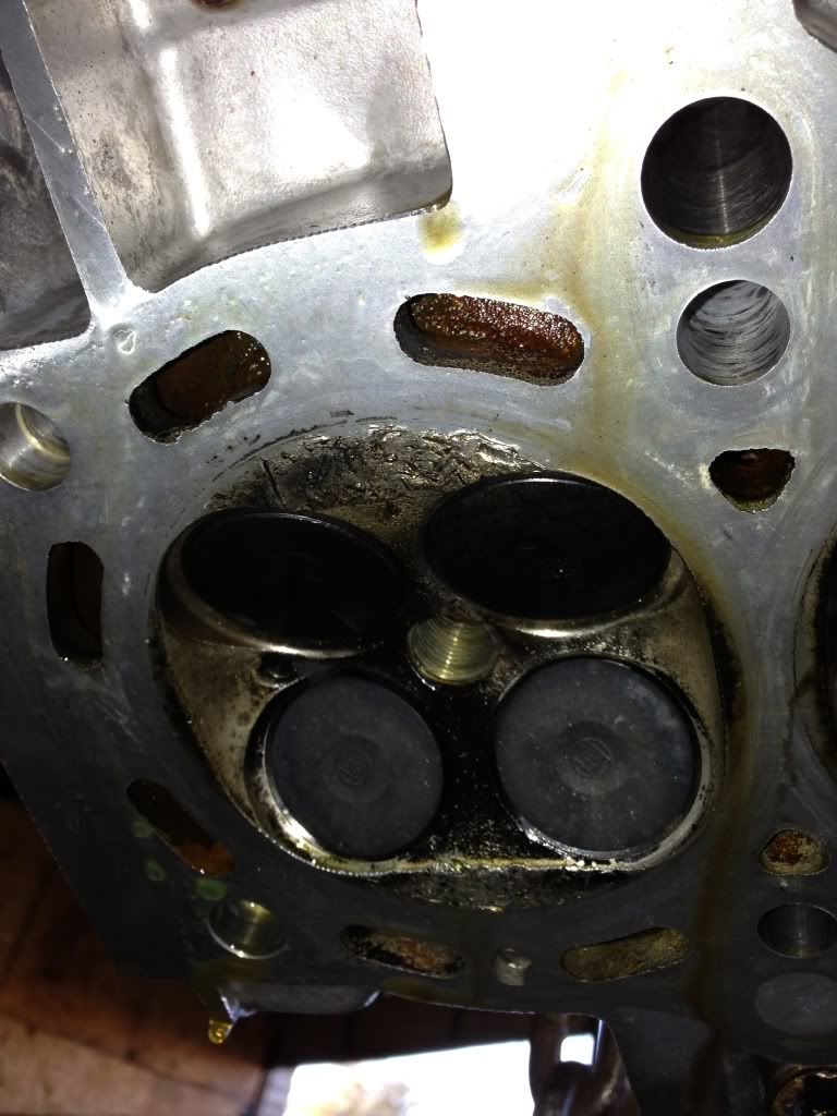

But as for the motor I was at first super excited cause I put it back together and pulled the valve covers to listen and saw the intake cam gear was hitting the screw on the backing plate. I was like nooooo shit.
But that didn't fix it
Made the decision to pull the head and that's what was laying on cyl1. That's why it was intermittent, it would fall down into the valve relief.
But it needs a new HG, new piston, head work, and some arp nuts. Who ever took them off or on used the wrong size and I had to use an easy out on couple of them.
These pics for some reason look like crap.
