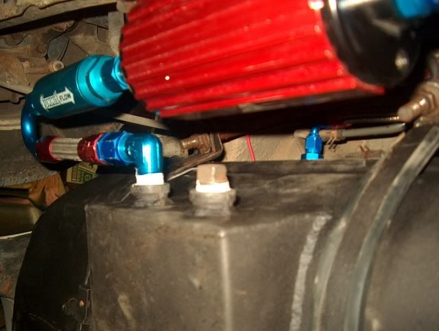

are there any pics of a stock pickup/return modified for use with an external pump? i'm in a similar situation; torn between bosch 044 and a1000
suprahooked;1208700 said:I run the A1000 with -10 an feed and -8an return with a stock fuel rail, oem sumped tank. I sumped the front of the tank so the cops dont see it and painted the pump black. But i do do keep my tank at least half full of gas so i dont have no Fuel issues.
suprabad;1208881 said:Dual Walbro's = too loud for me. In fact one is way too loud. The sound is grating to me.

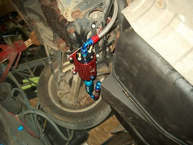

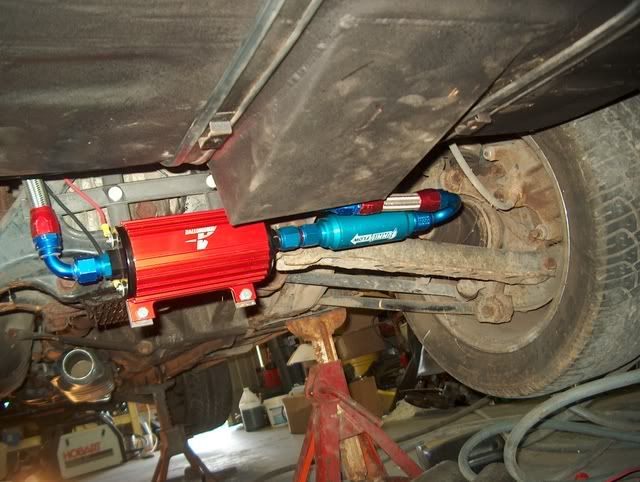

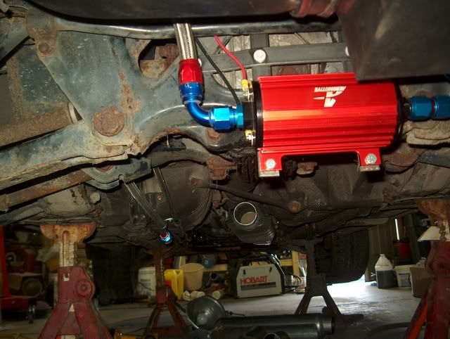

I use an A1000, no sump, (bottom feeder, so I gotta keep plenty of gas in the tank) and I made a metal cover for it that's under coated and lined with dynamat. You can't even hear it.
Evilempire1.3JZ-GTE;1213398 said:Thats how mine is also aeromotive with AN -10 off the bottom of the tank its -10 all the way up to a "Y" then it breaks down to 2 -8 on the "Y" which feed the rail from both ends.
For the return I use the original fuel line both of them!
I use the old fuel return line + the fuel feed line minus the filter of course which is Y'd in from the regulator the evap line is still the EVAP like oem.
