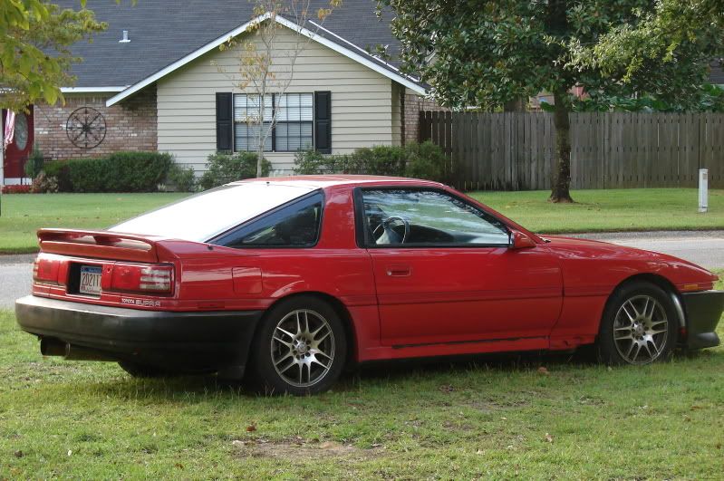

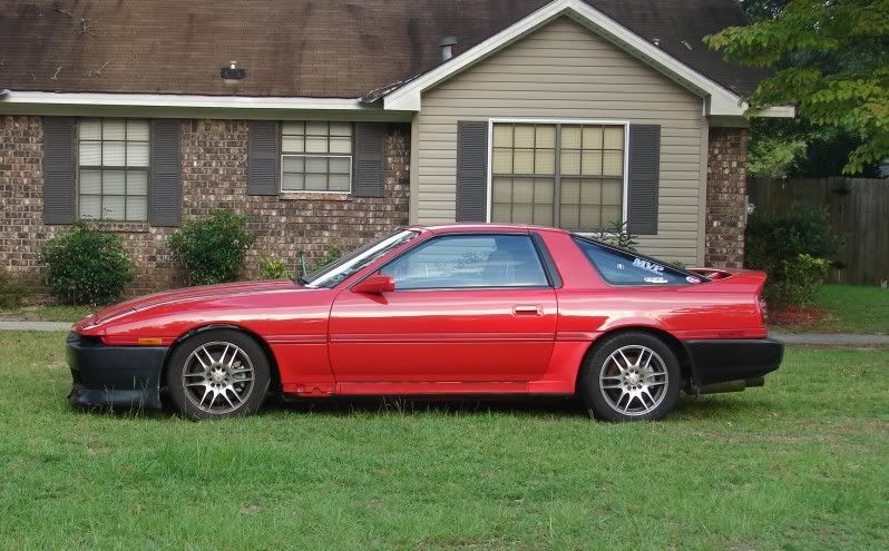

Oh SHIT!!!!!!!!!!!!!!! How did it get there??????????????
Wait, that's where I parked it after taking it out for it's first drive, a mile long trip around the neighborhood.

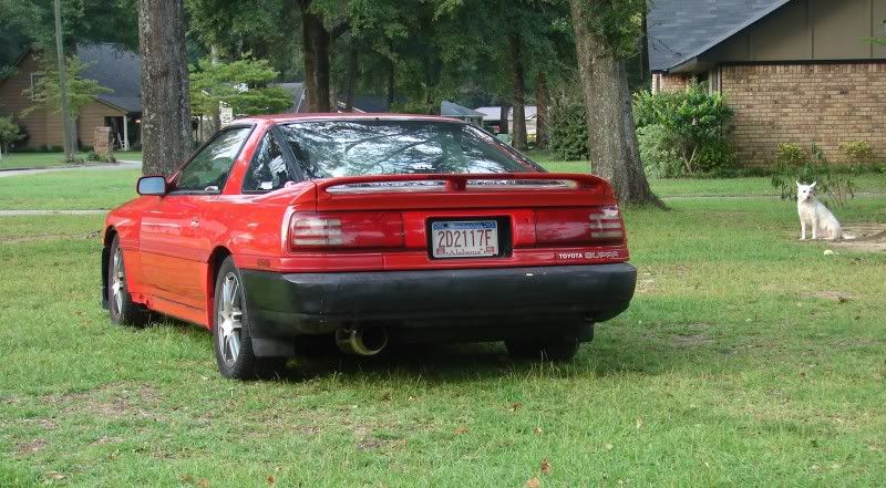

Here's a couple more, including one just for Dave. Ya, that's my dog Jax. He has been enjoying coming out with me in the nice weather this week as I have worked on the car.

:eek:ffwall: Yay!!!! So how did it run? How did it drive? How much did you drag pulling out of your driveway? I guess you got the electrical issues worked out and do your gauges work? I know I know, Mr. Question here.
The car is seriously low in the front. To me, and you know how I am, it would look better with a stock bumper. Just saying... ;)
