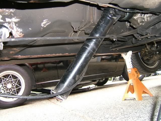

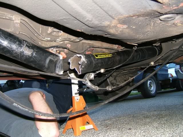

well... I almost flipped over and died.

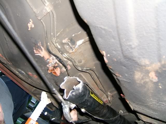

Story:
So, I was in 4th gear, just getting past redline at around 135-140mph, and, BAM! my drive shaft ripped in half, tore through my floor, air lines to my front bags, e-brake, etc.
So, I suddenly loose my front bags, the car hits the ground, my rear brakes lock up due to e-brake getting tangled, and I come to a scrapping stop on the side of the freeway. Waiting 3 hours for a flatbed tow truck to deliver my car 3 miles.
It was one fucked up night, I got home at 3AM....

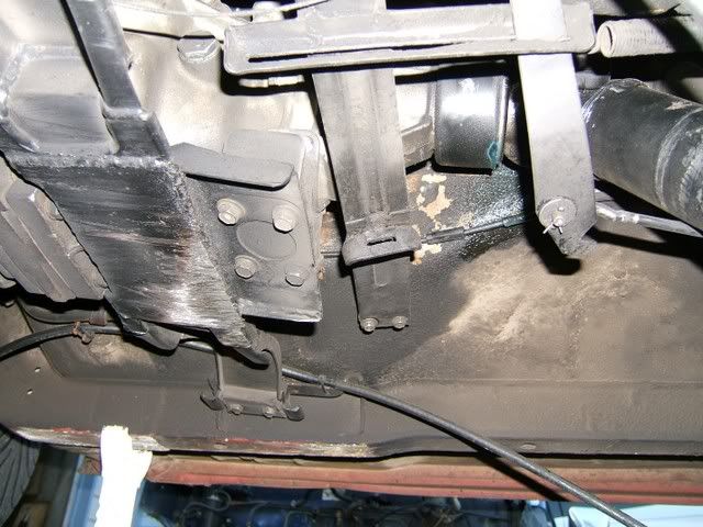

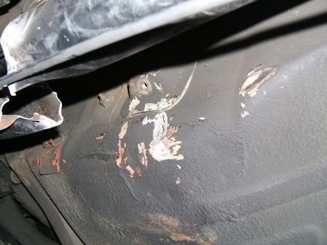

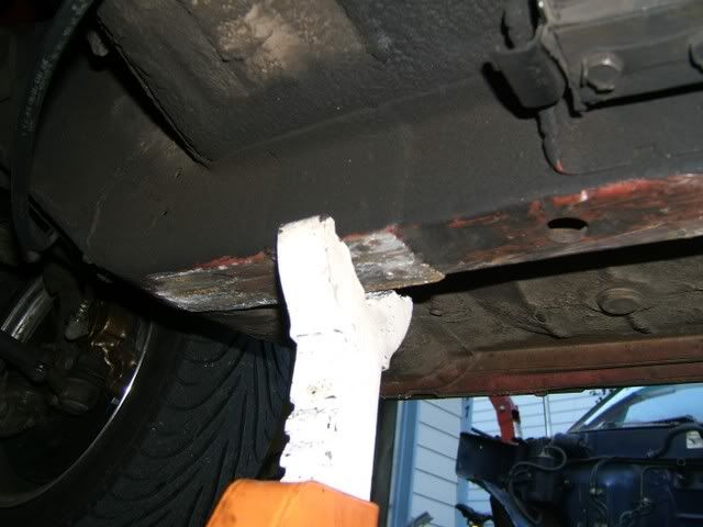

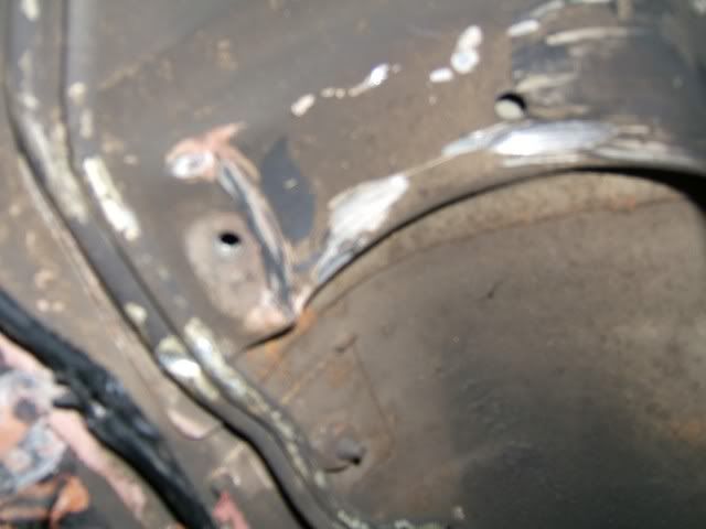

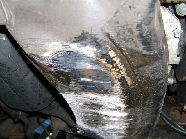

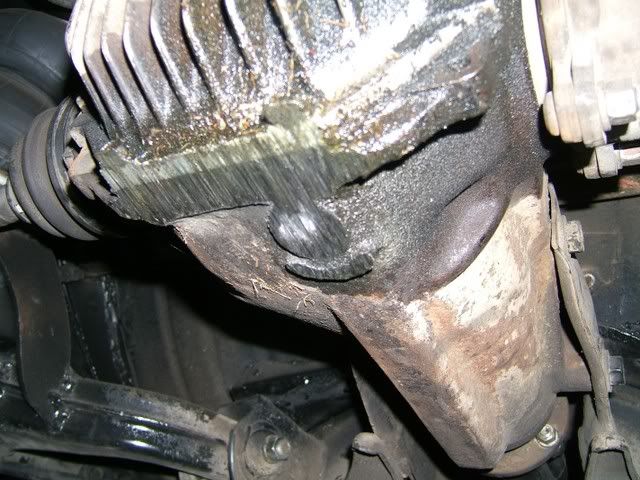

Here are the pics.... pay attention to the front crossmember, where the metal turned blue do to extreme griding.
ENJOY!!!!!
Fuel line almost punctured (high pressure side) + sparks from frame = Amazing fire show... imagine that.
Where is the drain bolt??? lol!!! it ground to nothing!
Thank you Drivelines NW for your poop ass driveshaft! This happens to be the only part of the car that I did not hand make, and it turns out to be the part that blows up... what the hell?!

This is why you need to place the valves on your airlines as close as possible to the bags!
Looks defiantly like ductile failure, you sure the tail shaft was made to cope with the power you were putting through it? Did it ever feel like there was vibrations/unbalanced.
Its failed directly in the center of the shaft? Defiantly looks like it wasn't supposed to take the kind of power you were putting through it. Any hard launches etc?

Big Rob said:
Holy shit!
If I had a pickup with tons of clearance, then I would consider this... Keep in mind that I barely had room for a fuel pump.
The issue lies in the guy who balanced it. This shaft was rated to support an abusive 600 tq. Right before it blew, it made one of the nastiest vibrations. When I pulled the chunks out, the U joints were still mint, so that isnt the issue.
Rob
I dont launch it, but even if I did, it should still be 100% able to take it. Shit, this same company makes drivelines for stock Vipers that make double the power I am putting out.

IJ. said:
Pinion angle maybe.....
Either that or it's long enough to have gone "critical" speed wise if you drive fast.
Thats exactly what happened.. I went way over critical speed that the driveshaft was rated for. But, the issue is that they did not tell me that critical speed on my driveshaft was 80MPH....
They pretty much screwed up, they didn't disclose what the critical speed was, and now im looking to start a law suit against them.
DAMN that's LOW for critical there should have been a big RED Sticker on the shaft :(
I've been on a bit of a crusade here for years about NOT using one piece shafts in Mk3's really glad you survived that.
