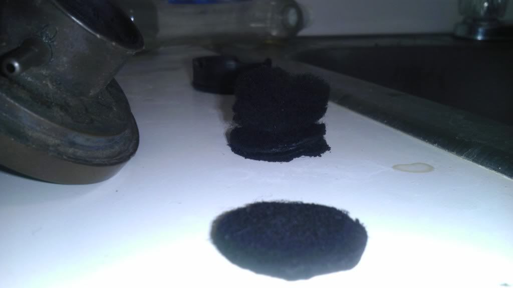

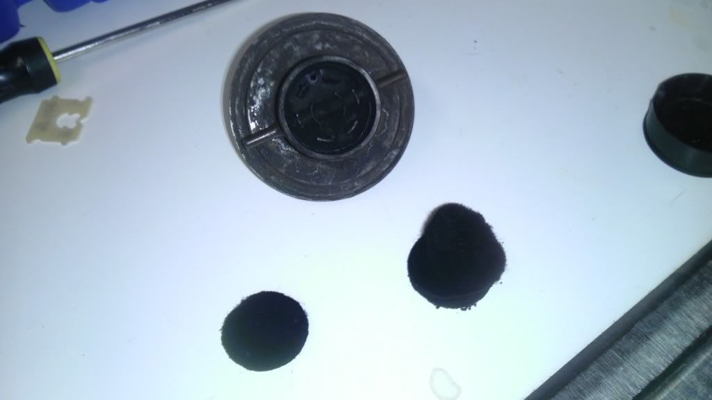

So i decided to take to inspect the EGR Modulator and well i'm not sue what it is suppose to look like but the filters are dirty to say the least

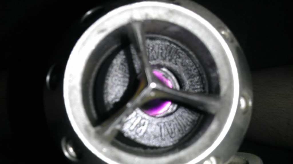

I have a knock off HKS same flange just a snap ring hold it on and there's no adjustment screw
well let me explain before my blow off valve HKS ssqv (REAL) would just give a solid burst of air unless letting of at medium VAC then you would hear the Flutter that the intake gives or maybe it was surge I don't know.
But after i fixed the timing on my car it flutters all the time even under 15psi let off's.. the thing is i can still here the intial burst of air followed by a flutter
So then i decided to make sure the valve was opening and it does it opens under very little throttle at IDLE and when i give it a decent rev i get that crazy flutter and it's coming form the valve i can feel the air coming out in burst against my hand instead a solid wooosh like it use too..
Vacuum at idle is 19-20 and 24 while driving Boost is dropping off pretty bad only gets to about 14psi and drops to 10

Photo of old BOV
