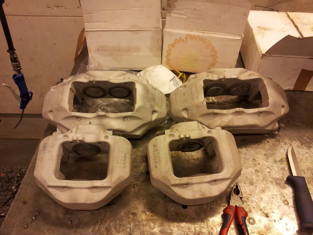

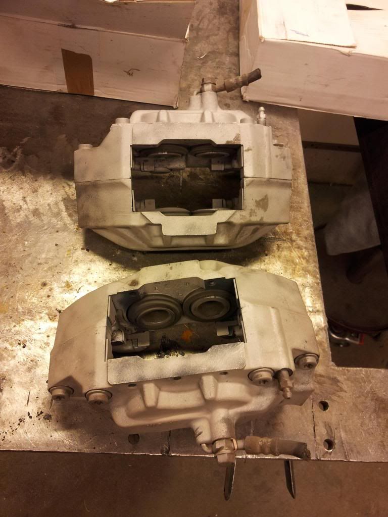

I'm also putting together my own big brake kit.
I got a set of free calipers from a friend so I'll try and use them. They are from a touareg V10, so it's 4 pot, 330mm diameter, 32mm thickness in front and 2pot, 330mm diameter, 32mm thickness in the rear.
Currently I'm set on using either 350Z (324mmx30mm) track or sti (326mmx30mm) rotor in front and sti (316mmx20mm) rotor in rear.
But I have a problem and that is that the chrome is flaking from the caliper pistons and I can't find replacement pistons for a reasonable price. The pistons are 46mm in diameter and 32mm high.
So my current idea is to buy land rover pistons which are 46mmx31mm and in stainless steel. These do not have any collar to accept dust boots so I will modify these in a lathe and I was also thinking about welding extensions to them to compensate for thinner rotors. What do you think?
I have also sandblasted the calipers and bought paint for them, but I won't paint them until the piston problem is sorted.
