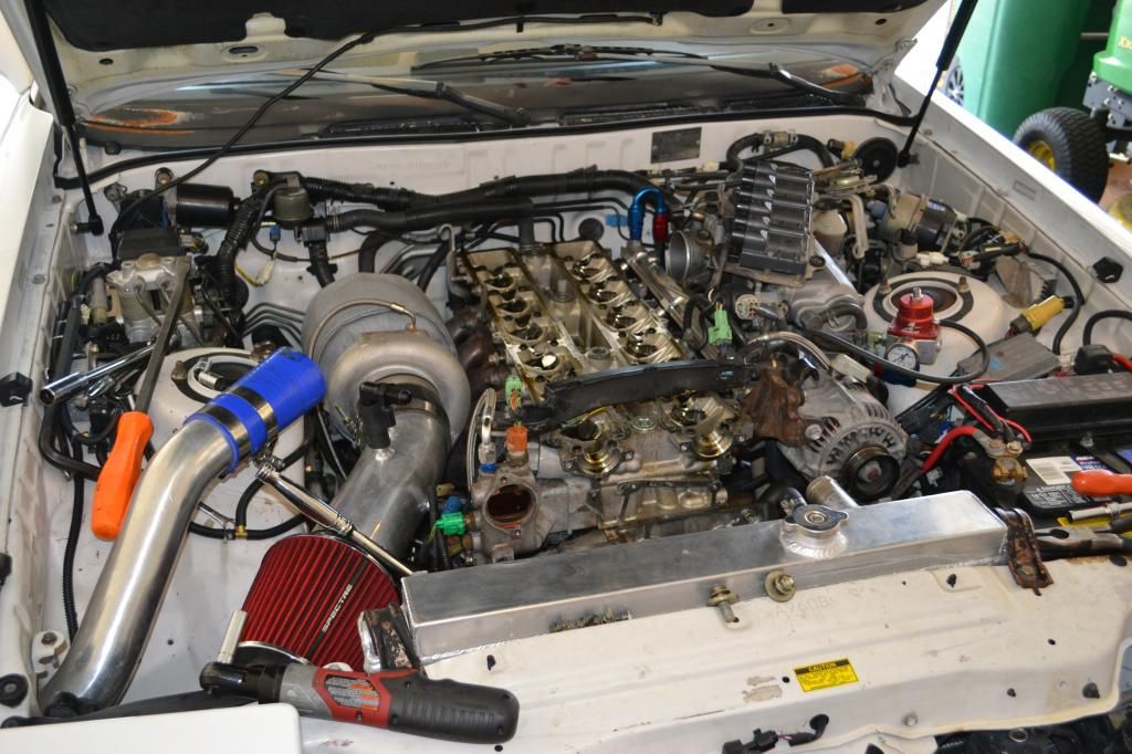

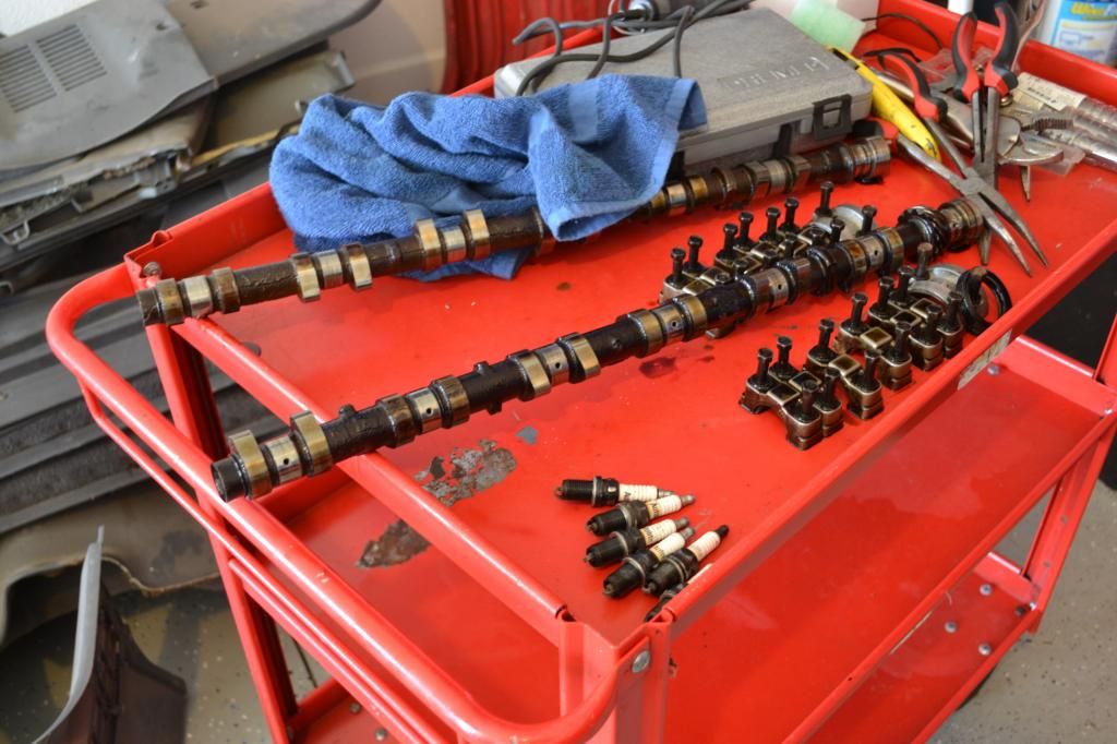

My car has been smoking for a while now and having symptoms of bad valve steam seals, so I bought a toyo tool and did the valve steam seals in it. (I recommend this tool, it makes doing the seals a fucking breeze. I am very happy with it for the most part.)

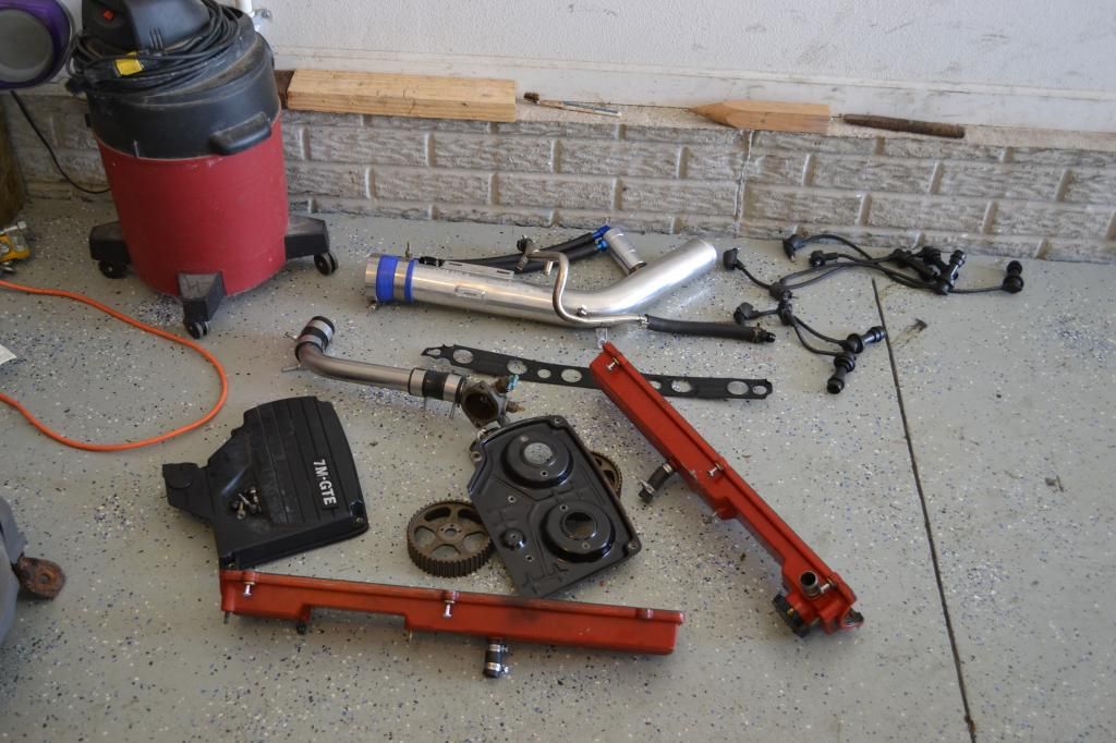

So When I was putting my back timing cover on (the black on that sits behind the gears on the head) one of the bolts broke, and fell into the timing cover, so I had to pull everything in front off and get into there. What a pain in the ass. Anyways, I had to pull my electric fans off, and on one of them I accidentally messed up a wire in and didn't notice. Well, when I went out and drove it it was still smoking, and was overheating a bit. So what did I do? I came to the conclusion I blew a HG again lol. Anyways, I had one wire come unplugged, and that is what caused all of this issue, so I fixed that.
Well, the smoking issue was a lot less after I replaced the valve steam seals, but was still there at idle, and during driving. After driving for a while, it kept getting worse.

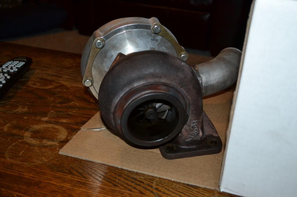

I ended up turning my car off with the hood open, and I could hear a little metal on metal sound coming from my turbo!!! Took my intake pipe off, and what do you know, there is a bit of oil residue. Checked my shaft play... Tons of in and out play and side to side. Fuck! At least I found my smoking issue :p
So off the turbo came, and it will be shipped out to Precision either today or tomorrow for service. Hoping it is going to be covered under warranty, since I bought it in febuary of this year, and I installed it and ran it just like it is supposed to be done.

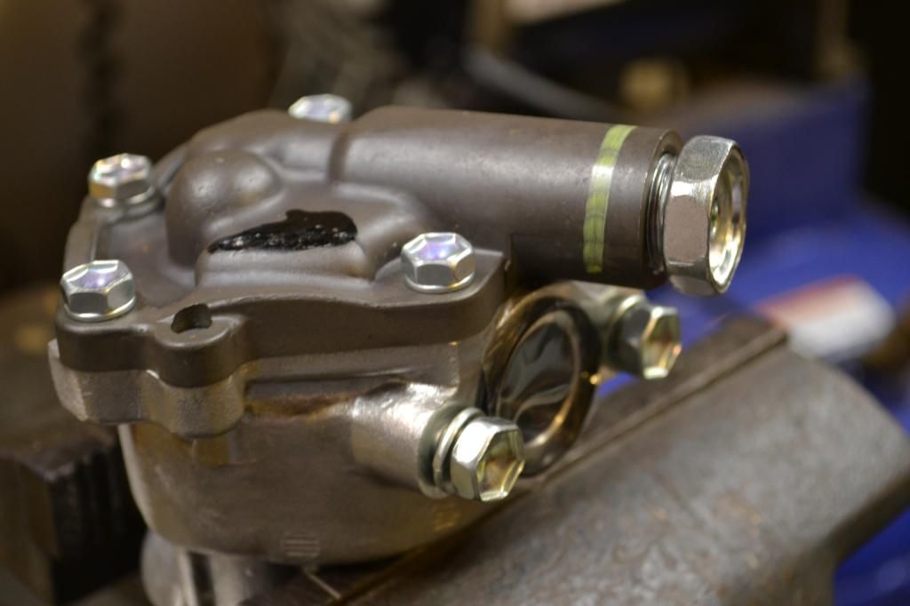

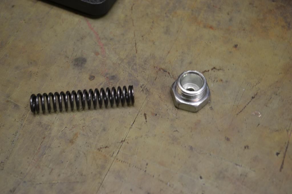

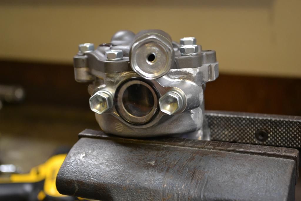

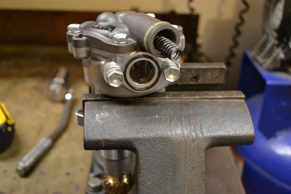

I started to piece together my full flow oil cooler/filter relocation set up.

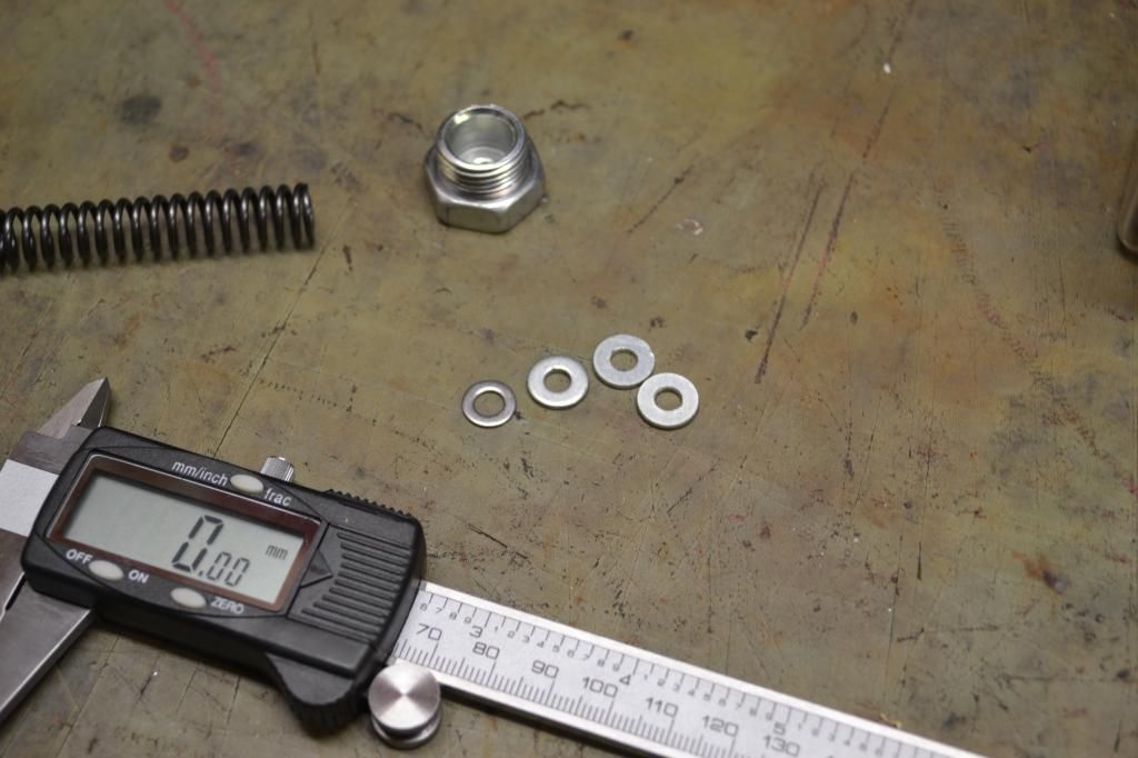

I also went out to the garage a minute ago and shimmed my oil pump to 5.15mm so I don't have to do it later when I am putting it together.
You will start with something like this.

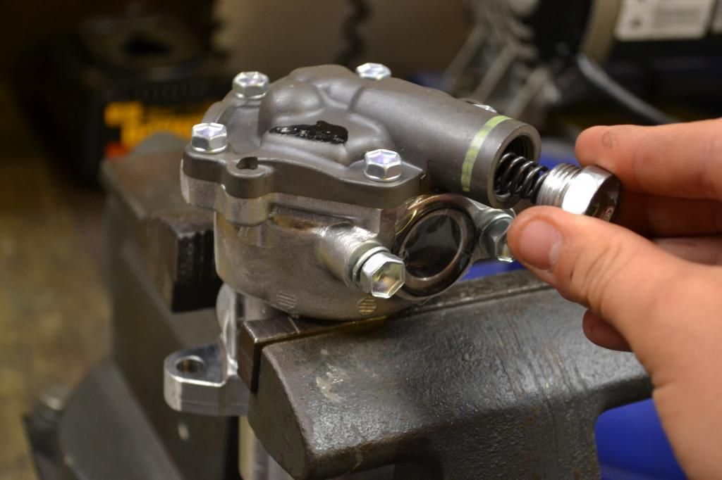

Pull the hollow bolt out of the end and grab that spring out and set it aside so you don't loose it.

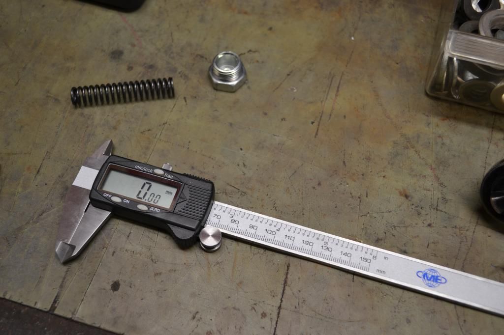

These will come out. (spring and hollow bolt)
Get your digital caliper out.

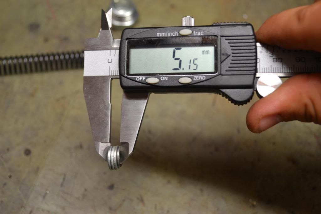

Get some washers out and put them together and try to get as close to 5mm as possible. (or whatever you want to shim it to)
Pretty close.
Get them stacked in the hollow bolt.
Put the spring back in, then carefully put the hollow bolt back in. It takes a bit of force to get the spring pressure relieved and the bolt started.
Get it screwed on there.
Finally get it nice and tight. And you are done, and the pump is ready to go in the engine.

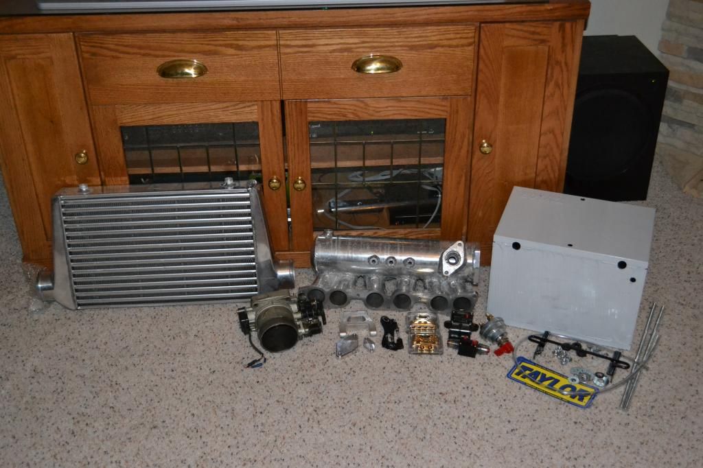

Anyways, in the mean time, I am going to relocate my battery, and maybe start my FFIM set up and set up my new intercooler and pipes, and possibly get my oil cooler set up in and functional.
So here is todays progress. Not much, but every bit helps.
I mounted my kill switch, pulled my battery out, and started to redo some wiring. I should probably get to pulling the drivers side interior to make things easier, but I am lazy today lol.

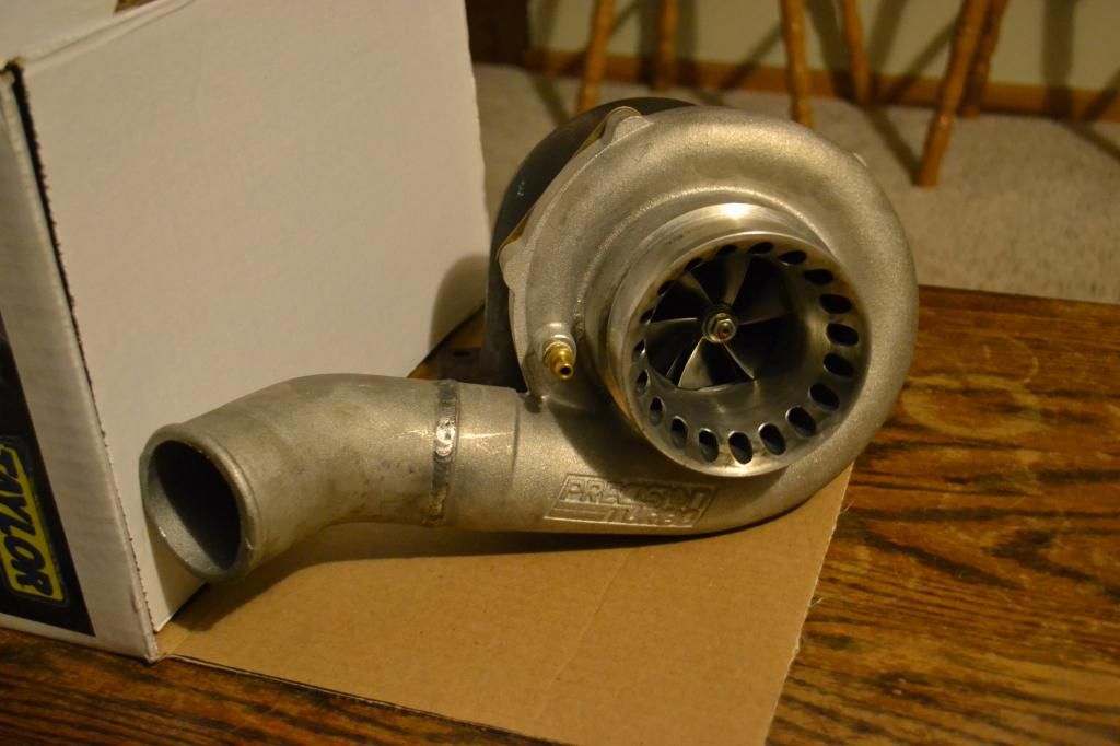

Turbo just came in today, and the car is for the most part back together.
Will have the gopro out this weekend ;)
