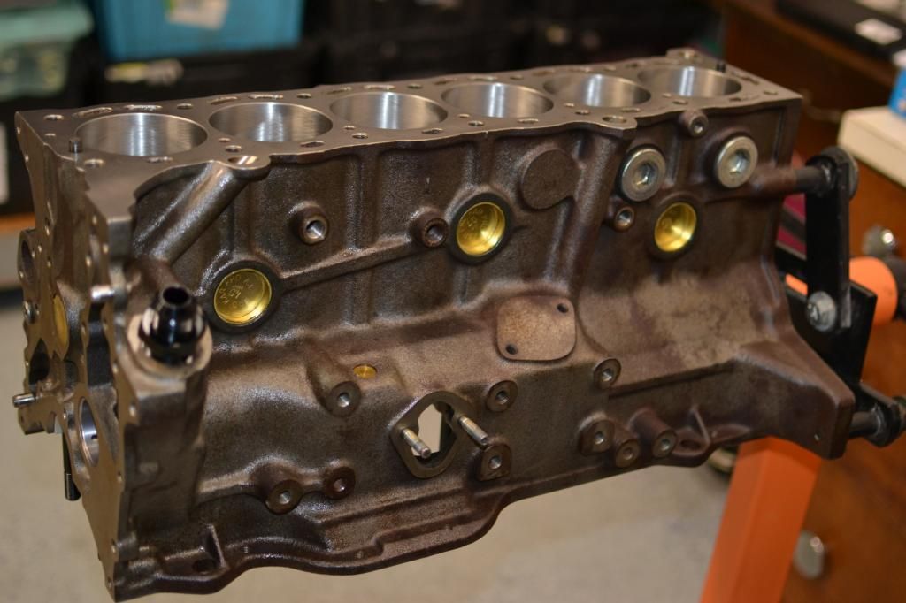

Anyways, here are some pics.
The timing cover got milled with the block, too, right?
It's not attached there so just wanted to make sure.. IIRC some people have made a costly mistake in not machining the timing cover too, because then their heads don't seal.
edit: NVM I don't see resurfacing the block on your list of work... plus it's probably safe to assume you know your way around a 7M. ;)
Yes sir, I did put it on there. I do feel I know my way around a 7m pretty well lol.
Now, I have heard of people filing down their rear timing covers, but I don't want to do stupid hack job work like that, specially on this engine.
