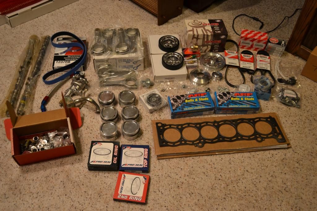

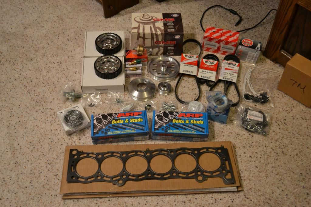

This post is getting a little long already, but in the meantime I decided to start purchasing parts I will be needing (by needing I mean wanting lol) So here is my most recent parts purchase.
My engine gasket kit came the other day, so I have almost everything I need for my build except main and rod bearings, and valve shims, because those will have to wait until I get the clearances measured out.
A couple other parts I need to get are freeze plugs, and oil pump drive shaft bearings.
So here is my parts collection as of now, besides the block, oil pan, and head with components.

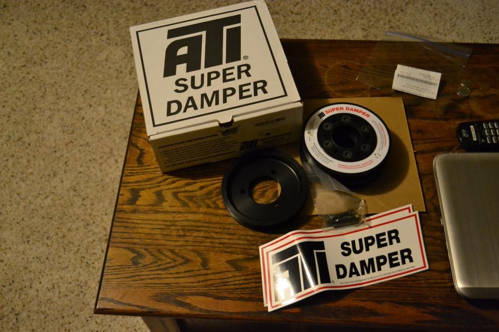

Oh shoot! I almost forgot to throw this beauty in there too. I just got this the other day also, and so far loving it besides the price tag.
Sep 19, 2011
510
Des Moines, IA
I bought it through titan. http://www.titanmotorsports.com/dacrpuformk3.html
