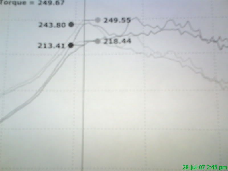

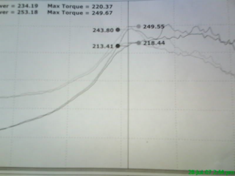

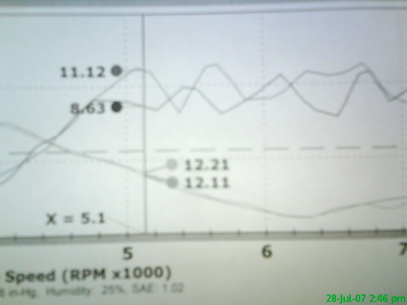

@11.12lbs, boost controller set @12lbs, made 249.55hp and 245trq. its either the wastegate or ignition problems what i can think of, my power drops at 5krpm and is real jumpy on the way down. boost controller turned off made 230hp and 218 trq. with the boost controller turned up to 14lbs, it made 243hp. im running rich. im gonna try to post the sheet. also over 100 degrees.
