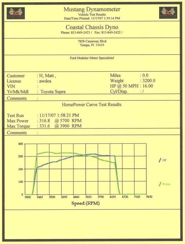

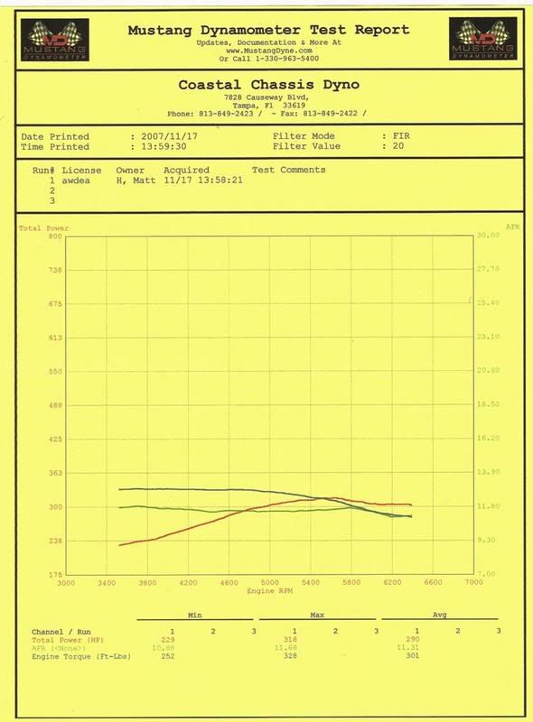

Here's mine from the Tampa meet last weekend @ 12psi on a 60 trim CT26.

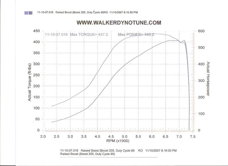

I posted 'em previously:
88Targarose said:
HKS Long runner cast manifold
HKS External Wastegate
Garrett 57 Trim, Mystery "HKS" turbo
3" Exhaust V-Banded exhaust leading to...
Greddy SP Muffler
"0.020 over JE's
Clevite 77 Bearings
ARP rod bolts
ARP Head Studs
Block/Head machined
HKS MHG
HKS SSQV BOV
Custom Blitz Large FMIC
VPC/AFC Neo/AVC-R
ZT2 Wideband
Walbro 255 Fuel Pump
550cc Injectors
South Bend DXD, Feramic Clutch
285's out back, 235's up front.
blahblahblah... (EGR Delete, CSI Delete, +12VDC Fuel Pump Jumper, J-tube bypass, etc. etc.)

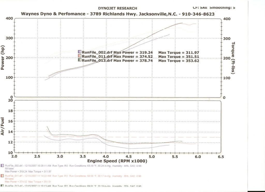

Went to the dyno today and made 378 hp and 353 ft/lbs of tq at 14 psi on the upgraded CT26. Wasnt too bad after starting off with 319 hp and 311 ft/lbs of tq. Mods are in sig.

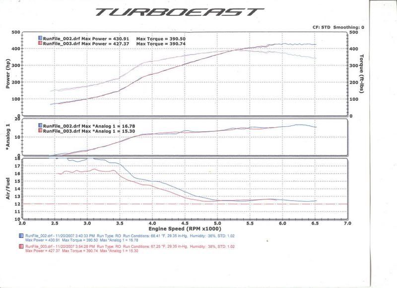

Mod list:
SP61GT (wastegate boost)
JBL o2 Housing
3" Exhaust (no cats)
Walbro 255
Aeromotive AFPR
DriftMotion Fuel Feed line (removed pulsation dampner)
Rebuilt OE Injectors
K&N FIPK
Lexus AFM
DriftMotion FMIC
2.5'' Cooleeze Aluminum Pipes
Greddy RS BOV (recirculated)
Cometic 2mm MHG
ARP Bolts (torqued to 100ft.lbs)
CompCams Valve Springs
Spec Stage 2 Clutch and Pressure Plate
165k miles on the bottom end, transmission and rear end!

^^^^^Nice numbers, although I wouldnt have my AFRs that high under boost.
88targarose said:
Agreed. I would've had that dropping to NO higher than 11.9 after 3.5K. I can't believe it doesn't even go to the 12's till full boost hits.
Yea, first run was with the sniffer type WB, second run was in the stock o2 location. It was still lean so I bumped up the FP to 42psi @ idle with the vac line, and bought an SAFC-II.

Aye Mate, very good numbers.. If you had an EVC your power curve would be much better. Your boost is creeping up to 16psi, but in the midrange, your only at 12-13psi.
