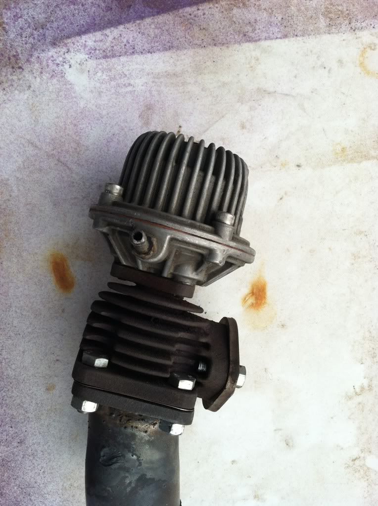

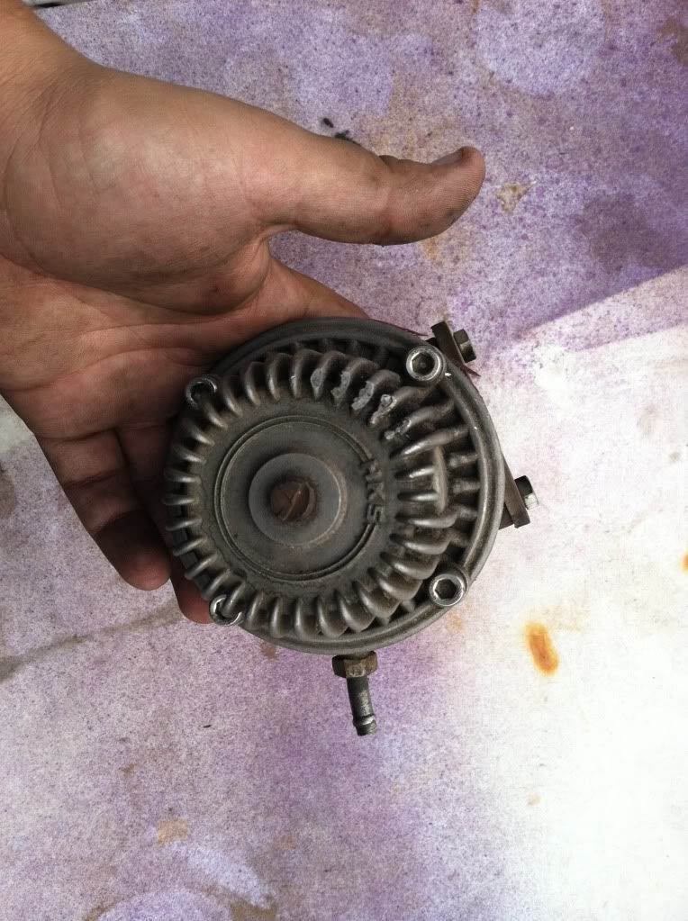

IBoughtASupra;1802933 said:The knock off wastegates have an issue of where the valve seats to the ring. They are not machined properly which causes the valve to be offset when mating against the ring. I had a knock off HKS and the valve was wobbling when you would shake it with your had, so you can only imagine how bad that is. When bolted down, it wouldn't seat properly and leak.
I returned that to DM and got another knock off and then sold it as that on the forums.
The genuine HKS obviously shows a difference in quality and the valve barely moves in any direction. Maybe that knock off wastegate was just an isolated case? I have seen diaphragms go bad as well and stick shut.![]()
