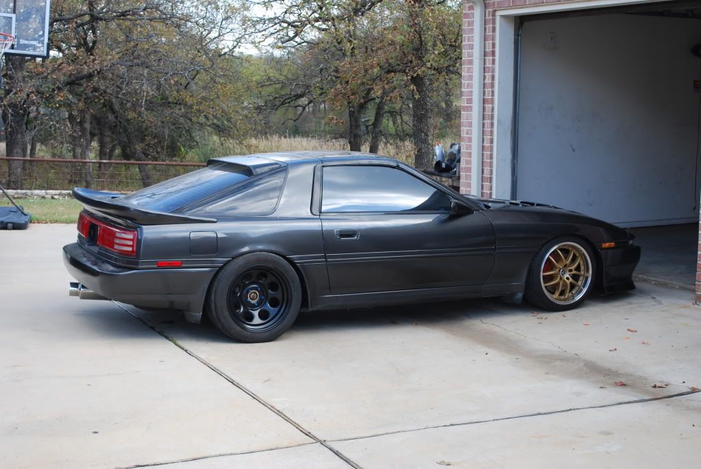

got the wheels and temporary drag tires on.
black rock 17x9 with 5" BS and 275/40/17 Nitto 555R drag radials. need some more fender work, should be borrowing the fender roller this week from a friend.
Hard to tell in the pic, but, how far are they sticking out, or they?
They look pretty nice actually, cost much?
Duane
the actual wheel sticks out about 1/3", but with the tires on it, its closer to 1/2" out, should be able to clear them whenever i have time without major body work.
