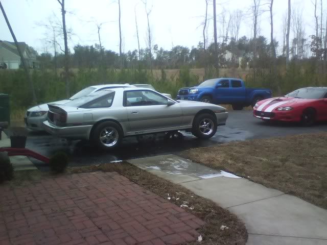

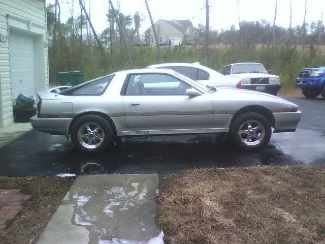

JZ, look at the very first post of the thread and you will see my wheels and tires. They are exactly the size you have posted.

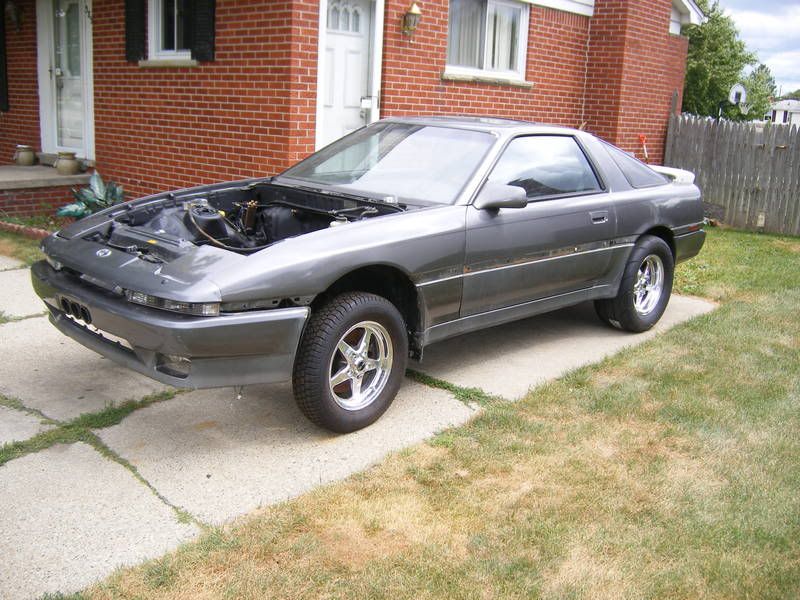

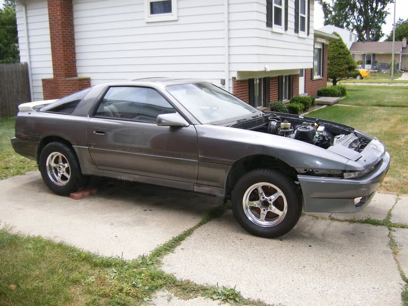

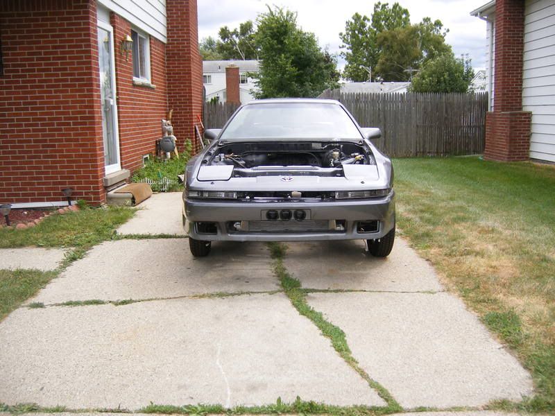

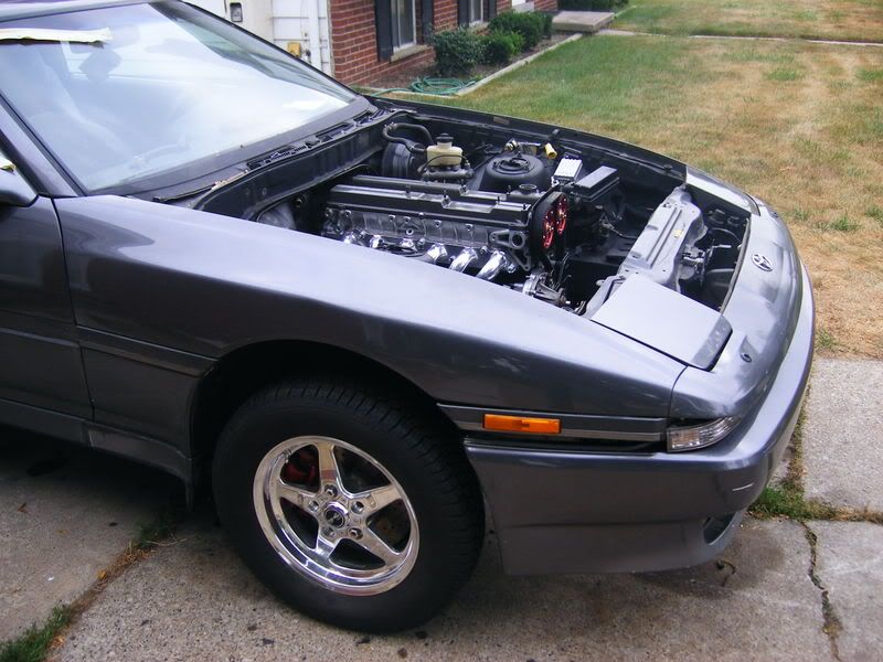

so I can get the idea of how they will look. Soon to get matching backs, Greg Weld 15x8 with 5.5 back spacing with 275/60 MT drag radial. The Greg Welds are uni-lug.
Hey whatsup
I have that set of wheels, and they look bad ass!! i was actually one of the first to buy a full set lol
anyways heads up on your rears, your gonna have to grind down your calipers so they dont rub on the inside of your wheels!!
I wish someone would of told me that before i bought mine lol.
anyways here are mines and good luck!
btw, frontier those are bad ass :)
-Saif
