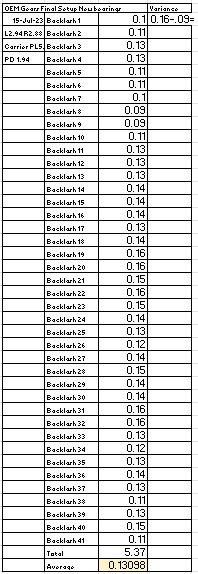

Update, after roughly 700 km with no improvement and a lot of metal in the oil, I pulled the diff apart and decide to rebuild with new gears.
My new gears are coming tomorrow. I pulled the diff off the car on Saturday the 8th of July.
I removed the ring gear and did a runout check on the carrier. Indeed there is a 0.07mm runout.
I labeled the high spot and the lowest spot is 0.
I have arranged for my machinist to cut from the high spot ,inwards by 0.1mm up to the radius.
After this there will be 0 runout, and a consistent backlash

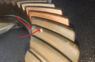

I didnt mean to post anything till I get my gear pattern, but something came up..as always. I received my gears today, and to my horror, there are two chipped areas on the pinion tooth. However I think this wont affect the pinions function or cause noise, notice the red lines i drew, they are the borders of the lapping area on the pinion.
Since they are outside of the lapping area, this chips shouldnt cause any noise. Correct me if I am wrong.
Here is a close up of one of the chips.
I set the preload, and after the 3rd try got 14inlb breakaway and 7inlb rolling.
The ring gear also has chipped tooth.
These are very light chipping
Coast pattern can be seen here
Drive pattern
I will dremel the chipped edges on the pinion and ring gear, but the chips on the tooth face on ring gear I will lightly sand.

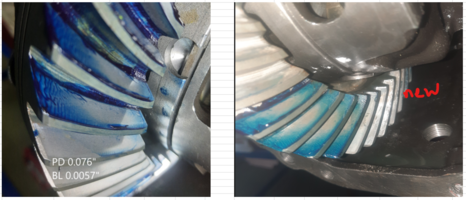

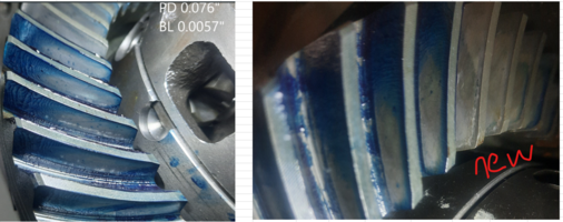

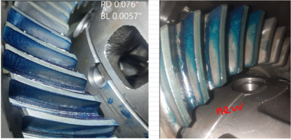

I just checked the runout, it seems its still there, I think maybe the casing is the problem. Anyway. I got a backlash reading
I then checked gear pattern. Left pic is previous pattern, right side new gears, both are with 1.94mm shim
Close up of new drive pattern
Coast comparison. left previous, right new
Not too sure if this is ok, but it seems like its a tad deeper on coast than previously.maybe I am wrong should I reduce shim to 1.90mm and try ?
Reverse painted drive side below
It does seem ok to me.

I pulled the pinion shim of 1.94mm and changed to 1.90mm. It looks better to me especially on the coast.
The drive looks almost the same,.
On the coast its a bit more spread out
Pinion at 1.90mm
I am leaning towards 1.90mm pinion shim.

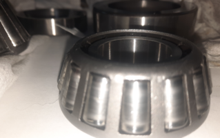

One additional problem appeared. It seems I probably damaged the new carrier bearings. They are making a ticking sound. I will remove the carrier and confirm that the sound is from carrier bearings. Worst case I will re use the old carrier bearings, I will confirm the old ones dont make this ticking noise first.
Sunday Edit..the noise is pinion bearings not carrier bearings, the carrier bearings are silent.
I am not sure why the pinion bearings are making the cage noise, because the shells look ok. I got a good setting now just thinking on what to do with the pinion bearing noise. Maybe it would quiet up bathed in oil ?
Here is the video of pinion bearing noise.
I will investigate the sound tomorrow. This is the main thing keeping me from finishing this.
Edit 17th July . Replaced bearings with newer ones, very carefully transported (in a bag full of clothes) carefully and gently installed, pinion bearing ticking no longer there. Now the preload is a tad too high at 18inlb breakaway. Will adjust to 13 or 12 inlb breakaway, then decide on backlash.
